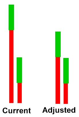

  3. Hi Finnerz. Not proposing to cut down the main pipe to the same level as the reserve, just enough so that the bottom of the main pipe filter is level with the top of the reserve pipe filter, i.e. still staggered. My previous explanation wasn't the best!
  4. I've just stripped and cleaned my petrol tap, and replaced the gaskets. The main fuel pipe up into the tank is very long reaching possibly halfway up the tank. It occurs to me that when I'm just below half a tank fuel wouldn't be 'going down the tube' so to speak. I've had instances of engine fade before now and swapped to reserve which cures the problem (it would appear). Should I cut it down so the bottom is level with the top of the reserve pipe? The bike is a Yamaha Dragstar 125 xvs.

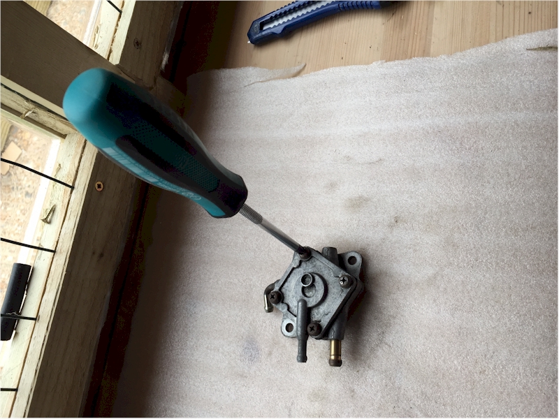

  9. Just cleaning out the fuel pump and discovered just how well these screwdrivers fit. Bet a Philips driver couldn't do this.
