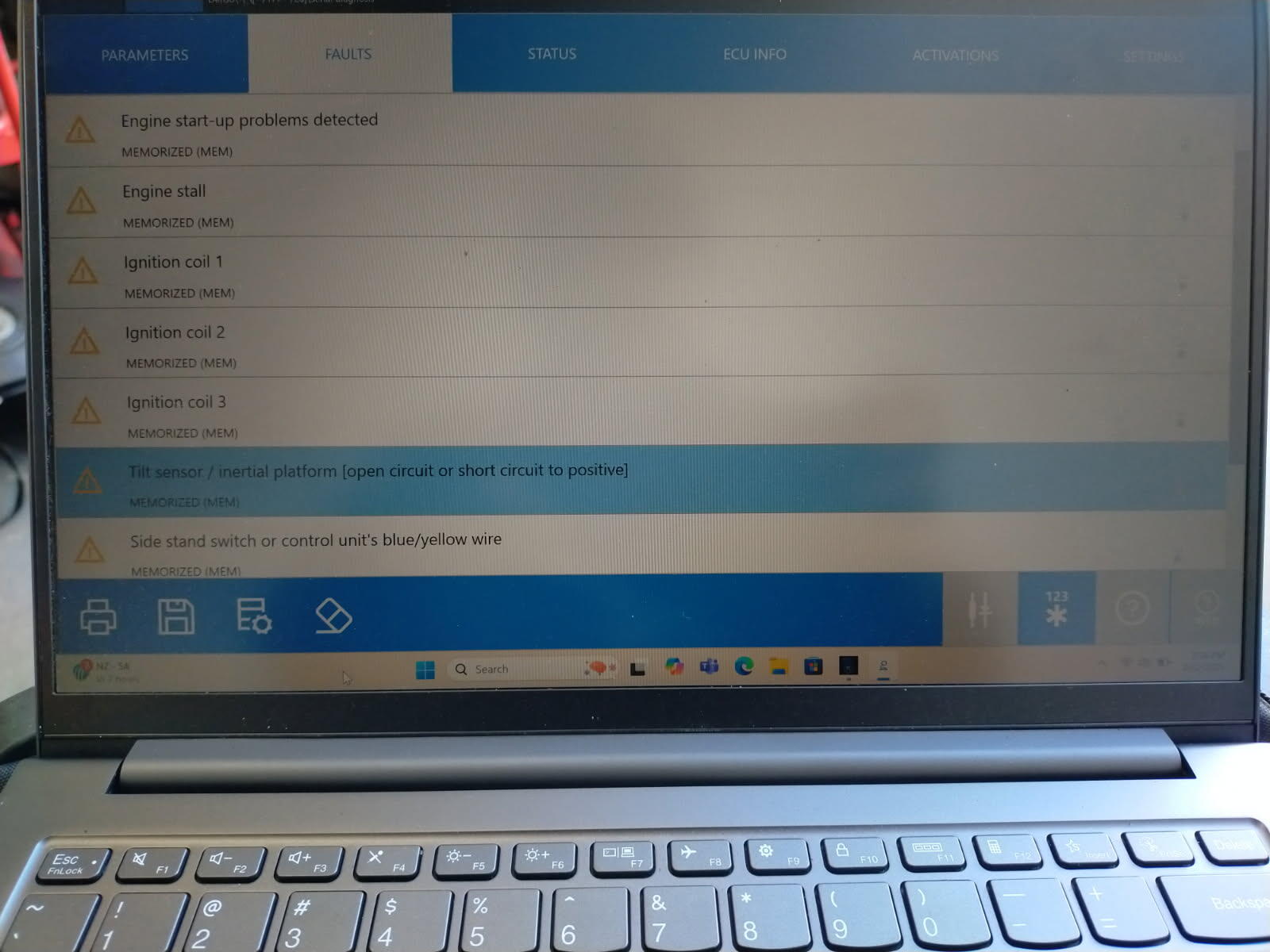

Well bike is all back and working normally. Sorry haven't had time to come back and update. The MT does not have reinforced hoses from the water pump, so it turned out to be normal behavior and it was nothing to worry about. Guess this is an issue when you take your bike to a non yamaha garage. I've since read online of people fitting aftermarket anti collapse hoses. But from playing further it doesn't collapse enough at low temperature to cause an issue, and once at temperature and the thermostat is open there isn't an issue. Strange that they'd save a few $ and not have anti collapse hose. As for the problem they have no idea, the ECU showed ignition coil issues and it stalling. They reset the ECU and it was fine. No idea what caused the issue or in fact what it was. Had to change out the plugs as one had failed, over heated in dry engine trying to start it so much. Next job I keep putting off is a whining bearing noise which has been getting worse over the last few months. I'm hoping it's just the rear wheel bearing and not the output shaft. Guess that one will be a massive job if so. The tilt sensor was from an accident I had last year. Surprised Yamaha didn't clear this when it was being repaired.

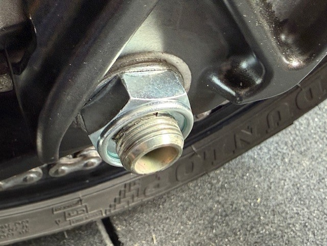

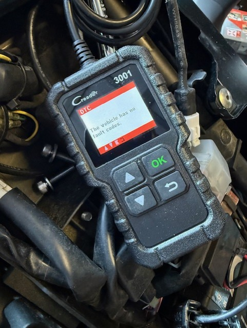

Well, it all went downhill after changing the axle. Went to start the bike up afterwards, turned over fine, but wouldn’t fire. Cranked plenty, but just no start. I had a feeling it might’ve had some water ingress, as I’d washed it before working on the axle. Pulled the tank and airbox off, everything looked bone dry. Took the coils off just in case, also completely dry. Put it all back together and tried a few wide-open throttle starts to clear any flooding. Waited a few minutes and tried again normally... pt pt pt bang stop. It almost started. Hooked up the OBD reader, no stored fault codes. Then, suddenly: click click click. Wouldn’t even try to crank. Thought maybe the battery was on its way out, so I charged it for a couple of hours, full charge. Still just click click click. Figured maybe the starter fuse had blown. At that point I gave up and booked it in with the local bike shop. Garage called later. They wanted to know a bit more history, said they weren’t 100% sure what happened, but they got it started using an external battery. No idea why it wouldn't start with me. But then they asked me something worrying: “Has it been overheating?” Not that I know of. Then again, I only ride it 30–40 minutes at a time commuting, so if it had a slow overheating issue, maybe I never noticed. They told me the coolant hoses were collapsing, and that with the radiator cap off, coolant shoots out when you rev it. They compression-tested all three cylinders, all came back fine. So now I'm hoping it's just the head gasket, and not a warped head or cracked block. It's only done 23,000 km, so hoping it’s repairable. A sad weekend for sure. Down 2hrs diagnostics so far.
