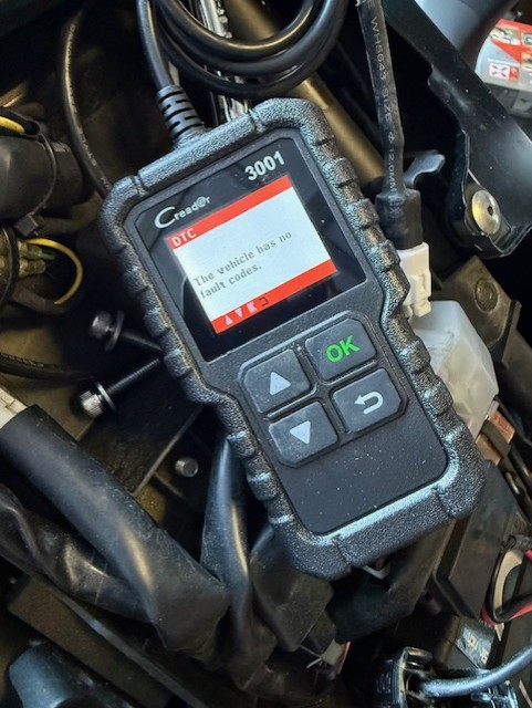

  17. Well, it all went downhill after changing the axle. Went to start the bike up afterwards, turned over fine, but wouldn’t fire. Cranked plenty, but just no start. I had a feeling it might’ve had some water ingress, as I’d washed it before working on the axle. Pulled the tank and airbox off, everything looked bone dry. Took the coils off just in case, also completely dry. Put it all back together and tried a few wide-open throttle starts to clear any flooding. Waited a few minutes and tried again normally... pt pt pt bang stop. It almost started. Hooked up the OBD reader, no stored fault codes. Then, suddenly: click click click. Wouldn’t even try to crank. Thought maybe the battery was on its way out, so I charged it for a couple of hours, full charge. Still just click click click. Figured maybe the starter fuse had blown. At that point I gave up and booked it in with the local bike shop. Garage called later. They wanted to know a bit more history, said they weren’t 100% sure what happened, but they got it started using an external battery. No idea why it wouldn't start with me. But then they asked me something worrying: “Has it been overheating?” Not that I know of. Then again, I only ride it 30–40 minutes at a time commuting, so if it had a slow overheating issue, maybe I never noticed. They told me the coolant hoses were collapsing, and that with the radiator cap off, coolant shoots out when you rev it. They compression-tested all three cylinders, all came back fine. So now I'm hoping it's just the head gasket, and not a warped head or cracked block. It's only done 23,000 km, so hoping it’s repairable. A sad weekend for sure. Down 2hrs diagnostics so far.
