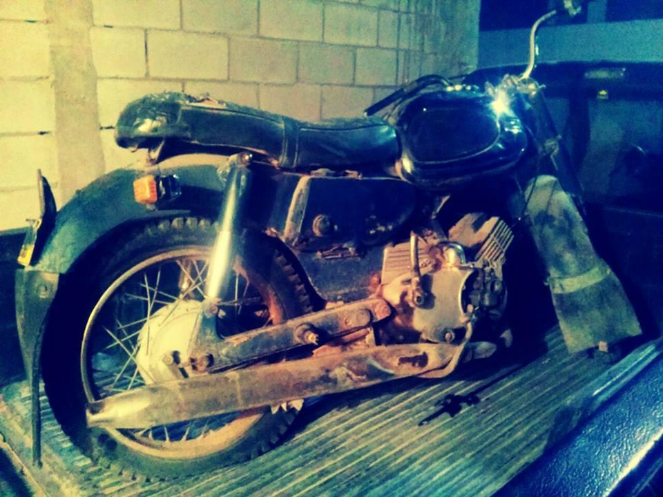

    Hi I am from Mexico , Torreon Coahuila and have just one YA 6 of 73 newly bought yesterday . I know we will have some language barriers , but I would like you to comment a little more about how it wor
