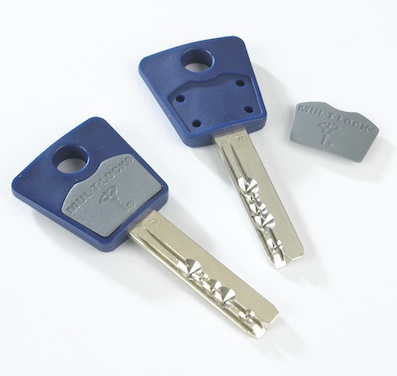

First thing to do is look at the key and the keyway.
As an amateur lockpicker (with a lot of fancy lockpicking tools), there are two types I would recommend:
Abloy style Cam Lock:
Dimple or Mul-T-Lock style:
Both the above are almost impossible to break with conventional tools (unless you want to destroy the brake disc) and are F**KING hard to pick even with the right tools. No thief will bother messing with these!
If the key is one of the tubular ones or looks anything like your normal front door key, forget it. I can rake most of those open within 20 seconds, or bump them in less than 3!!
Second - Look for a lock one where the shackle is shrouded as much as possible - Makes it awkward to get a decent cutter in and impossible to use bolt cutters, etc.
Don't get the ones that are padlock-shaped - An angle grinder will make very short work of most of them.
