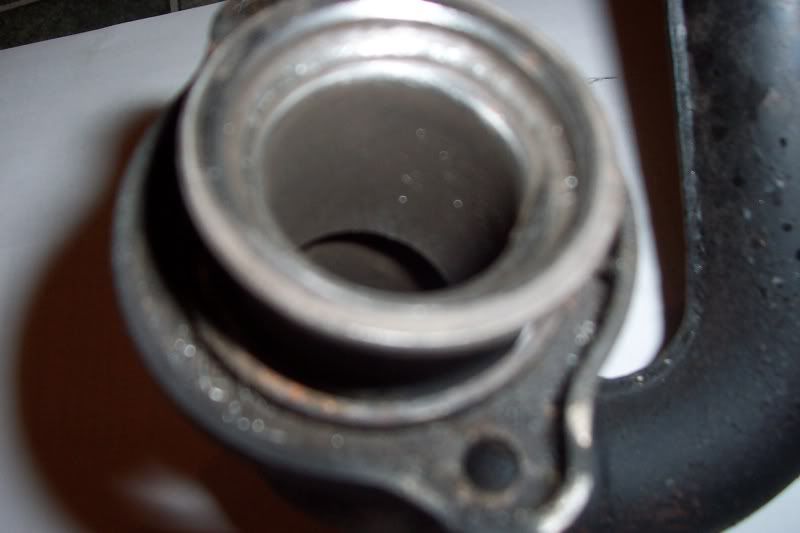

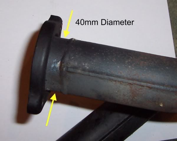

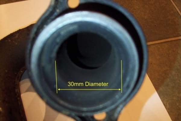

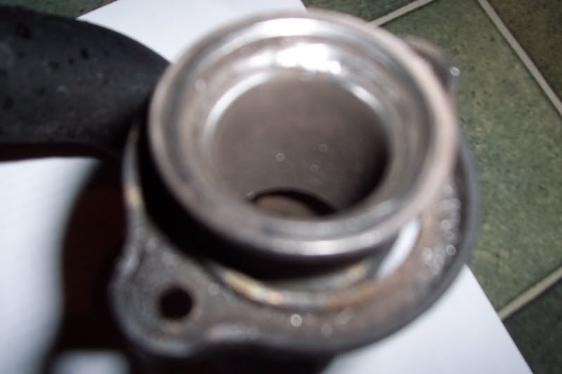

December 30, 200916 yr Moderator Recently took off the top end from my bike, had a look into the exhaust header and found a subtle restriction lurking in there. Cant understand why Yamaha would have done this unless it was for a foreign market for some reason. This flies in the face of any good tuning practice as it will give rotten gas flow characteristics. ....Now...wheres my hole saws? Any how heres some pics

December 30, 200916 yr Author Moderator Oh no master, mine be Gianelli, the once pipe of choice for the disscerning 80's headcase. I had a Gianelli once but i used my bike a lot back then and didnt regularly paint it, so like all the others it ended up rotten, you just dont see them any longer, even on ebay, last one i saw on ebay had been powder coated...as the Americans might say...go figure! You say your Gianelli has a pipe in a pipe, but my stock one has a big air gap between the two like this
December 31, 200916 yr Moderator I had a Gianelli once but i used my bike a lot back then and didnt regularly paint it, so like all the others it ended up rotten, you just dont see them any longer, even on ebay, last one i saw on ebay had been powder coated...as the Americans might say...go figure! You say your Gianelli has a pipe in a pipe, but my stock one has a big air gap between the two like this Thats it, couldn't have drawn it better myself. I'll measure it properly tommorow, it was a quicky with a tape measure earlier. As to powder coating an exhaust, only in America. Although how many bikes have been lost to the monsters that never use them except to put on a trailer for a show. I'll admit i dont take the TDR out at this time of year but if the DT was running it would be up and about. I've been wet and cold often enough to know how stupid it is to walk past a perfectly good car when the floor is so slick you can hardly stand though. Seeing as i've started waffling i'll continue, i have orderd all the components i need to build a new loom FROM SCRATCH for £26. Can't go wrong really. When i stripped mine out it had 2 broken wires and some of the internal loom conections were loose. Pluss a lot of the wire especially over the engine has gone hard.

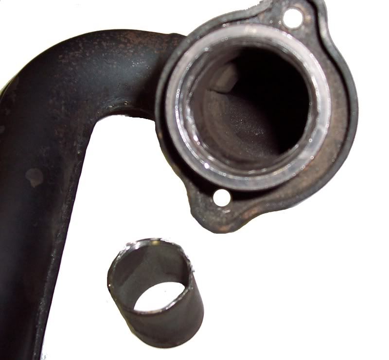

January 14, 201016 yr Moderator Paul Mick Abbey has replied to your post about this on the RD forum, in his opinion you will not make a huge difference removing it Hi Paul The only way to take it out would be to grind it out around the weld as for performance I am not sure if you will notice any diferance it may give you a bit more top end power at the same time taking a small amount of lower end torqe, this is the same thing as why on most road engines the ex port outlet diam is smaller than the diam of the start of the header pipe it all helps with low to mid range torqe I hope that this has answerd your question Cheers
January 14, 201016 yr Author Moderator Paul Mick Abbey has replied to your post about this on the RD forum, in his opinion you will not make a huge difference removing it yes i saw his reply Merv, still going to remove it though, it's part of other changes i'm doing not just something in isolation and i just have a hunch that removing it will help. Other mods are carburation, airbox and reeds. These bikes are in a pretty low state of tune as standard especially the early ones like mine I've had the bike for 27 years now so its long overdue some tinkering ( i know you'll understand )
February 5, 201015 yr Author Moderator Well it's out now Restrictor diameter = 29mm, Header diameter = 35mm This is now a 45% bigger area than when the restrictor was fitted.
