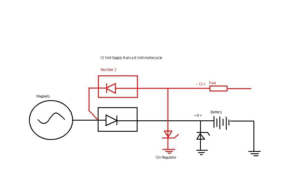

You need a seperate circuit as your battery is held at 6V, I dont know if this could be done and the drawing has turned out crap, but if you have an understanding of electrical engineering, my thoughts are this, obviously it will only work when the output from the magneto is above 12v
but thats the thing, the mag is 6v and so is the battery, but would it be possible to step it up to 2v at the expense of reducing the amperage output?

The mag will give out more than 6v as the revs increase, for example the mag on a 12v bike will give 50v at high revs...its the regulator that holds these voltages down, i dont know what the mag on the 6v bike will give, neither do i know of anyone doing this, or indeed if it would work, but that'd be the way i would try.
okay, how about running a 6v regulator on parallel from the mag and then using that stable 6v voltage to get up to 12v?

This is my latest offering, it uses the negative half cycles from the magneto, i dont think the first attempt would work, with this one you wouvd connect the positive centre pin to bike chassis and the socket outer to -12v fuse, i am not an electronics expert so any comments will be welcome
Honestly i think this is a bad move, i dont know if you have a lighting /charging coil or separates but they will have very little to spare and electrical loads will rob you of the HP you have got from your sports bits and bobs. Do you really want to blow out your stator coils somewhere in nowhere.
