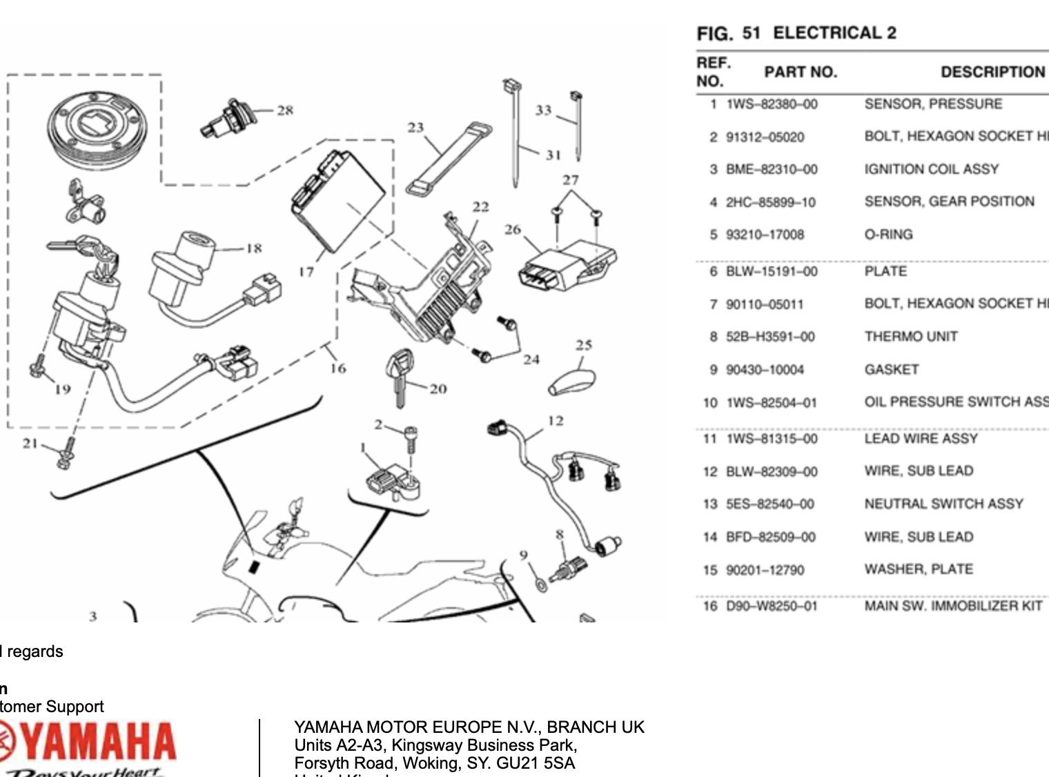

  1. Afternoon - the BIG problem with this component is that is an all-in-one ignition/hiss/steering lock unit. Any replacement necessarily requires new keys/coding which is the reason, apparently, that you have to buy it as a kit, which includes the new ECU. Which is item 16 on the screenshot. I don't want to go through insurance, the excess is pricey, my 11 years NCB is not protected and it pisses me off for Yamaha to get more money for a crap part. I am making a claim against Yamaha under the Consumer Rights Act 2015, given that the component, IMO, is not of 'satisfactory quality' - ie is not fit for purpose, is not durable and is RIDICULOUSLY expensive to rectify in comparison to the total cost of the bike. To be fair I'm not really expecting much joy put it pisses me off that their response from 'customer service' was for me to claim on my insurance. I've put the bike back together so will be back on it tomorrow. Just out of interest I may give Padgetts a call just to see what they say, on your recommendation. Thanks for the tip re the insurance wording - will check!
  2. So - GT Motorcycles have said the replacement kit from Yamaha is £1250 - this must be paid for UP FRONT and there is a 6-8 week delay in supply. Then there are labour costs to install the new bits, and I will be left with a key for ignition, and original keys for seat, tank and luggage. Not impressed

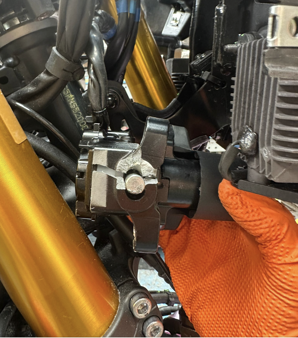

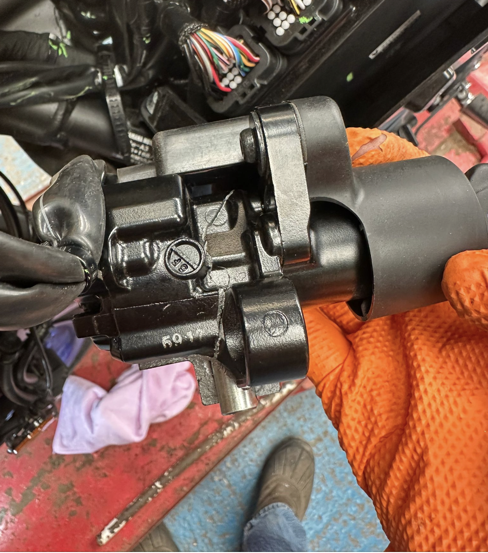

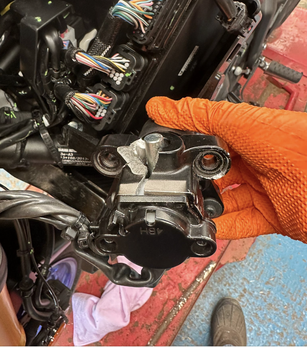

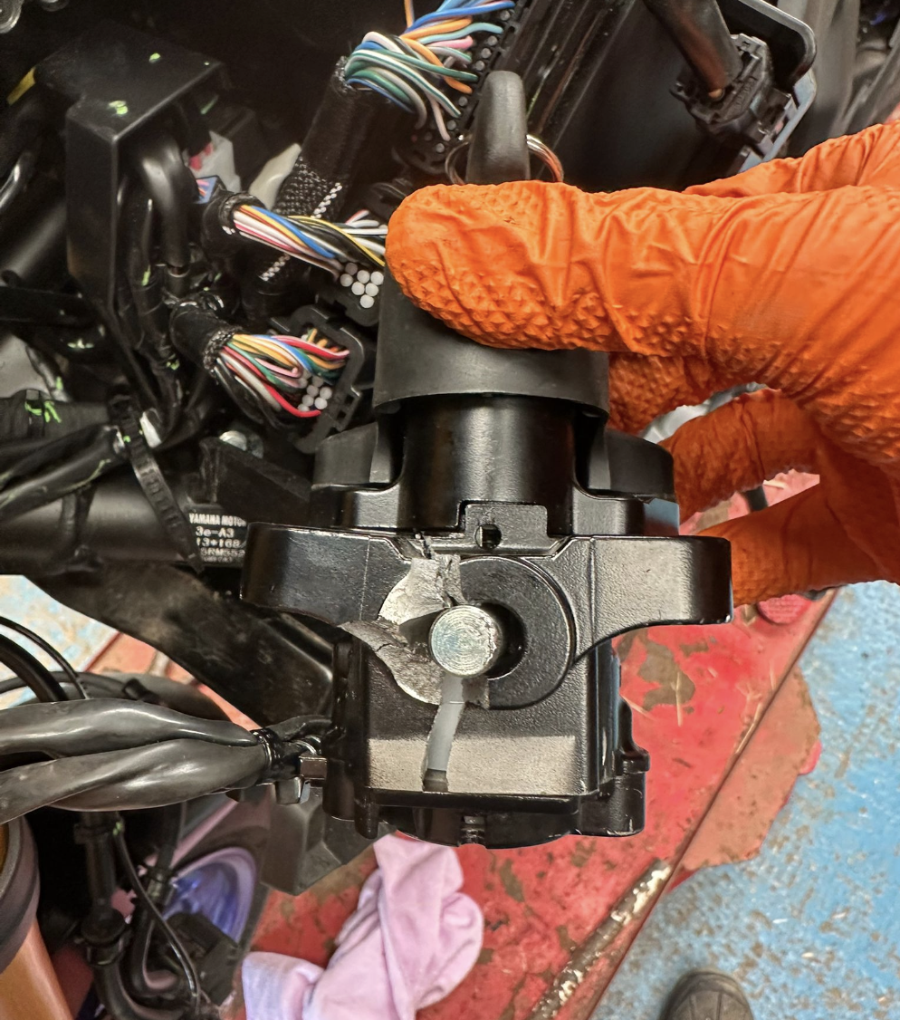

  3. Hi Snakebite - spoke to GT Motorcycles Parts/Services today, not exactly an edifying conversation. Apparently Yamaha determines what parts can be supplied for repairs. In this case it is going to be the complete immobiliser/ignition/steering lock assembly PLUS new ECU etc so I will end up with mismatched keys for the seat/panniers/fuel cap. The service manager was not particularly interested in looking at the idea of transferring the existing electronics from the knackered part onto a new barrel etc. It's not really a case of being able to do the work ourselves (which we could/can) because of the 'remapping' element for the electronics that is involved. We've stripped the bike ourselves to remove the component from the bracket (it is still attached electronically). Bike starts. TBH I'm just tempted to waterproof the whole thing and put it back on. I'm NEVER going to use a steering lock again and I'm pretty pissed that Yamaha basically wants me to handover 15% cost of the new bike (plus god knows what for 'installation & recoding') for a part that shattered so easily.
  4. Fowlers in Bristol never bothered to respond to email/contact form or ring back. GT Motorcycles - where I bought the bike - have been neutral. Salesman: 'Well it won't be a warranty as it's been interfered with'. 'Speak to the parts department, I can't do anything about parts/replacements but I'll keep an eye on what goes on'. I asked salesman to get the parts department to get back to me with the relevant part number - nothing. Now that I have the part off the bike I'll be ringing the parts department directly to see what can be done. Having taken the fairing etc off to get to the offending article I have been astonished at the damage to the unit. See photos. Bearing in mind that the only thing I noticed when I went to get the bike after it was parked up was the steering lock was difficult to disengage - I am amazed that the unit was completely fractured. If the unit can be so easily dmagaed then I can't see how it is 'Fit for Purpose'. The electronics all work, I rode the bike back 200miles without an issue. From my own investigations the switch/steering lock unit comes as part of a kit that includes all the ECU gubbins and costs in the region of €1500, installation extra.... Thanks for the nod to Padgetts Motorcycles - will bear them in mind. BTW - my take home tip, NEVER engage the steering lock!
