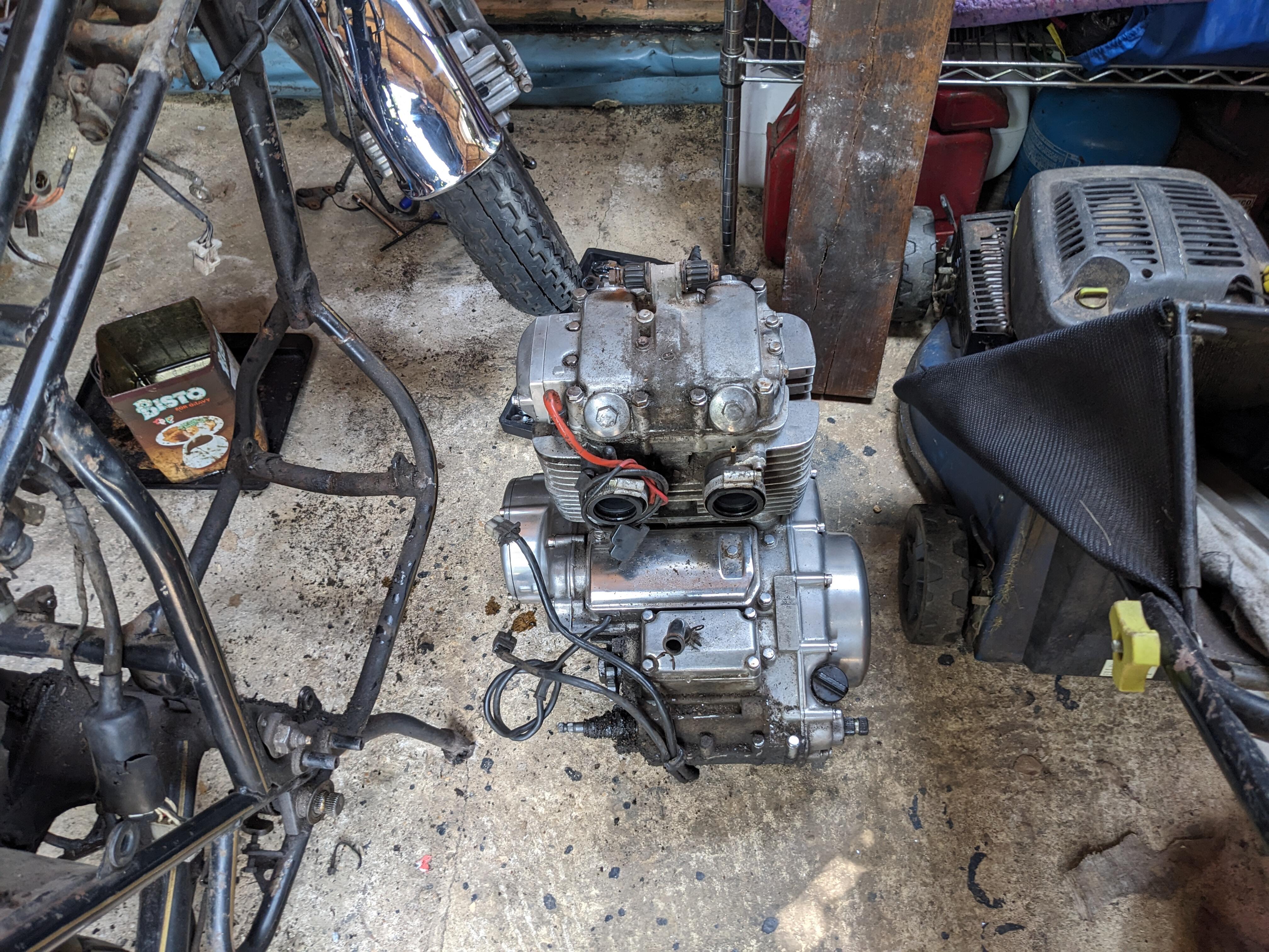

  2. Stripped the engine out of the bike and put the rest in my new shed. Then I took the engine apart. Judging by all the oil hanging about on the non working side, I think it needs new gaskets and piston rings.
  3. Well it looks like the engine has to come out again and have the head off. Only runs on one cylinder, got spark, got fuel, won't run on the left side. Vlaves are not stuck, so engine out, head off and we need to have a look inside. never mind.

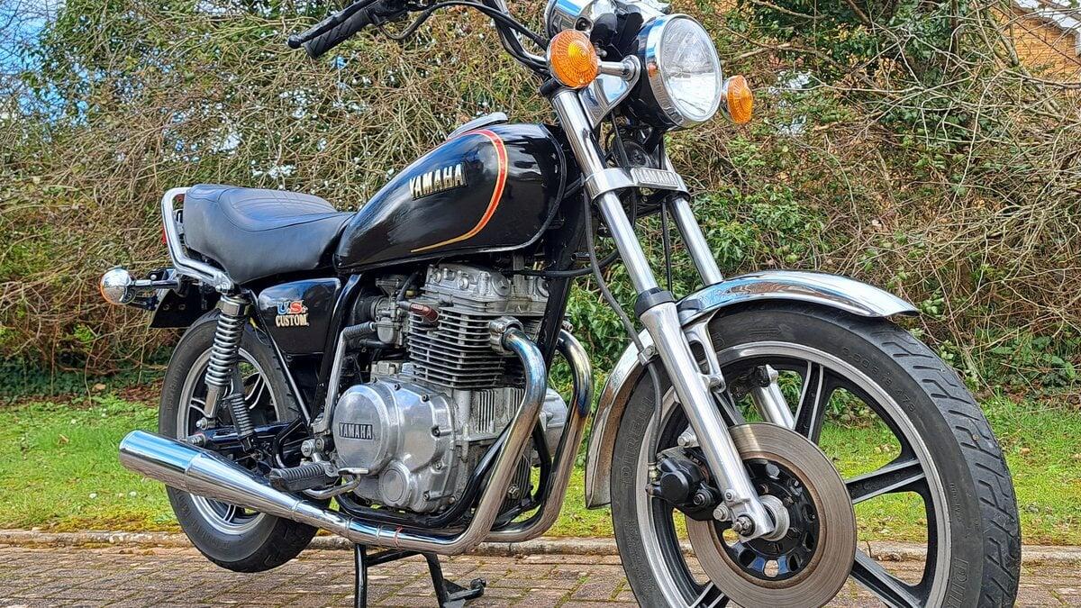

  4. This is what it would have looked like originaly. So the seat,sissy bar, front mudguard and exhausts have been changed.

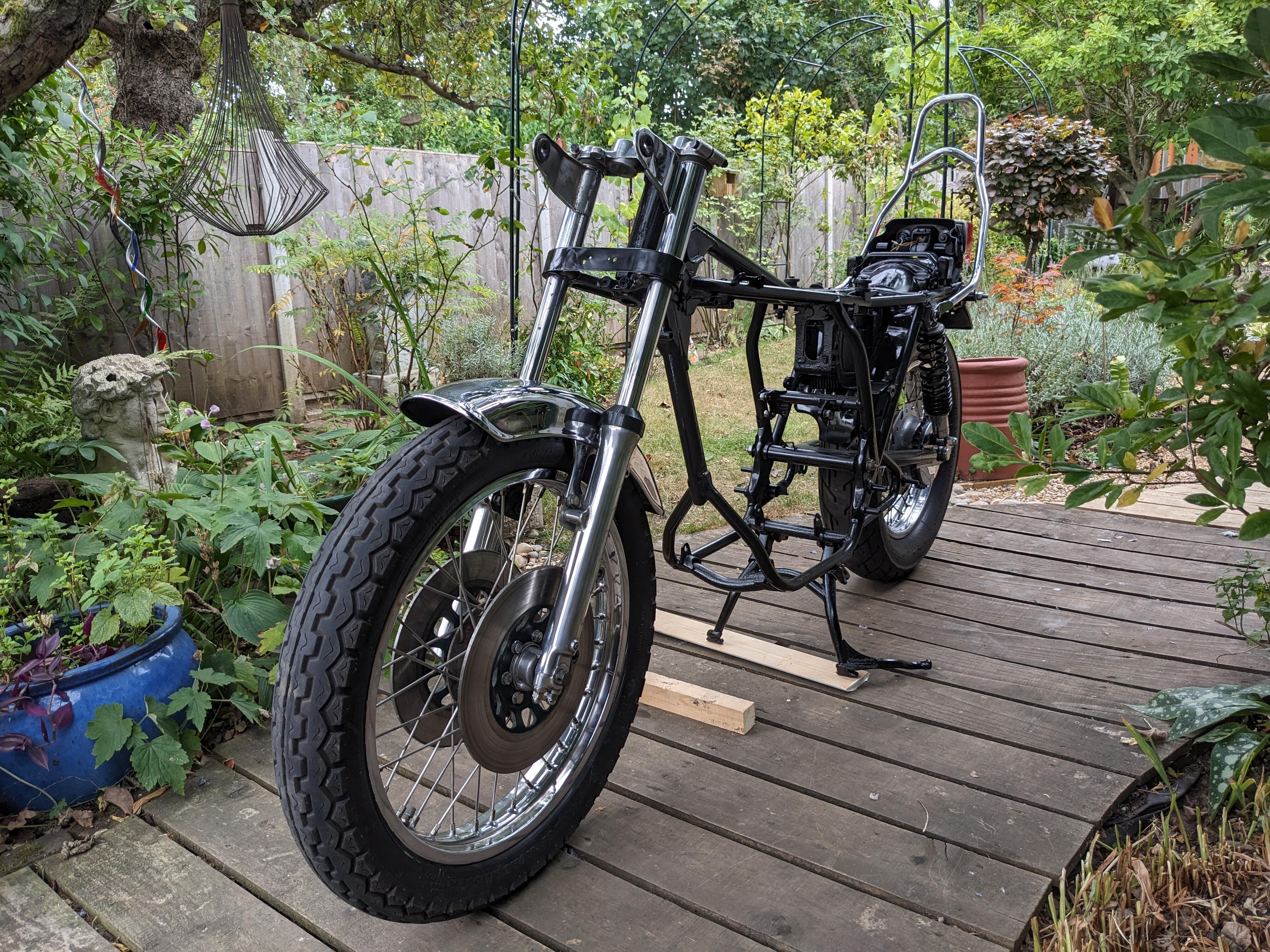

  15. Wheels cleaned and fitted. Center stand does not seem big enough to hold the bike properly, will fudge it for now with a bit of wood. I expect once the bike is done I will just stick with the side stand and take it off.

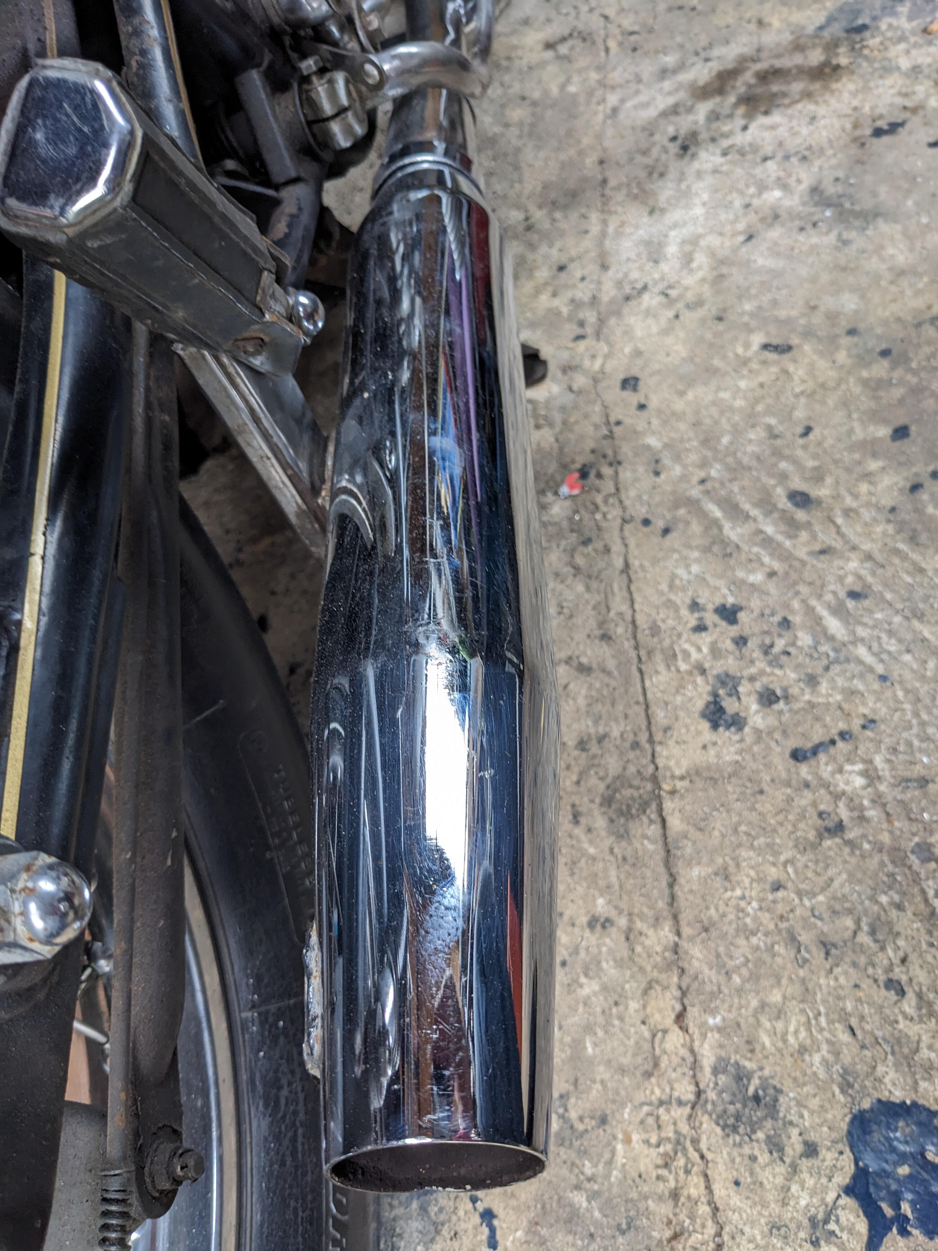

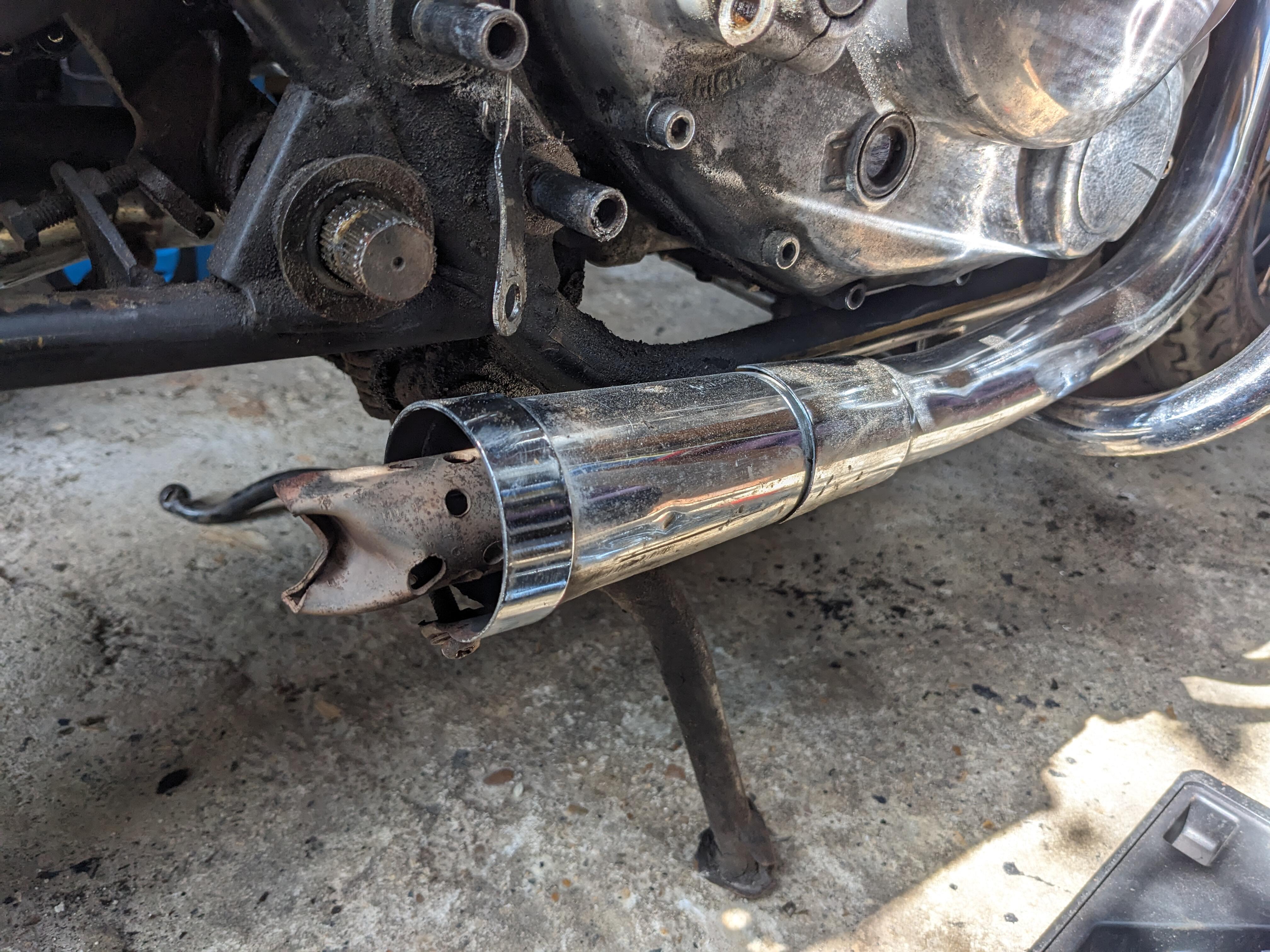

  20. I ended up using a mixture of petrol/gunk and a stiff brush. Then I pressure washed the whole lot off, then cleaned the fence afterwards. ;) Some rust and a couple of small holes to weld up. Tony.

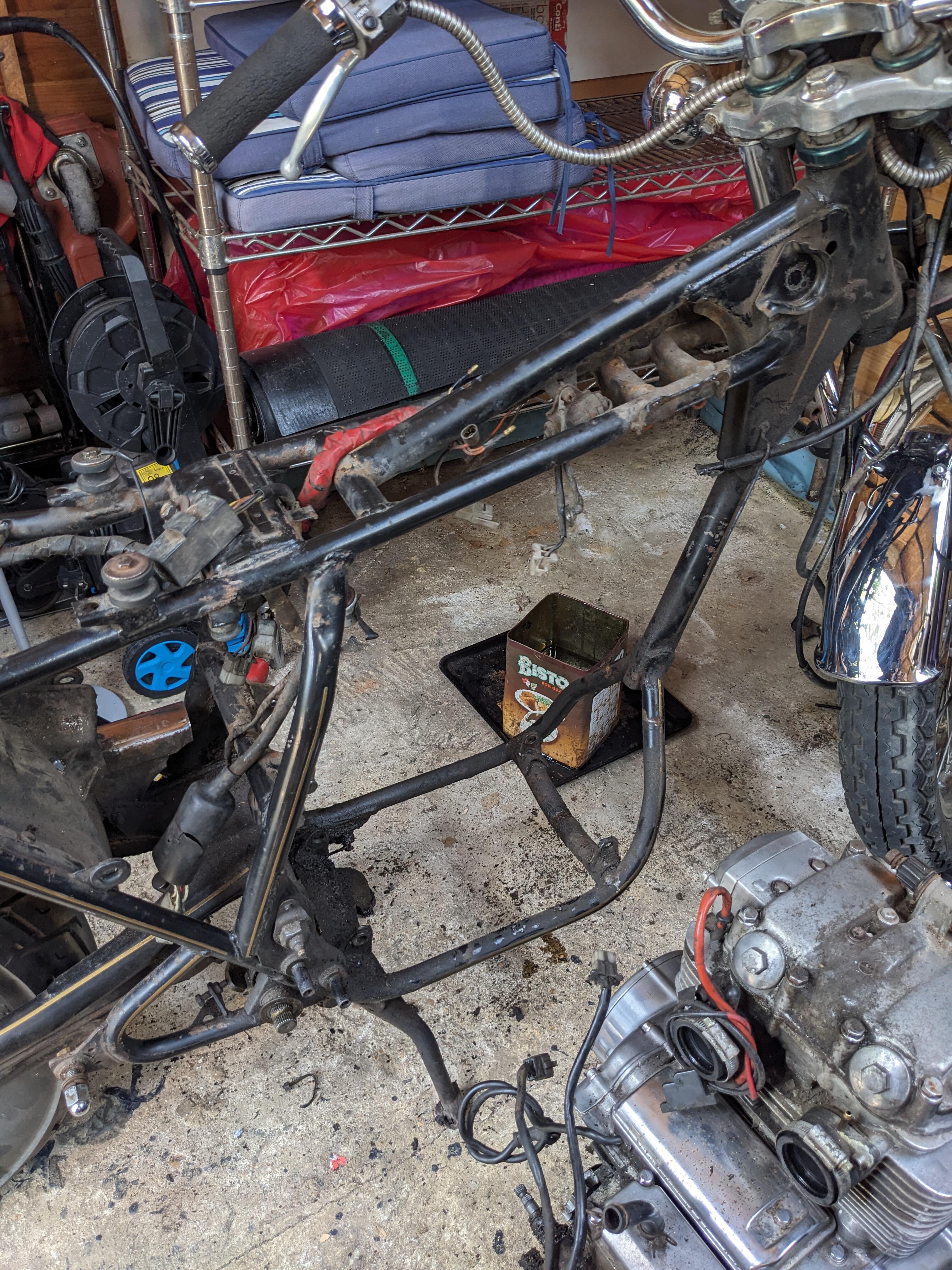

  22. Todays little jobs. Started stripping aall the rear mudguard off. Then took off the rear shocks, chainguard and took out the rear wheel. If I get a chance tomorrow, the front end will be coming off. Tony
