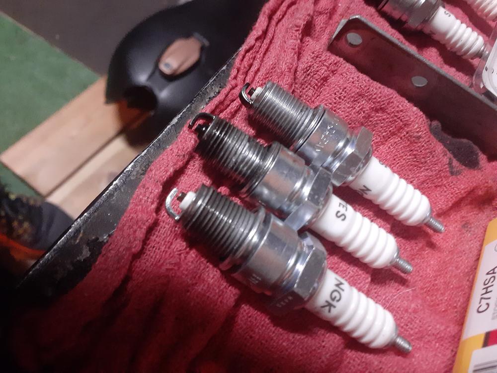

Took my carbs off today and did a bench sync. Like I said first rebuild...got caught up in all of the other work I was doing that I completley overlooked a simple step. I've bench synched em now and im grabbing some new sparks so I can read the current situation. but hopefully that gives a much better outcome. Will replace prior video with new if good outcome.

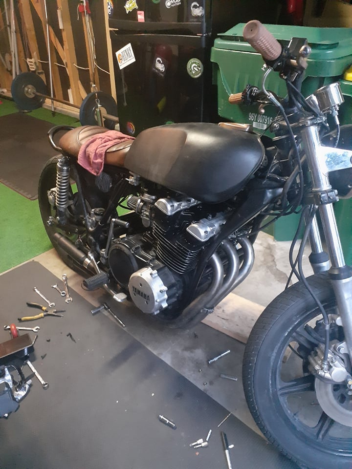

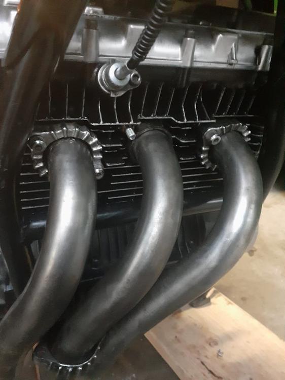

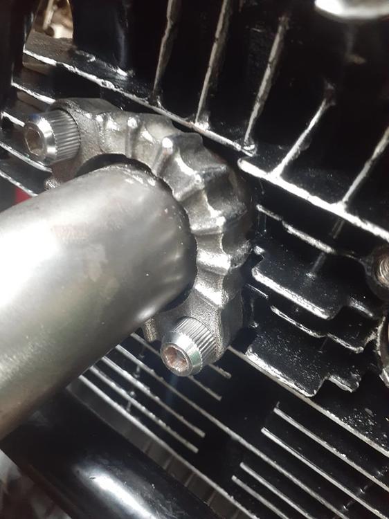

Hi guys! So I posted recently through my top end rebuild and I'm damn near done. I've run into some snags though and could use some help. I called all of my local shops, repair shops, muffler shops, restoration shops, and even some friends but I'm on my own. Shop were all full or not in "Vintage Season"... Anyways, let me start by listing what I have done and then where I need help! Thanks in advance!**In all steps, I'm using my Clymer manual as my guidance.Completed:-Pulled Carbs and disassembled.-Chem dipped jets, bowls (note: passages are in the bottom of the bowl as well as jets.), and just got a good cleaning through the carbs. (3 mikunis)-Replaced air/fuel mixture screw x3 (PO tightened up and bent the tips.)-Replace needle jet and retainer in middle carb as it was different than the other two and the plastic retainer was broken. (Odd contraption)-Reassembled carbs and replaced the "manifold boots"? that connect it to engine. Added inline fuel filter so as to be able to easily see fuel quality. (Note has a relatively high capacity in filter and installed correctly. Not thinking it has any impacting effect on any relative issue.)-Measured pistons and cylinders (all in spec and intact)-Replaced all Piston Rings (no gaps lined up all to spec)-De-glazed/honed cylinder walls.-Oiled rings.-Oil rinse pan.-Put cylinder back over pistons with new gasket.-Cleaned the area underneath where the seat of the valves are.-Replaced Intake shims to fit spec (Exhaust shims were still within spec) (Likely PO work, as this was as far as anybody had been into this bike as I could tell when disassembling.)-Put Cylinder head back on with new gasket.-Tightend cylinder head bolts to spec. 25 up top 14 on the two below.-Helicoiled center spark plug hole (PO cross threaded)-Reinstalled cams with lube in requested areas. (No marks were as described in any manual as far as placing them back in a certain way, there was a dot of red/orange paint on the cog of each as well, however, pretty sure I've got em in right, shim clearances are all within spec now.)-Re installed new master link.-Remasterlinked the cam chain.-New gasket on cylinder head and fastend down cylinder head cover.-Replaced exhaust studs and nuts. Honestly question that system of studs flanges nuts and retainers and how they efficiently do their job...but it was 77..we've come a long ways.-Reinstalled exhaust.-Clamped one loose muffler to the exhaust pipe. (PO had it hanging slipped on). Improved running sound.-No fire/fuel button turn over x3-5 times to shift some oil around.-Full crank.Outcome:Ran better than before for a bit. Had a little white smoke off the rip that settled. Idled at about 1100-1200 rpm. Died out after a minute. Fastend all 3 air/fuel mixture screws and then backed em up 2.5 turns as manual said. Cranked and idled low. Slightly tightend idle adjustment screw. String of bad cranks. Popping while running. Loosened #1 air/fuel mixture screw 1/4 turn. Crank and runs just right. After a minute dies out. Notice 3 slightly watery oil drips from front left of engine and stop.Now here's where I need help.-Oil leak. At front left jug/head area...will include picture.-Carb adjustment syncing? (Never done it) Ordered the tool I'd need to go through that process but any tips would be good.-Outside of that any tips on the tuning of the carbs? I find that with how it's set now it'll run for a bit then slowly die out. Also if I throttle to a certain point there's no reaction to engaging the throttle any more past that point.I figured the collective knowlege and experience would give me the boost I need to wrap this project up. I've never worked on an engine. The most extensive work I've done with engines is removing the intake manifold off an 05 titan to replace the starter. I've grown up with vehicles that I've needed to tinker with but usually lighter things like carb work. Any tips help! Appreciate you guys! If a picture is needed for reference just tell me and I'll get it! This was the first crank after everything. My phone doesn't record audio but I got it nonetheless. Doing another crank with laptop video and will post here in a few! video-1624123639.mp4 9CC4BF76-8290-4D9A-ACAC-B1D4BE9F87CF_2_0_a.mov 9CC4BF76-8290-4D9A-ACAC-B1D4BE9F87CF_2_0_a.mov
