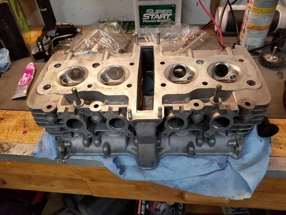

  2. This is before I removed the gaskets and cleaned the exhaust ports. I'll post another pic tonight after the other 4 valves are lapped. I would have preferred to get it walnut media blasted but I'm also on a budget. I have a soda gun but it wastes more than it cleans on stuff with this many pockets and deep grooves. I want to spend as little as possible where I can without sacrificing the longevity and safety. $120 for the cam treating versus $120 for a media blasting, I'll do the cams. :) Yes, it was time consuming to clean the head this way but also satisfying to see it come clean. New exhaust studs, exhaust gaskets and head o-rings are on order. The blasting would have ruined the stem seals as well, but after lapping the first 4 valves only one gave any kind of resistance. So, they're all getting replaced anyway. Better safe than sorry for a cheap rubber part eh?
  3. The used head is almost done with cleaning. The combustion domes and exhaust ports had a good .5mm of solid carbon. Some CRC GDi intake cleaner, a cordless drill and some small wire brushes did the trick. The valves cleaned up just fine and I've just lapped in cyl 1 and 2.

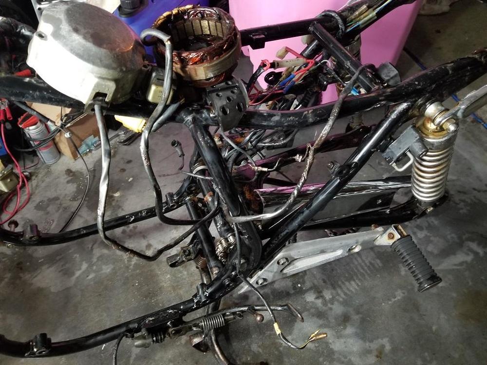

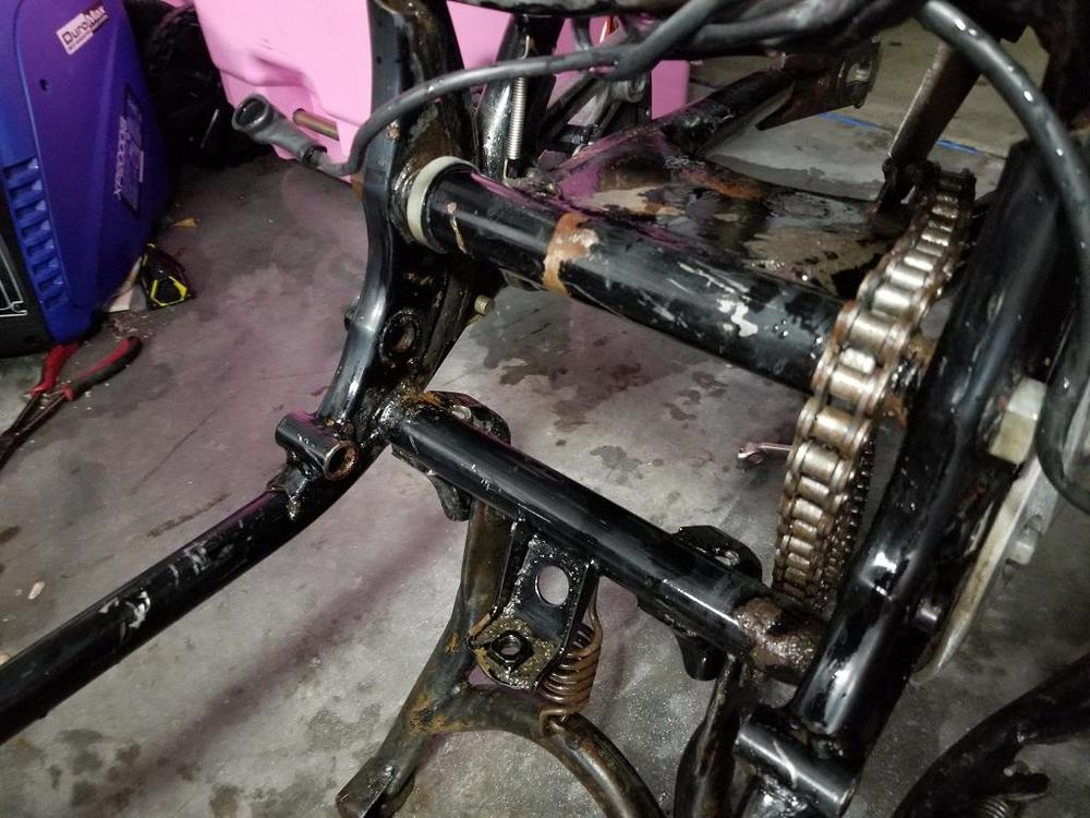

  4. After a LOT of degreaser, a messy driveway cleaning and a few shop rags the chain lube grime goo and road splatter are gone. New chain in-hand. Might try to polish the shock springs once I disassemble the rear sway arm setup. It's all getting sanded, rust treatment and then a coat of gloss black frame paint. I used some of the frame and roll cage paint recently on some auto subframe braces and it survived some "adjustment" hammering surprisingly so it should last a long time on the bike frame. The chrome is in surprisingly good condition. The undersides of the chain guard and rear fender support need some attention while off the bike. The signal stems are also in-hand and waiting for the frame to be painted. Everyone uses black vinyl tape don't they? :D Front and rear wheels look in good shape. Rear needs a bit of brushing and buffing before paint. New sprocket in-hand. Will see how bearings are. They feel fine pushing the bike around but need to make sure they aren't worn too much. Something always refuses to get clean! Well the stem bearing has no cover, so who knows what the races are like. Guess I'll be pulling the head apart. I hope the bearings aren't bad because that's quite a bit of cash. If it's packed full of old gooey grease it should just need a clean and repack, with new covers.

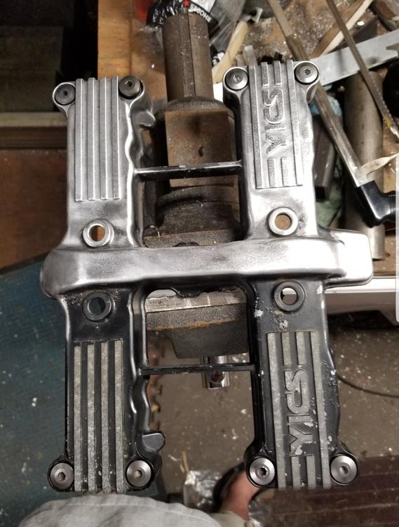

  11. Valve cover and retaining bolt buffing. The buffed cast aluminum is growing on me, but the black paint fill is OEM. Half done, but you get the idea.
