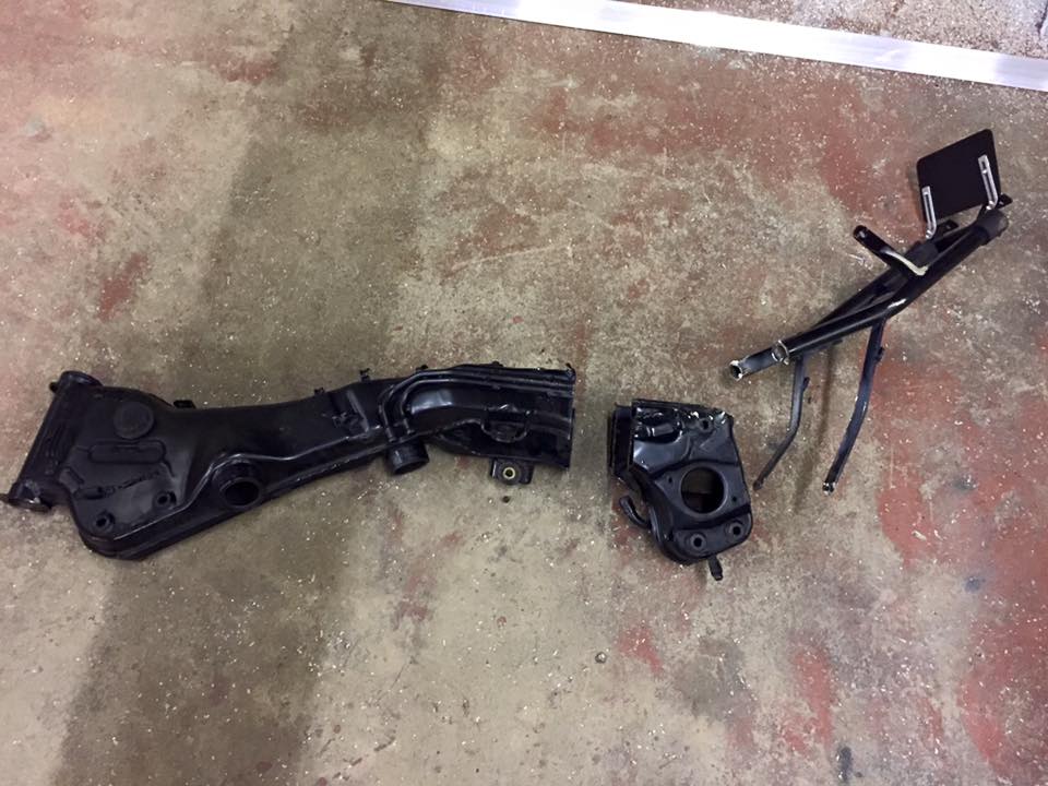

  22. Jack R1 replied to Jack R1's topic in Projects
    Out of the 5 items in the two cut down pics I'm keeping two. Lets play a game lol
  23. Jack R1 replied to Jack R1's topic in Projects
    Well the chassis cutting has started
