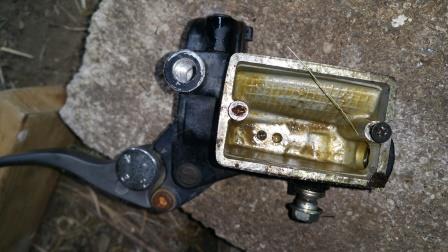

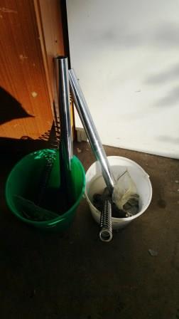

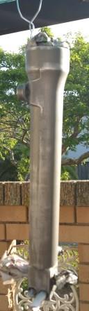

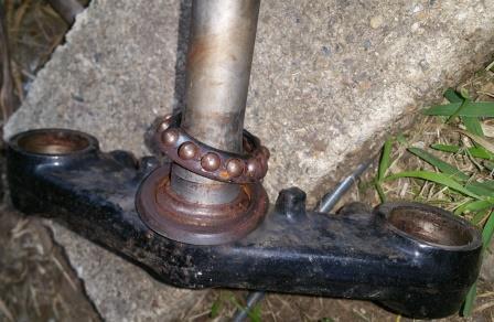

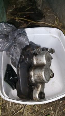

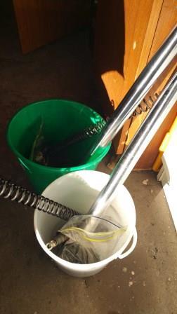

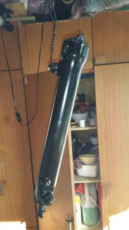

  2. Well The fix up is going slowly, and the more i look at this bike the more i see what is wrong with it. I am glad i never tried to bump start it. Ah Well..... Anyway back to the good part of the bike "Fixing things". 1) As previous posted pulled the forks of and needed the damper rod tool. I followed the instruction from the Hayes manual. I Purchased a length of 5/8th square tube ($6 aud) and a 24mm hex bolt ($2 aud) and inserted it into the tube and got it welded at a local factory (free).. Worked perfectly... I should by a welder to do this myself... Photos to come of the tool Here are the forks stripped and dripping in separate buckets (1 for each side) Decided to at least give the bottom part a clean so sanded them back ready to paint... Sanded Before painting After painting - (looks a lot better) Now Just to clean the tubes of the pitting spot and wait for the arrival of the new Seal,bushes and dust caps to rebuild them.. 2) Next I striped the head-stock to check it out (since the forked where out) to me they look pretty bad. So order a new kit from pyramid parts Australia. 3) While i was there i pulled out the front caliper and M/C. looked like the calipers needs a complete clean and repair and look at the M/C that is muck in the bottom... The Front Caliper The M/C Just by pulling this bike apart i do not think the PO looked after it and basically took advantage of my lack of knowledge.. Once i get this fixed i will be riding by his house.... just to show off!! On a good note got my bike learners to day to now ready to ride... oops need a bike hahaha. I will most likely have my full licence by the time i finish this bike rebuild. That's it for now.

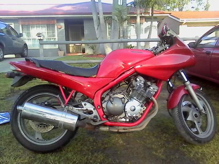

  7. Hi new member to this forum and bikes.. the crazy thing is i found a cheap 1992 XJ600 Seca II, which i think i will try and get running. The bike is complete and rolling as 1 though requires a little bit of work (well from what the seller said). I brought the bike and silly me did not hear it running (yes now i know that could be a bad thing) as the seller did not have a battery but did say it had a stater issue. The rest of the bike is there so i thought great fix that clean up the bike get my licence for the bike and ride, once comfortable clean it up and make it a better bike... So here i am.. looking forward of learning how to get this bike fixed.. 1st job is to get it started - https://yamahaclub.com/forums/topic/42894-1992-xj600-seca/ Thank you.. Andrew
