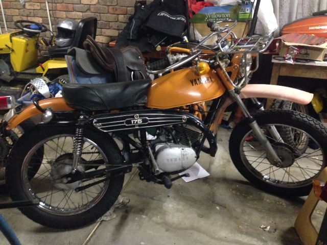

  1. Hi there folks, Fairly recently, I purchased a 1975 Ag175 (If I can work out how to add a picture, I will). It's in good condition with, seemingly, about 5,000kms under its belt. I gave things a reasonable clean up (carb, points, oil) and got her going and running OK. Lacks power, but smooth enough. Upon getting hot, she blows a large amount of white smelly smoke. Assuming this was gearbox oil coming through the crank seals, I changed out both and the thin o-ring on the right hand side. I also cleaned out the exhaust pipe, although this was pretty clear. Finally, I also pulled off the head and barrel. I didn't measure anything up, but it looked pretty good, with some hone marks still visible on the bore. The only odd thing noted was some oil around one or two of the studs - trapped in the hole where these go through the barrel. Anyway, it still blows a lot of white smoke - just as much, in fact. I assume this could be coming from where the crankcase splits? Any other thoughts? Thanks for any help / advice you can give. Cheers, Kelvin (In Oz)
  2. Agness175 replied to s900t8v's topic in Projects
    Howdy S900t8v - love your post. I just bought a 75 Ag 175 for my good wife (Birthday present...) Here's a pic (if it works) - only done about 5 thou kms. Have learned a heap from your post, including that my (her) motor likely needs new crank seals. I'm curious, if it's not giving too much away, as to what bearing shop you got all your seals etc from, early in your build. I'm also in Vic and if you've got a good bearing/seal man I'd be keen to use him and pay postage etc. Was also interested as to how you established what bearing an seal sizes? Were you working from those removed or did you have a reference at hand. Thanks for any help you can give. Cheers.
