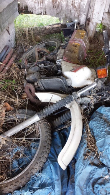

  5. Thanks for heads up cynic. Will source a battery tomorrow. So far I have run premix but I will give the oil injection pump a test.
