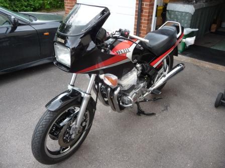

  1. Pic of my 99% completed XJ900 31A - just brake fluid and a press of th e starter button required.

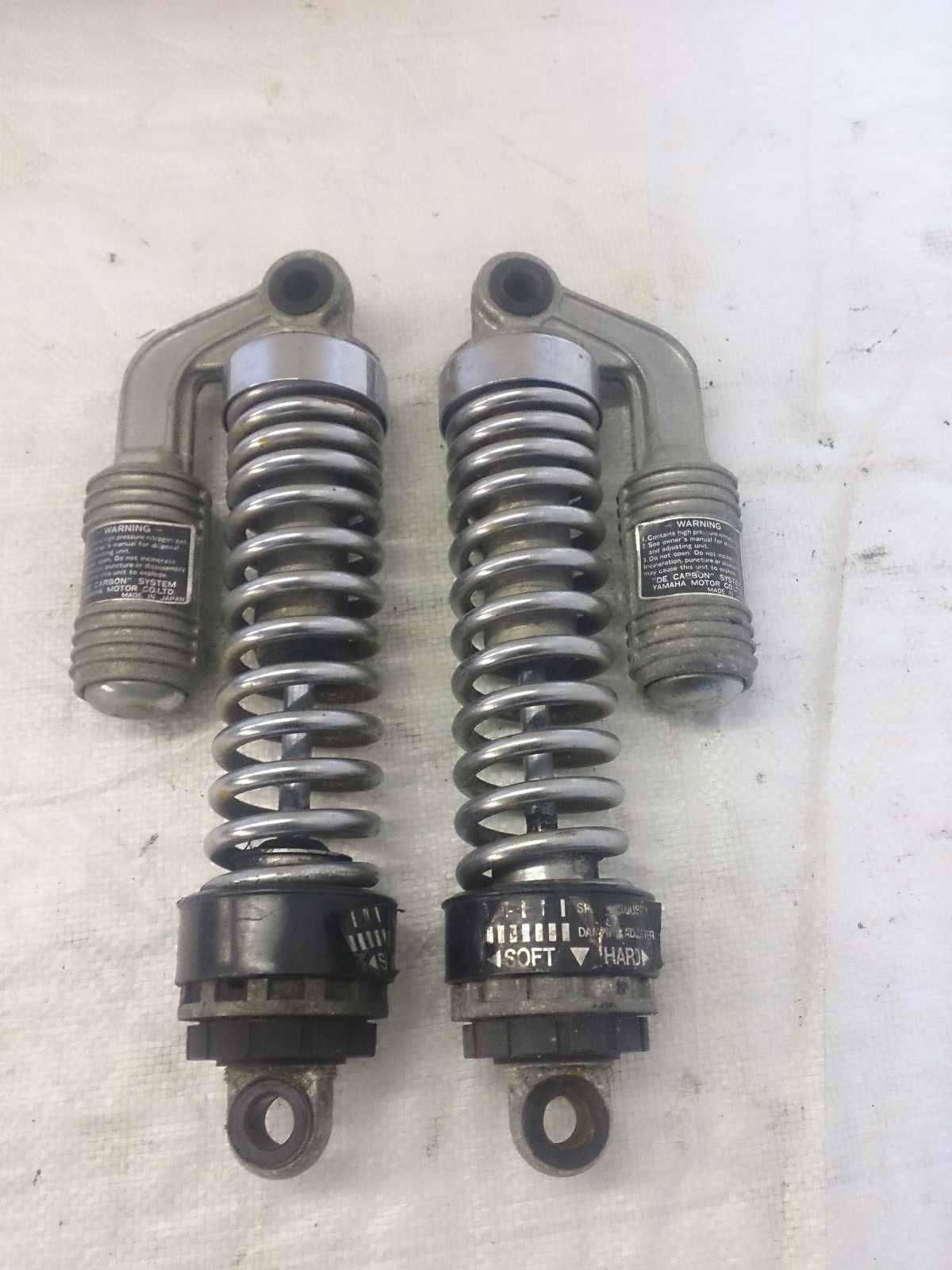

  3. Thnaks slice, They're more complicated than the diagram you've shown as they've got the adjustment for both damping and preload and I assumed it must be something like you say but the local bike shop wouldn't even think about taking them apart as they hadn't seen anything like them.
  4. Hi, Have got my latest project, '84 XJ900 back together and runnig through a few niggles with the electrics but I have purchased some original De Carbon shocks. Does anyone know if these can be dismantled and if so how - I'm only interested in getting to the springs and replacing the bump stop?
