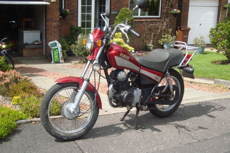

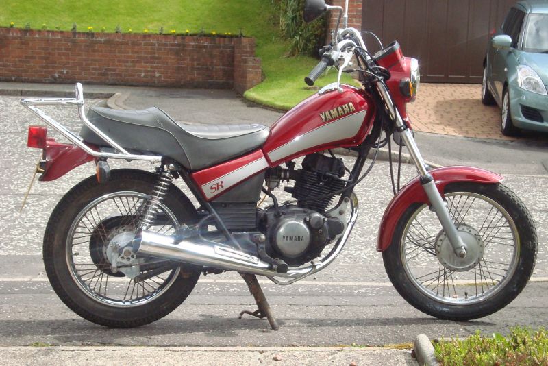

  18. jimmy posted a post in a topic in Yamaha Gallery
    Heres a pic of my current ride. Its a 1997 xjr 1200 and this is my boys 1992 sr125
