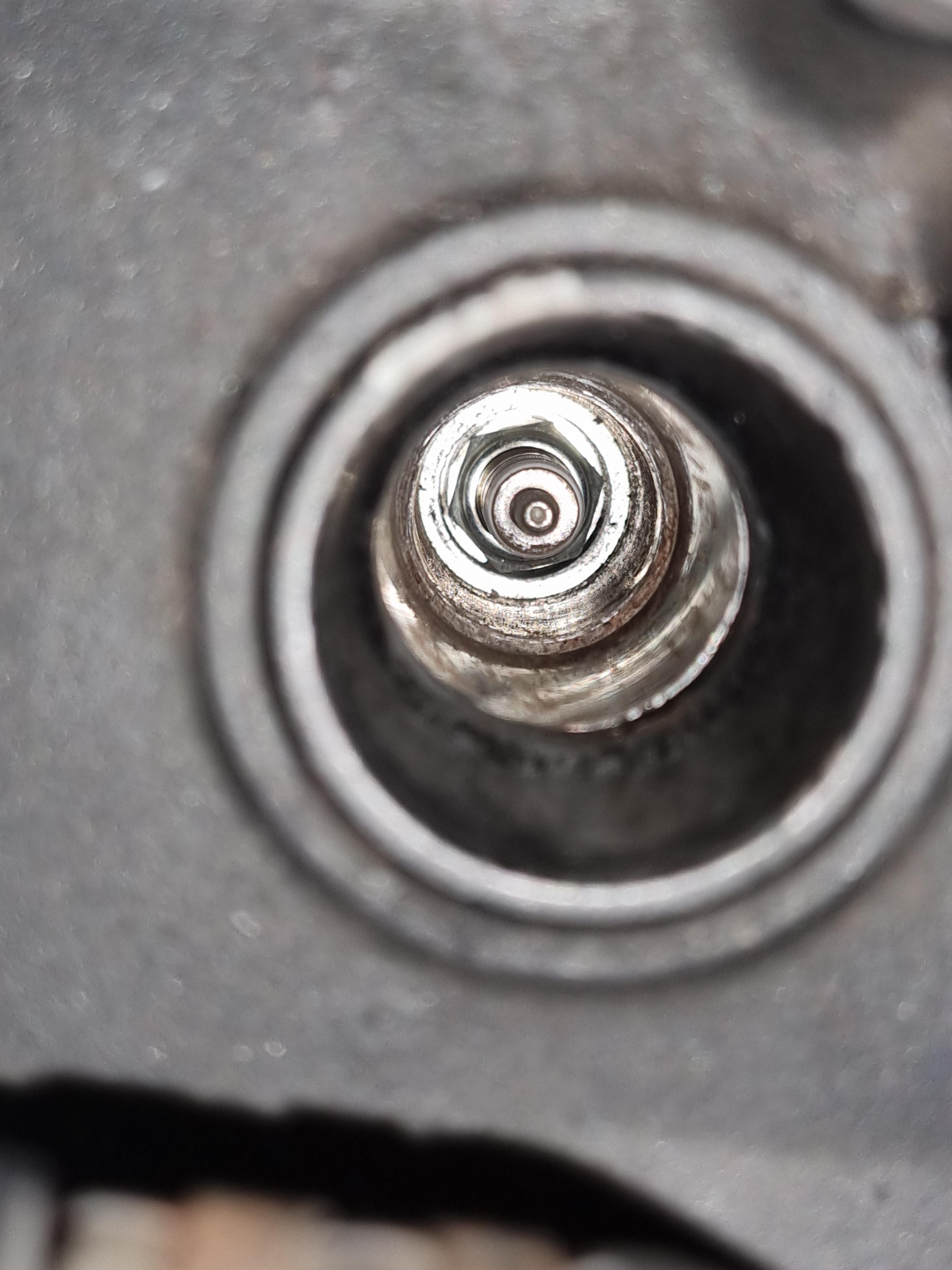

Anyone know what i am missing? Spark plug socket wont go down over ones in bike.
There appears to be something sitting over the plugs.
Crude pic attached.
Is there anything unique about these bikes? Asked question on American site and they said there are helicoils fitted (to all 4??) and i need a new cylinder head. Seems a bit extreme!

From your 'Crude pic', even if there are helicoils on there, they don't appear to extend beyond the nut.
So, I'd be more inclined to wonder if either:
1/ You're using the wrong sized socket (aftermarket / foreign plugs).
or
2/ Your socket isn't long enough (aftermarket / foreign plugs).
Try a different/deeper socket...
Thats a good shout, thanks. Dont think its a case of the socket/extension being long enough. But that i need a plug spanner, ie thin walled.
If its some sort of after market or foreign plug, any idea what the size is AF?
Not a clue I'm afraid, I just use what fits! lol
On my vmax i have a socket i have ground down to fit better. There are only a few plug sizes, check on the bench that the plug fits the inside of the socket you have then grind it down till it fits.
Not scientific but works. There must be a socket that fits, not wanting to cast doubt on the nay sayers that called for a new head. The blindingly obvious fact is, someone put the plugs IN. They would not have done that without a socket.
