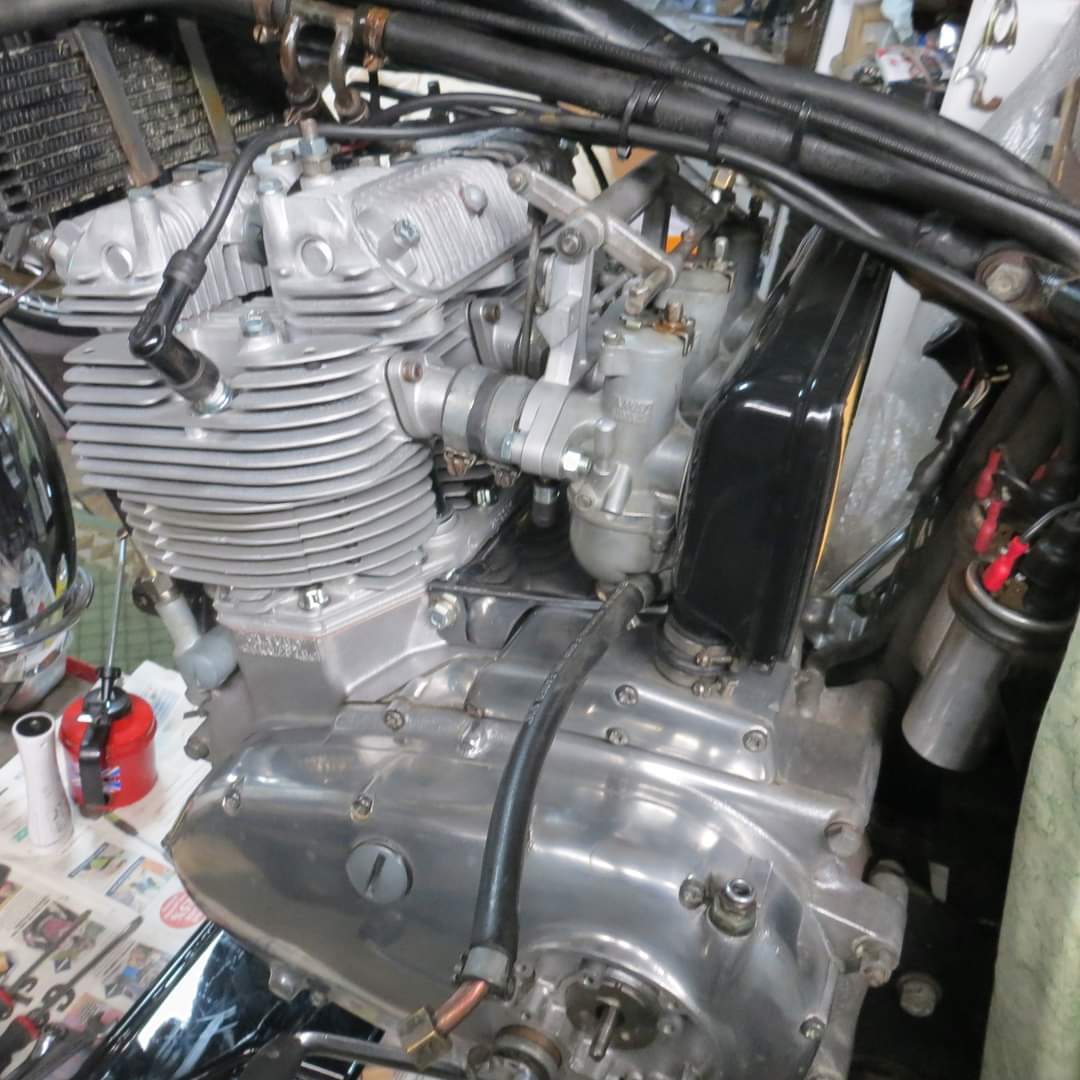

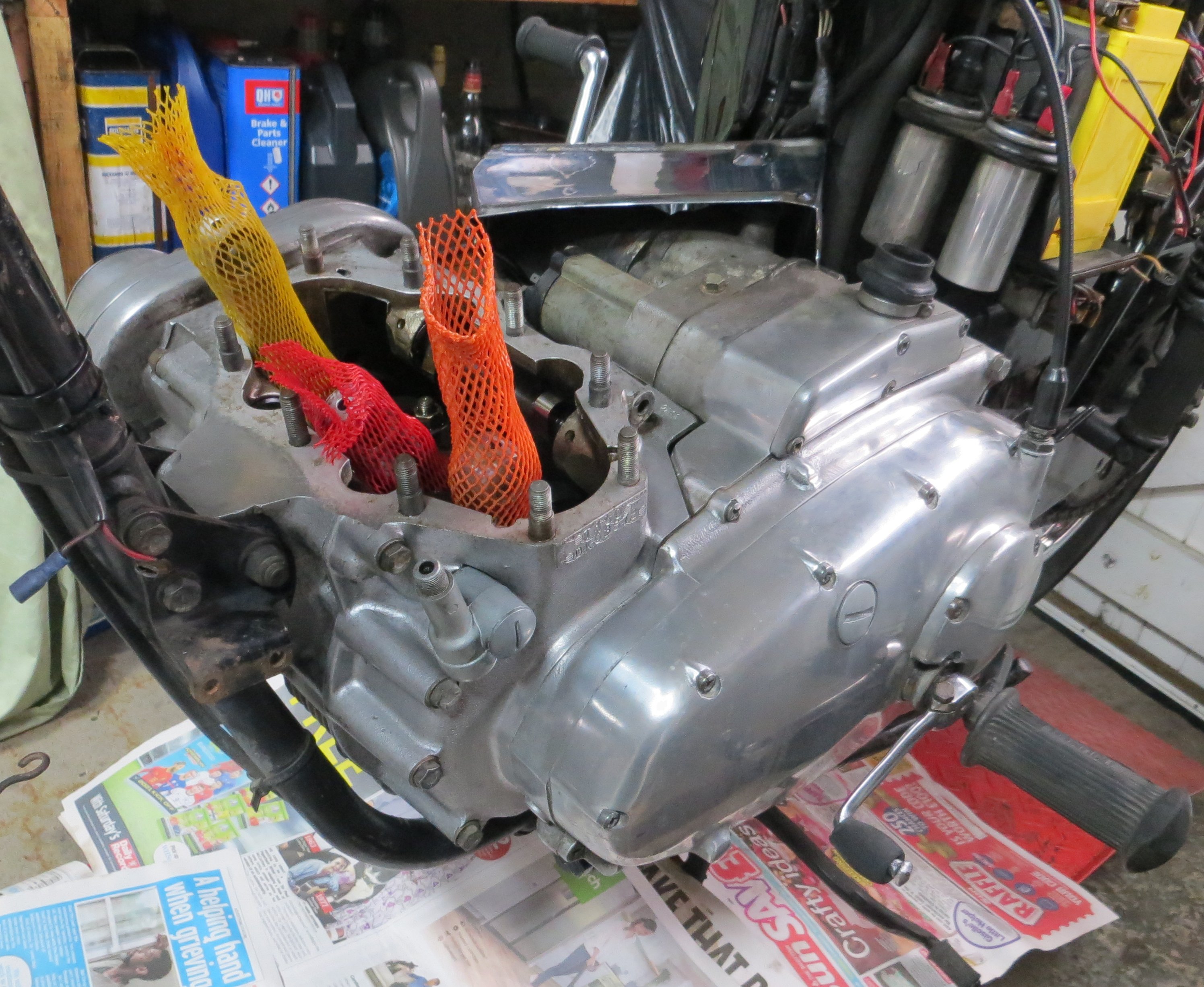

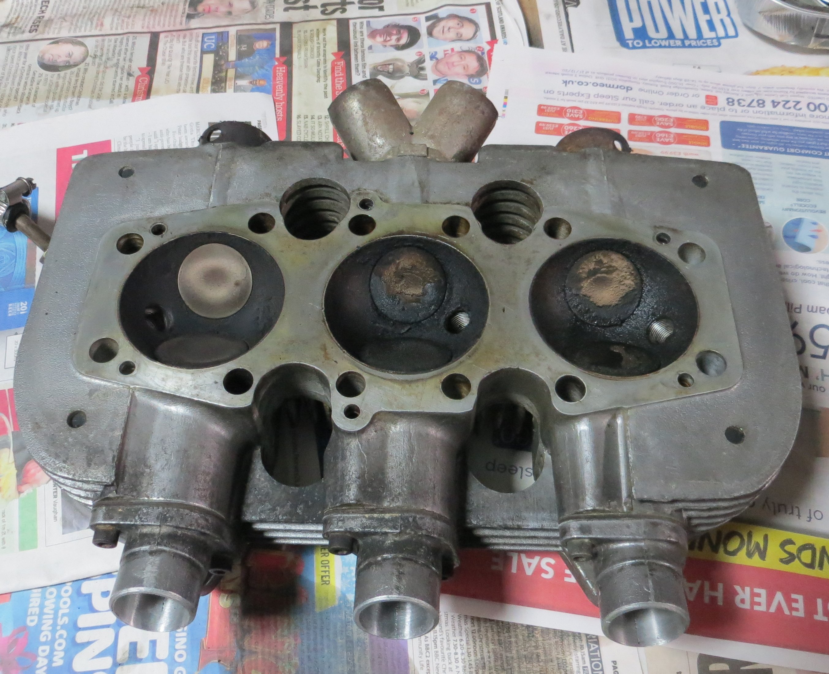

My 1975 T160 Trident was burning a bit of oil, so having missed out on a few weekend aways due to lockdown, I saved my money and gave the bike through to Grin Triumph in Kennoway, Fife. He is a one man operation with a great rep for auld Triumphs.
I dropped it off in March and picked it up a couple of days ago.

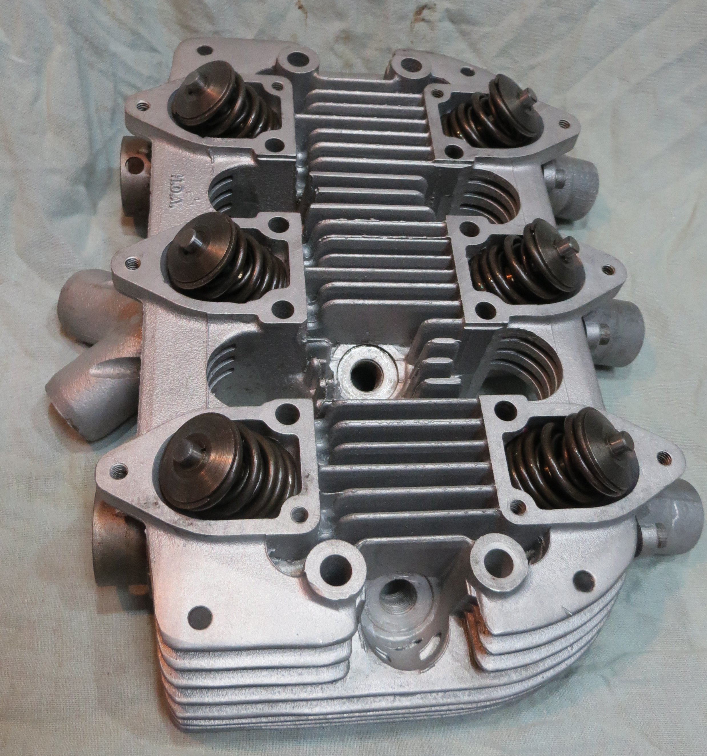

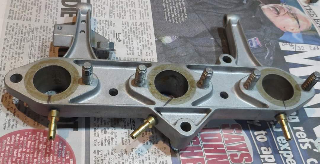

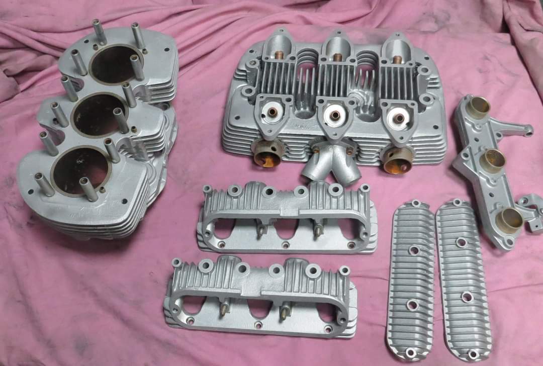

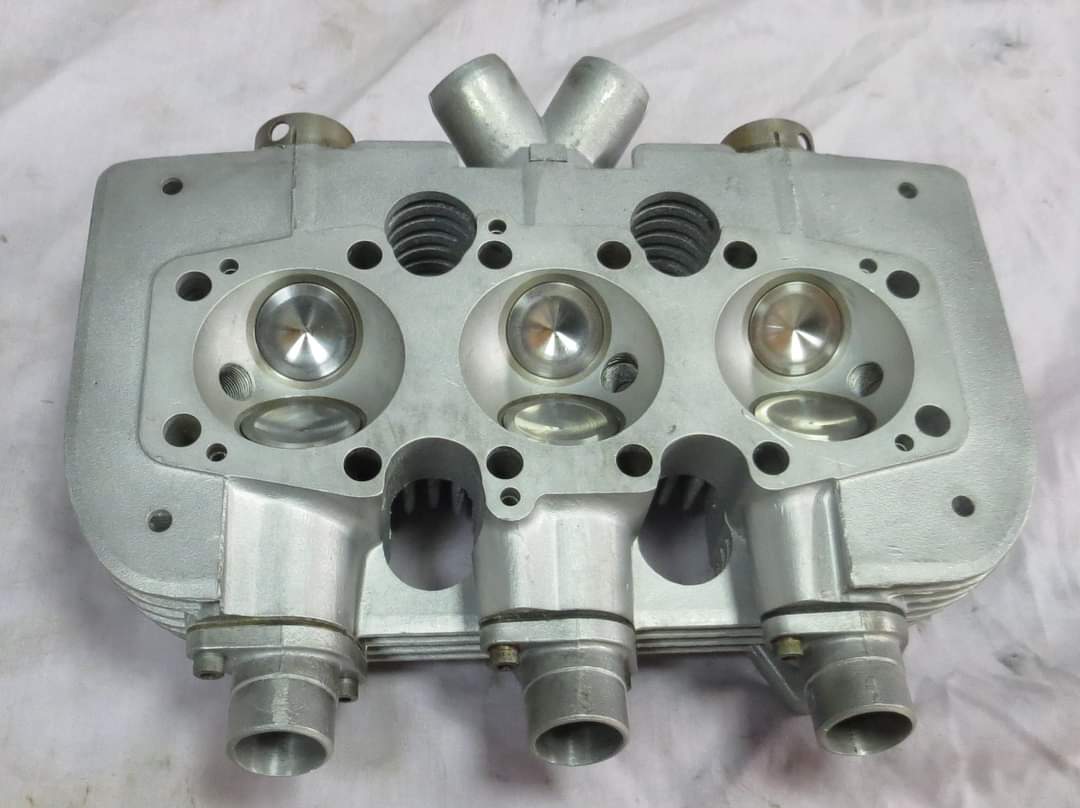

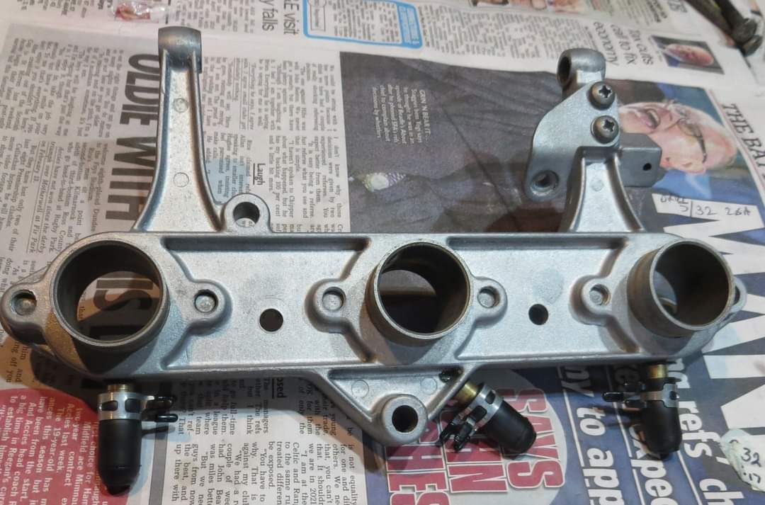

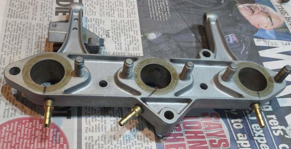

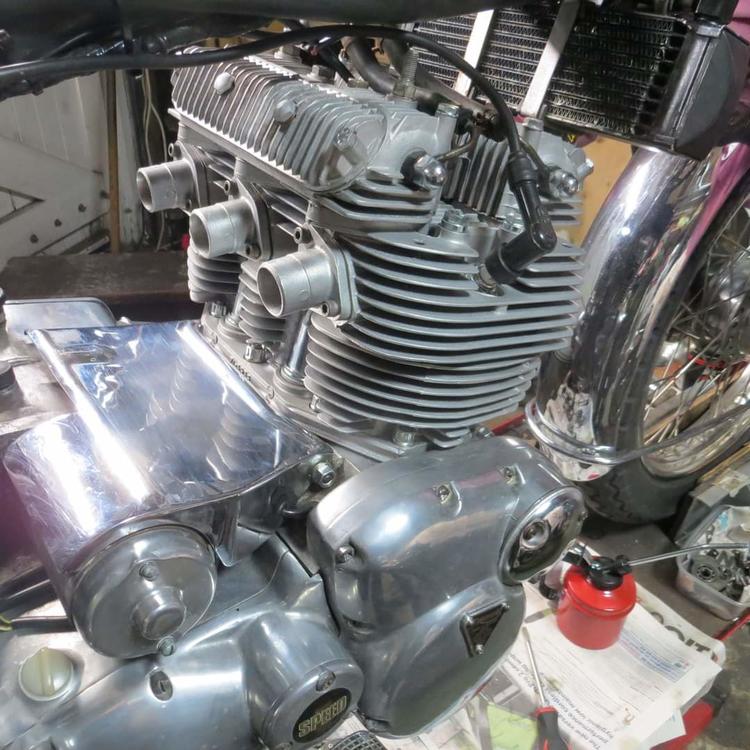

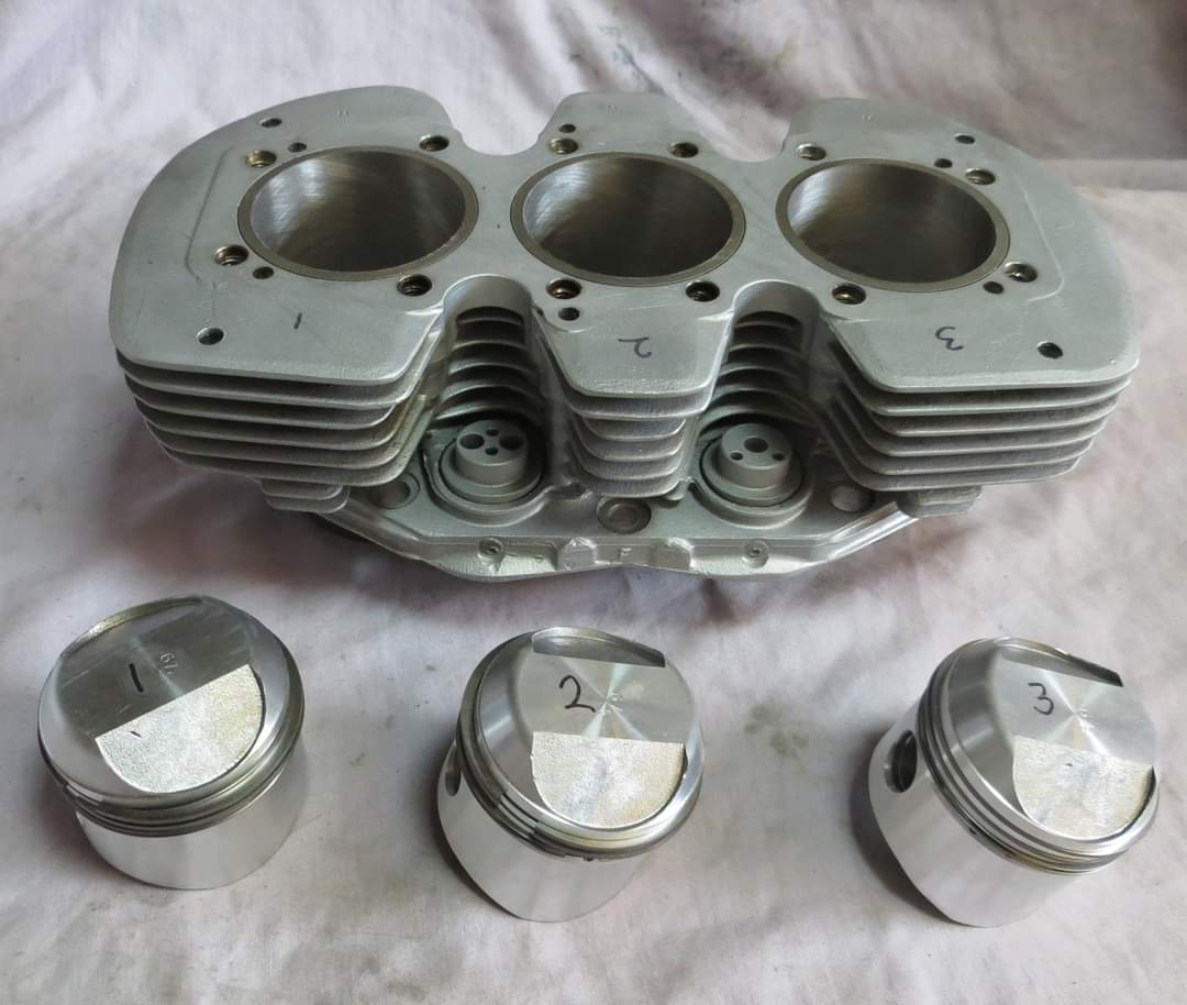

He stripped the top end and rebored the barrels out to +20 and fitted new pistons. He also fitted new valves, guides, springs etc and vapour blasted all components.
Apologies it's not a Yam, but hey...the sharp eyed will note that the vacuum covers on the carb gantry are actually Yam parts, so qualifies
