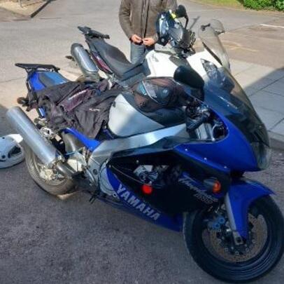

July 10, 2025Jul 10 best bike i've owned, three years of happiness now, what's not to like - comfy, sits well and goes well.
July 12, 2025Jul 12 Author Moderator Looks like you've got your original exhaust on. How's your EXUP doing?
July 12, 2025Jul 12 makes an awful noise, but since it is only a worn valve i have left it, they are like hens teeth to find and even then the access fixings will be rusted.whereabouts are you s/bite please? just roughly.
July 13, 2025Jul 13 Author Moderator I'm West Yorkshire.You need to get that EXUP open and serviced! Like you say, they're rare now, so you don't want it to wear too much...

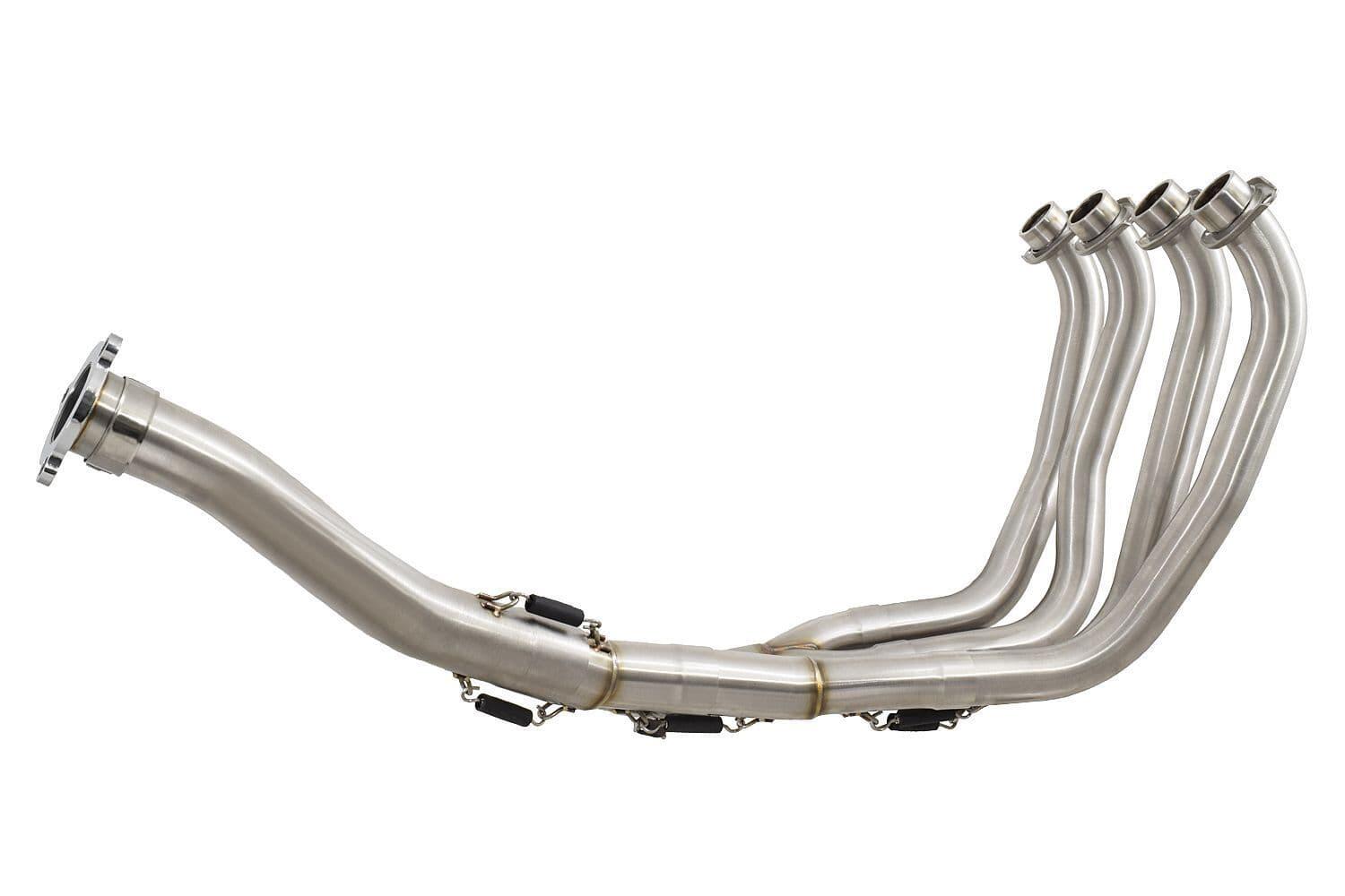

July 19, 2025Jul 19 On 13/07/2025 at 12:09, Snakebite68 said:I'm West Yorkshire.You need to get that EXUP open and serviced! Like you say, they're rare now, so you don't want it to wear too much...this is probably the way to go - no valve required. eBay UKYZF1000R Thunderace 1996-2003 Exhaust Downpipes Headers -...UK customers - please note this silencer is not road legal in the UK and will be marked Not for Road Use Exhaust Downpipes Headers Fits: Yamaha YZF1000R Thunderace 1996-2003 models. - Weight : 3.8...On 15/07/2025 at 05:40, Alex said:Wonder what happened to my old YZF, sadly likely in a scrap heap somewhere now. Loved that bike, still one of the most fun bikes I've had.thunderace motorcycles are surprisingly inexpensive here in the UK, sportsbikes aren't the thing anymore, here at least - more adventure, naked, retro et al now.
July 19, 2025Jul 19 Author Moderator Yup, that's what's on my Ace... 😁Now clean your EXUP before you need one of those! roflP.S.I'm actually a little confused about mine. I upgraded to the BW pipes a couple of years ago, it had a cheap one piece stainless version before.The valve motor is definitely not there, but I also can't find a servo cheater..?Apparently, it's possible that the servo has been switched off in the ECU...
July 19, 2025Jul 19 9 minutes ago, Snakebite68 said:Yup, that's what's on my Ace... 😁Now clean your EXUP before you need one of those! roflP.S.I'm actually a little confused about mine. I upgraded to the BW pipes a couple of years ago, it had a cheap one piece stainless version before.The valve motor is definitely not there, but I also can't find a servo cheater..?Apparently, it's possible that the servo has been switched off in the ECU...dunno snake, the little motor under the tank pulls cables to operate the valve, the cables travel behind the engine and are a fiddle to replace, the problem with mine is that the fittings are so rusted that I can't get to the valve which runs right across the four pipes under the engine, it is loose but at least it works albeit noisily lol.This is what the BW people say:-Exhaust Downpipes HeadersFits: Yamaha YZF1000R Thunderace 1996-2003 models.Weight : 3.8 Kilos (8.4 lbs), Saving over 7 kilos ( 15 lbs ) on the original headers.These upgraded headers are designed to out perform the original headers with no EXUP valve. No re-jetting/modifications required for bikes on standard settings. Four engine port gaskets included. We also include the slip on silencer flange which allows you to refit the original Yamaha silencer if you wish to.Remove the exhaust control cables, leave the electric motor in place. No fault codes will show.see particularly the last bullet point, if you haven't got the electric motor I guess something else has been done to make the bike perform OK, or not, if it goes alright then no worries?
