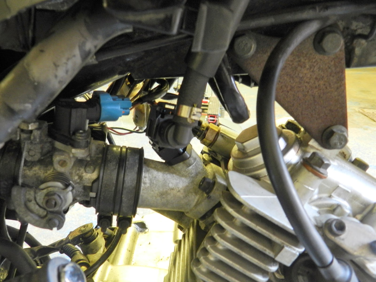

This may seem like a stupid question, but the image below isn't of my bike, just grabbed it off t'internet 'cos I'm at work. The fuel hose is at the middle of the screen - on my bike it has a clip but not like the one in the image. My one has nothing to grab and pinch to take it off IYSWIM, looks like it's throw away if I get it off (if I can get it off at all without damaging the hose). My question is - where it turns at a right angle it goes into the plastic housing thing there. Is there a way of disconnecting it there, or do I need to remove that clip? I'll stop off at B&Q on way home if so for a replacement clip.
Edited by PaxRomana
Double check that the clips to pinch arent round the other side. If they are, just twist the clip around till you can get bat them. If its a wire type clip, just snip it with a pair of cutters. Measure the outside diameter of the pipe before you buy a replacement clip. Careful pulling the pipe of the elbow, the pipe is pushed over a step on the elbow in order to seal. A small Jubilee Clip of the right size will do ya, dont overtighten it
