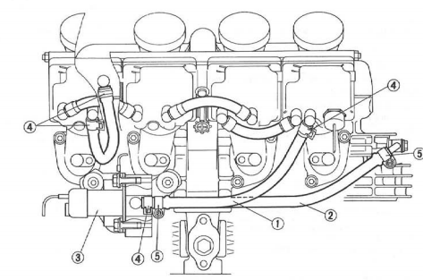

Also there is a solenoid (number 3 in the picture attached) that actuates a hose that goes from the carbs to the engine head on one side what is the solenoid for?

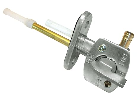

Your fuel tap should have something like "OFF" "RES" "FUEL". The fuel only flows when your on the fuel setting normally BUT if you chose RES then it should piss out regardless, your bike needs a vacuum from the engine to draw fuel from the tank to the carbs, you only use RES if your a tit and forget to fill up (been there done that.!) The pipe from num 3 carb is the Vac pipe, you should have a filter somewhere in the fuel line to, might be under the tank? Something like the pics below.
Of course you might have none of this as your bike is totally different but that's the usual fittings on a lot of bikes. Hope that helps a bit anyway.
Those are just generic pictures yours might be slightly different.
Related image  Fuel tap Image result for yamaha motorcycle fuel filter  And Filter
If vacuum carbs, it should say On / Res / Prime. It should run freely on Prime ( I assumed that's what you meant when you typed purge, but maybe not)
