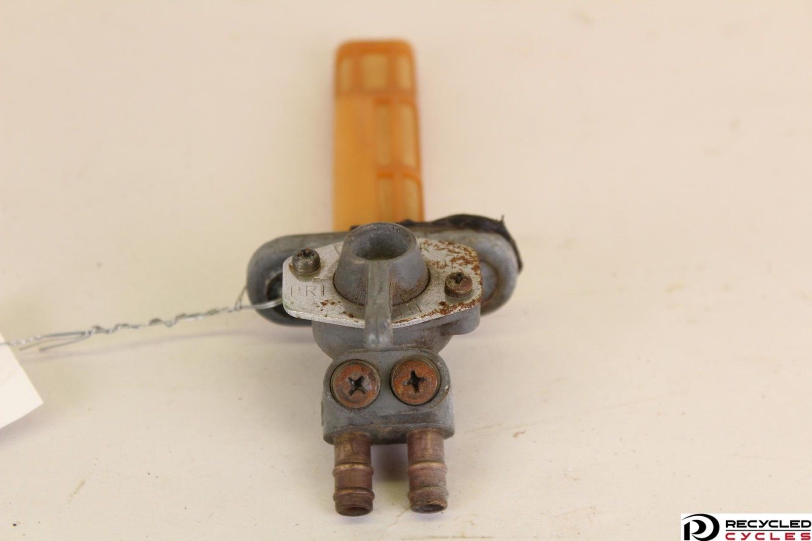

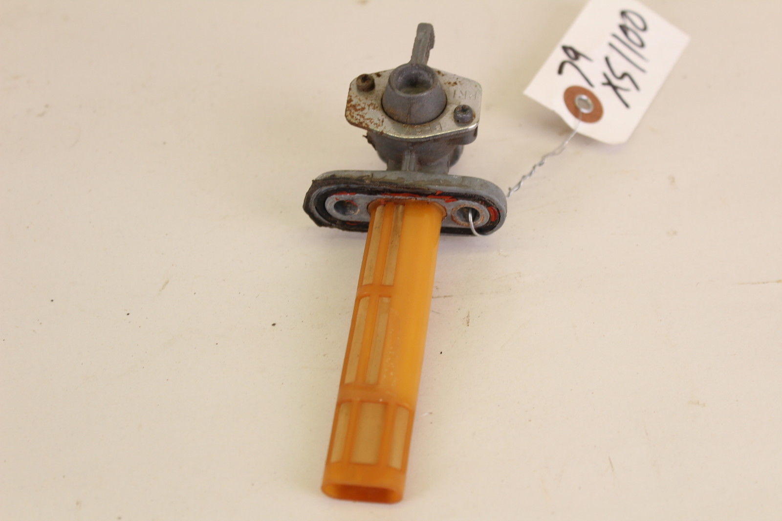

However with the correct vacuum Fuel shut off valves,
 as you can see from the image the petcock is totally different to the one in your image without these there is a chance you may have to do some mods to get around your problems
