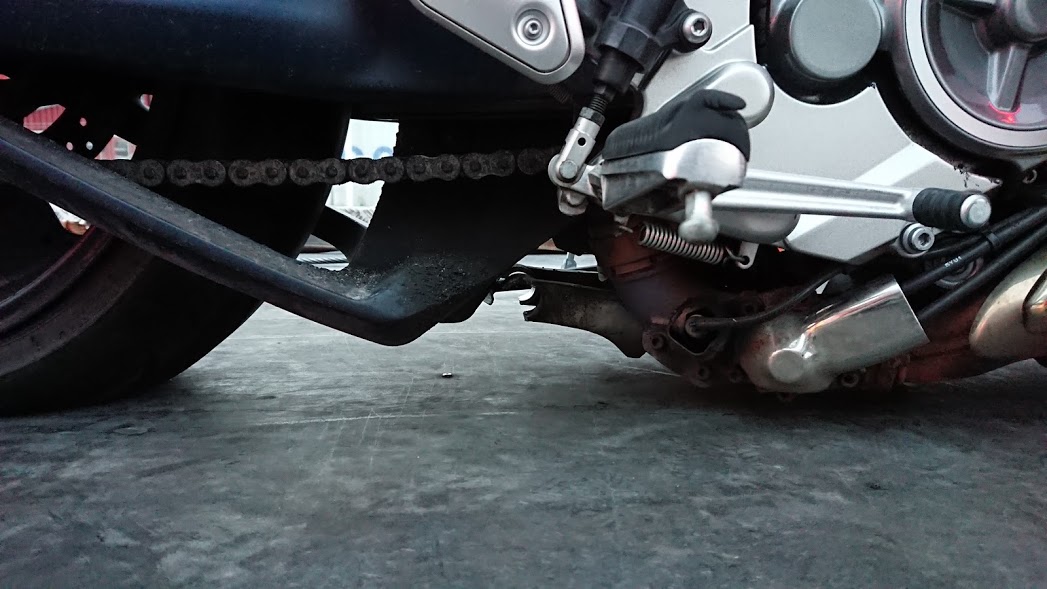

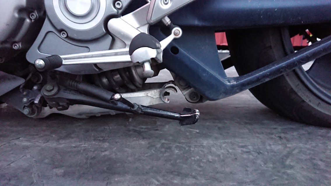

Yamaha mt-01 supension collapse
Rearsuspension collapse when driving  ,,maby somthing for yamaha mt 01 drivers to check
