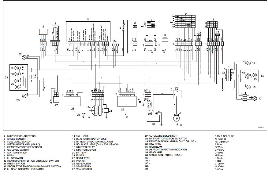

So I was under the impression that 3 wires came from the generator and went into the rectifier and then to the battery, but looking at a wiring diagram(see pic) it appears there's a wire that runs from the generator straight to the battery, surely this would be an AC wire or does the generator produce DC as well?  i'm confused

Pretty sure this ones safe :)
So it looks like the ignition switch is wired on the same circuit as the battery feed, the ignition must work as the engine runs but no feed to the battery, would that suggest the generator coils are ok on this circuit and maybe just a connection break to the battery, or have I miss understood the diagram?
By the way I've replaced the rectifier and there was no change.

Assumption is a dangerous game. The ig switch is actually 2 sometimes 3 and can be more. Switches in one.
One part earths the ig when you sw off. The other disconnects the +12.
Follow the wires from Terminal 8 on the rectifier and from Terminal 5 on the generator and it should make sense. That is the wiring in question.

I will do a continuity test on that circuit.
 i'm a little unsure on how to test if the generator coil is giving out enough voltage, obviously I know i'm looking for AC but which numbers on the generator connector block would I place my multimeter prongs to to test it, on 4+5 together? or do I put the earth prong to the battery earth terminal and positive prong to 4+5 individually?
Also what kinda reading should I get?

You wont have the kit to test the rectifier that uses some electrical mumbo jumbo to work.
Test across 4 and 5 with the mag disconnected. And according to the book you should expect............ 0, yep that's a big fat fk all, confuses me too (that's Haynes for you) but running it should develop ~35v at 6000 rpm so I would think its a very low resistance with some quite high tolerance explaining why they go.
Now if you have continuity between T10 at the dash and the orange wires at the ig switch and the fuses as well as the green wire between t4 (gen) and t8 (rectifier) then as she runs the easiest check is to get into the wire at t5 (gen) and see what the output ( ~35v @6000 rpm) is when running. Putting a pin through the wire is useful for this as once done and the pin removed  the wire is hardly affected.
You should know which is the problem then, its not uncommon for one to take out the other though.
