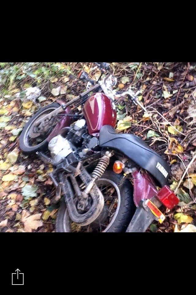

I rencently recovered my baby after she was rudely snatched during the night and used and abused by a group of little hood rats so ive decided shes gunna be treated to a full rebuild and turned into a real custom bike to be proud of
Now for pictures
My girl before she had here inocents stolen

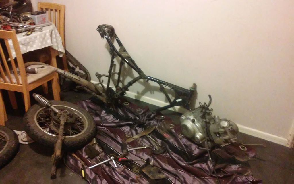

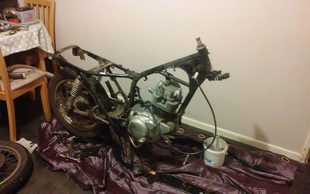

So i started to strip her down
Now she had been fully stripped i have a basic list of parts that will need replacing

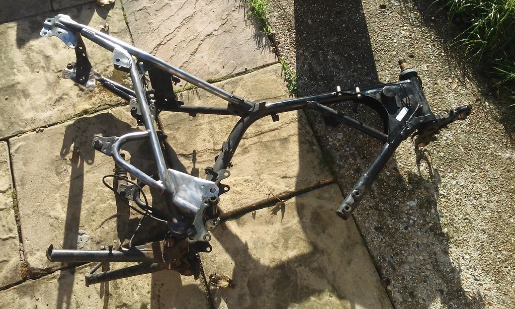

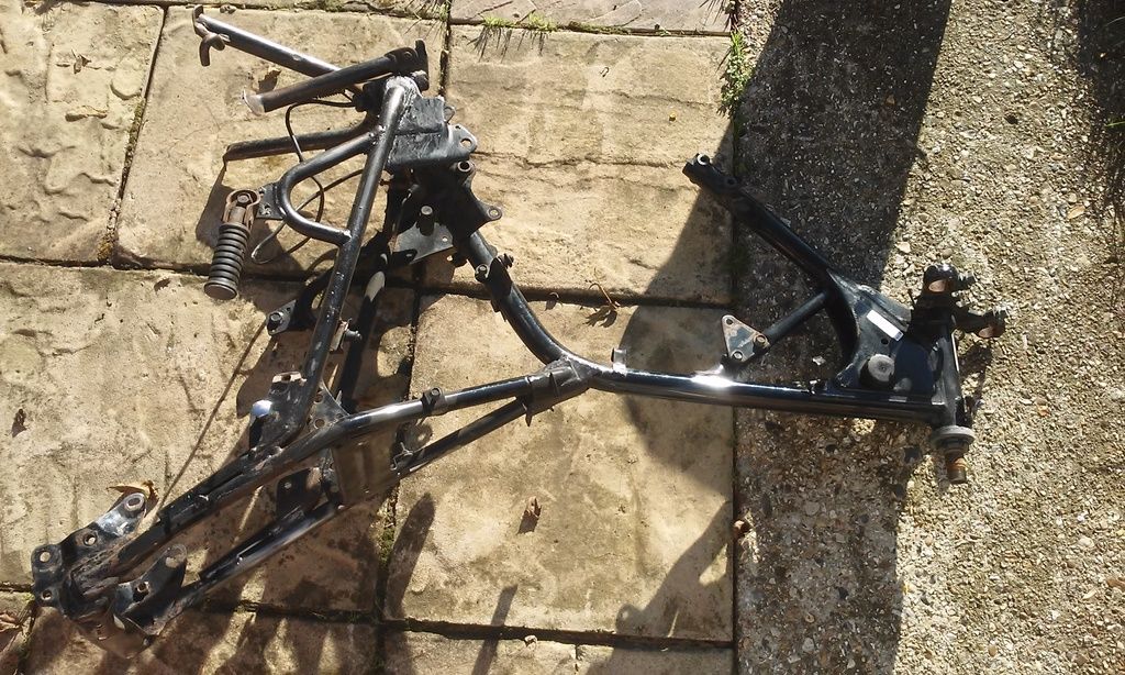

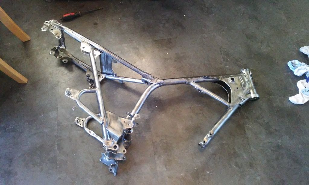

Today the real work stared i went out and brought 3 crimped cup wire head for my angle grinder and started cleaning up and removing the paint off the frame
Before i started
After 2 hours
Ive managed to get about 50% finished today tomoz im gunna finish stripping her and im gunna rust treat the whole frame with kurust and clean so she is preped and ready for primer

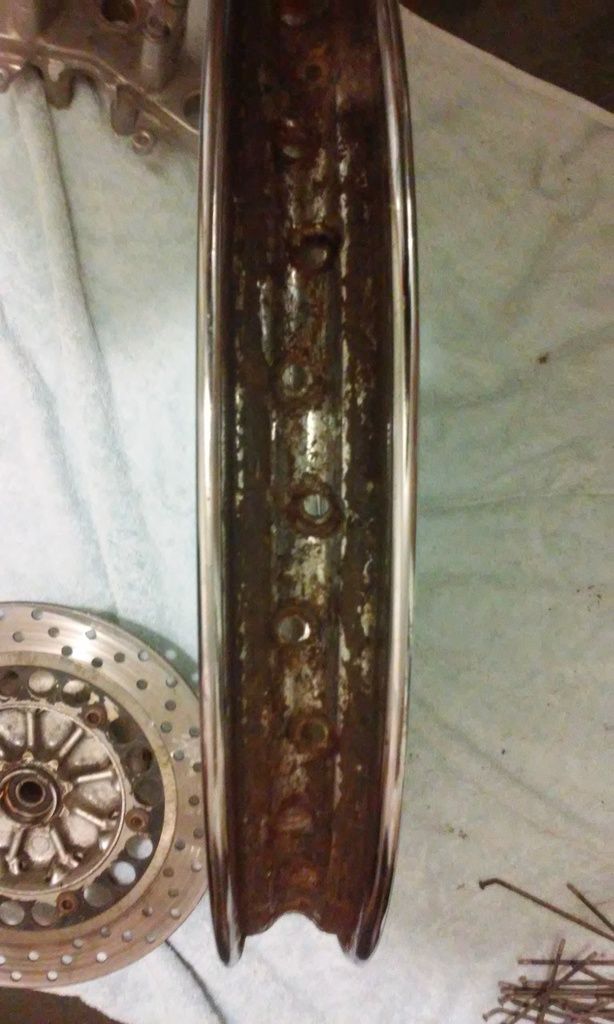

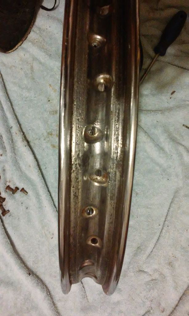

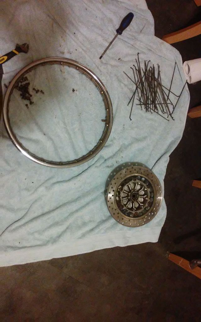

Little update for ya managed to get 75% of the frame stripped only got started at bout 3 so didnt have long before i lost the light but had a friend over to help me get the tyre off and was greeted by this
So i stripped the rim
And ground off all the surface rust

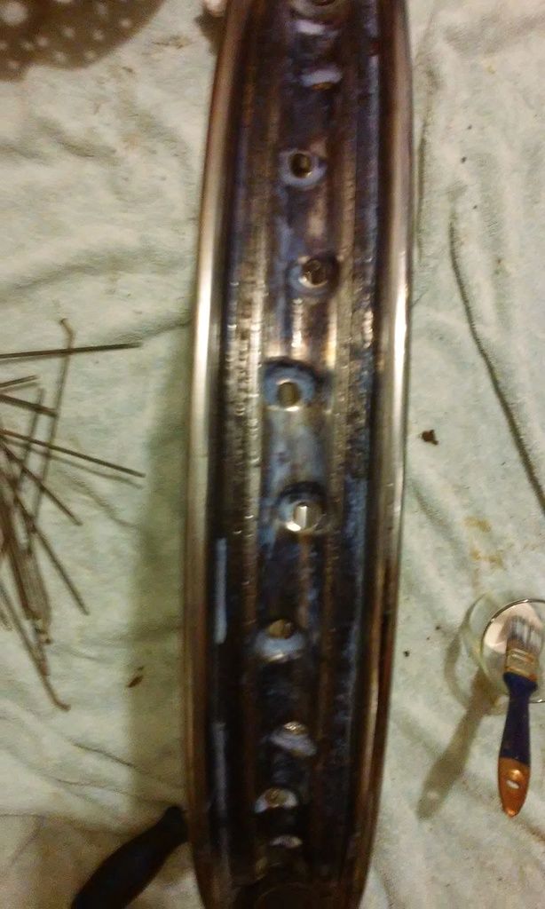

Put 5ml of kurust im a glass and used a old brush
And dabbed the kurust over the surfsce that needed treating as it goes on it turns blue once reaction has finished it will go black
Thanks for reading
Ride safe
before checking for any  offset of the spokes?
I just stripped em down didnt check for off set wouldnt even know how to tell you the truth
All spokes were straight and the wheel wasnt buckle at all

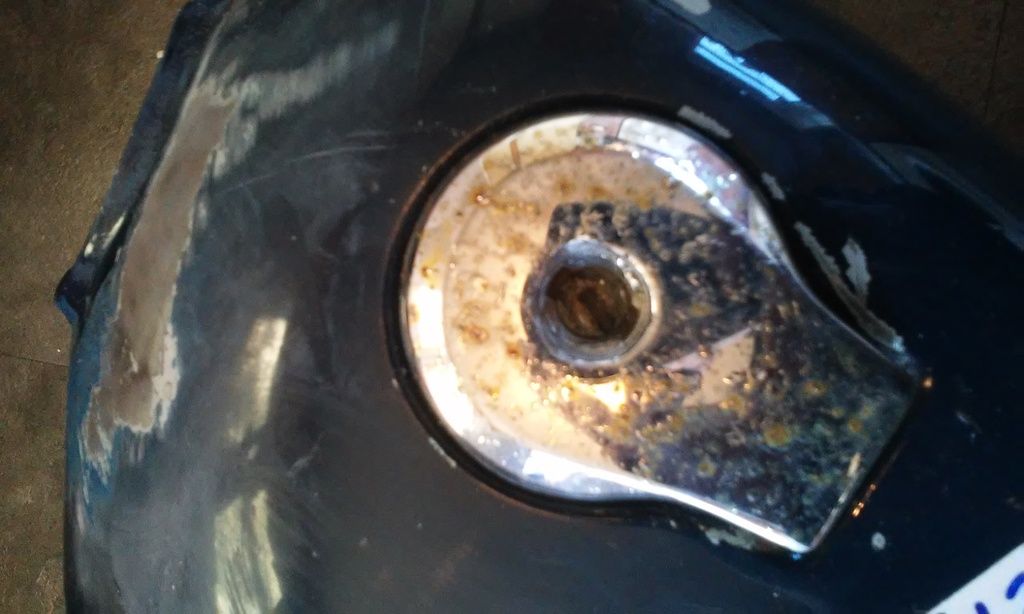

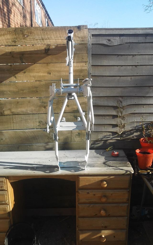

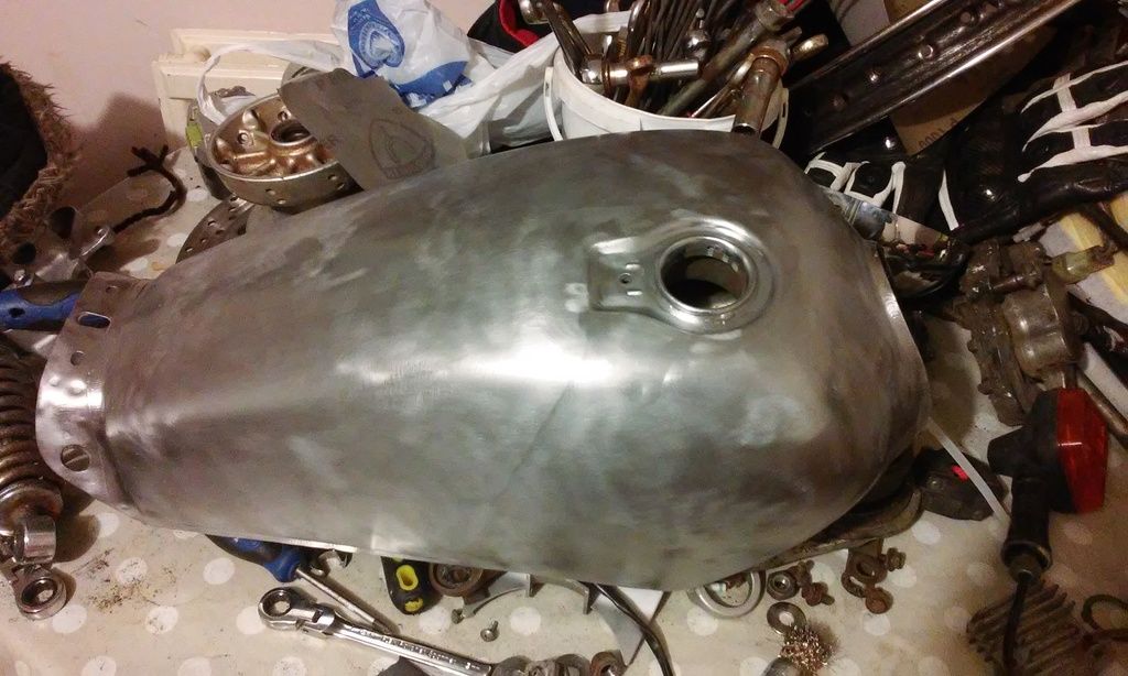

After 15 hours of grinding and cleaning the frame she if finaly preped ready for painting

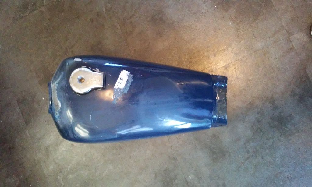

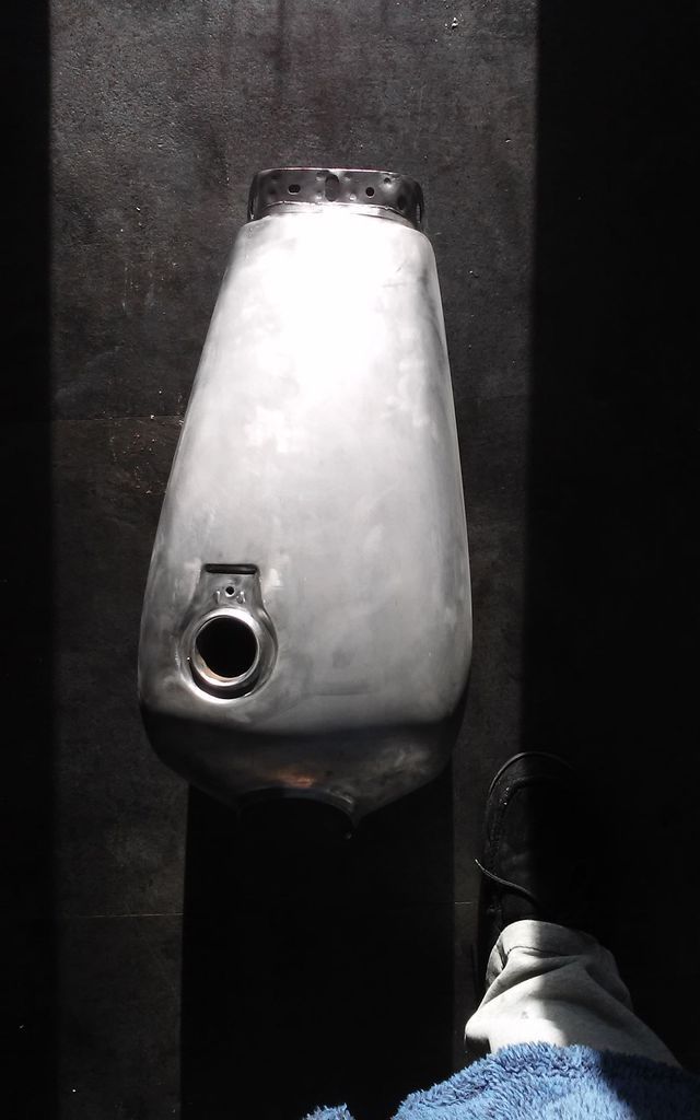

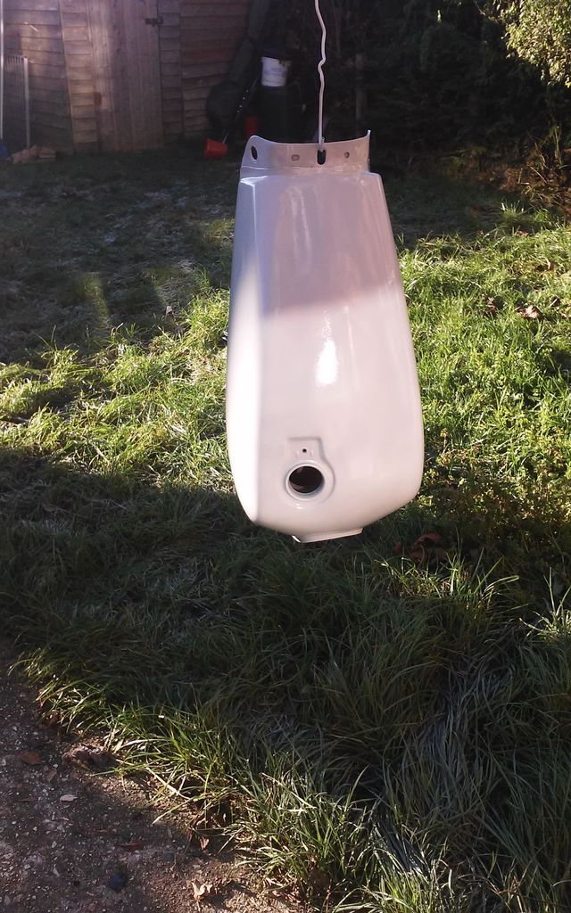

Yesterday my new tank arrived managed to get it for a bloody bargain 29.99 with postage and it is clean as anything
only issue was it didnt come with a key so i had to drill the lock out
Gunna prep it today ready to decide on what to do with it dont know if i should clear coat or paint it
Cheers for reading
Ride safe
Hi Jonny 15 hours of grinding I admire your work ethic our local sandblaster does a medium frame and swing arm 80quid including powder coat but I suppose that's the easy way out used to do the even harder way by hand when I was a kid I think that's what put me off! Keep up the hard work you making good progress top looking tank for the money!
Im trying to keep all costs as low as possible and try not to have things done  professionally probally will send the tank in for spraying as it needs to be perfect (and im not playing with cyanide based paints) other than that All will be done by my fair (full of metal fragment pmsl) hands
Do today I cracked on 28th the tank and got it all cleaned up only about a hour of sanding to finish her off

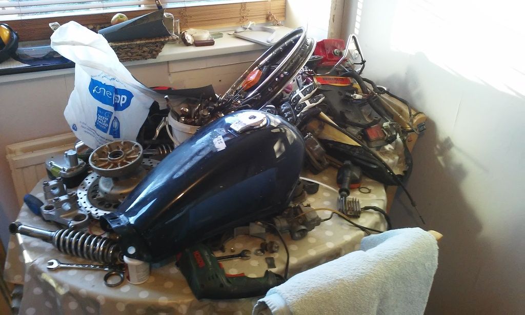

Is that still mrs Jonny kitchen table lol
Loving the photo with a side panel in the fruit bowl!

Sorry for the late update today but been busy, I managed to get the tank sanded down and ready for painting
My frame paint and primer arrived late this evening was hoping it arrive this morn so I could get the frame and tank primed but will have to wait till Tomoz now
Where else would you put one

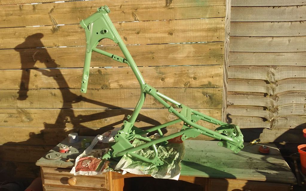

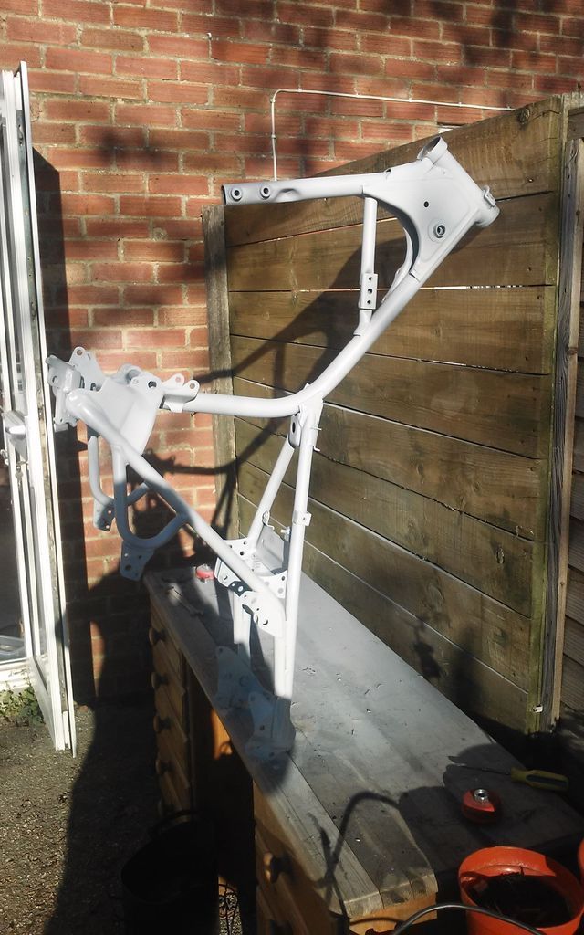

Hi people
Been busy today got my frame and tank primed up and ready to be paint loving this paint goes on real and gives a nice clean finish bonus is this primer drys in 10
Ride safe
Frame is finished now
Turned out better than expected
Ride safe
