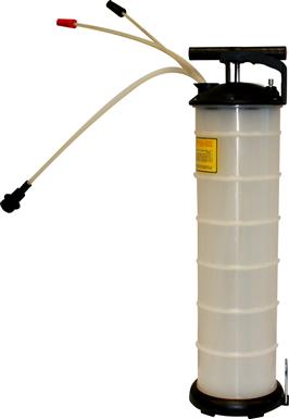

For a quick fix see if you can get your hands one one of those vacuum oil scavenging pumps.
Warm up oil, tube down the fill hole, suck, suck, suck,  for the last bit lean bike over a bit.
May not get all the gremlins from the bottom of the pan but better than running with oil past its shelf life.
Gives you options to think how to tackle the shot plug
