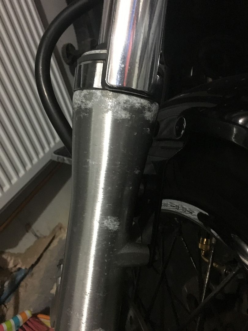

Might struggle with these
B018809A-7D78-4C6E-9074-26C207C9B4F1_zps
thanks
I'd try fettling them corroded areas with the wirewheel/dremmel. Then try to match the paint up up, I recall hammerite do a very similar grey/silver in a small pot. Once dry, wipe them down with a acf50 rag.
If its chrome, buy a small tin of the spray chrome finish, spray a little into the lid, then brush it onto the areas reqd. Then same again, acf50 rag
Dont get it on the brakes or disc/s
its the laquer that had failed and corrosion has got underneath. would need to use wet and dry paper before polishing
Thanks for the advice, seen some YouTube clips on totally removing the lacquer and going bare metal polished. Like the sound of that lol

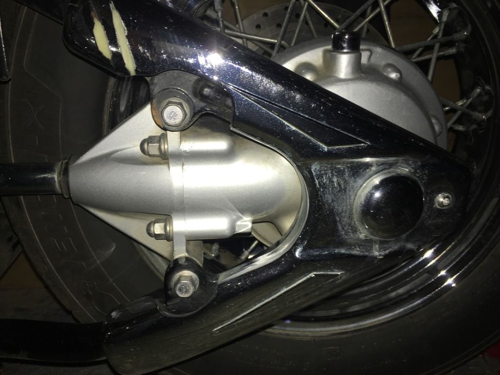

any ideas where I can get spares like the one below,
9E5423DF-D4A2-4397-B54A-7C8438781F74_zps
yes the rear plastic clip on accessory, probably be better to take it off for now, but cannot seem to be able to find anything similar to replace it with.
Not familiar with this bike, but it looks like the part number is 5KS221100100 , but this is the entire rear arm - which I assume includes the plastic covering. (£600) As I have seen a few times with new OEM parts it may be hard to get this piece on its own. Might be worth looking on ebay or somewhere similar for used parts.
