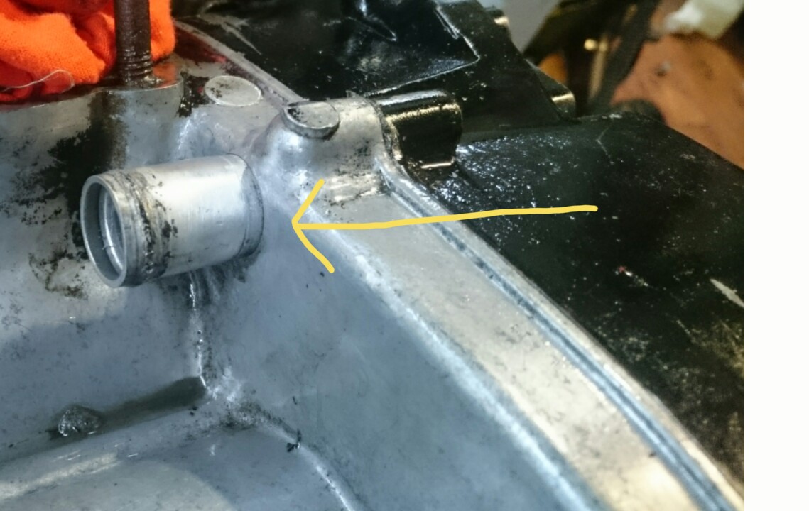

Hi - I am having problems removing the clutch cover on my RD350lc. It appears to be because of the water pipe which passes through the crankcase is stuck - both in the hole (there is a slight ridge in the pipe) and in the clutch cover (I presume it is a separate part). I have tried gentle taps with rubber hammer, and a carefully wedged screwdriver without success. Ideas please. Thanks in advance

Assuming you've taken out all the screws, certain there is 9 in total, it is usual for the clutch cover to get stuck on the O ring that fits on the end of the alloy coolant tube that is seen in your photo where it fits inside the clutch cover to seal the coolant from the gearbox oil. There is also a wire circlip on the tube which is by the O ring to hold the tube in place when you put the clutch cover back on. Try spraying something like WD40 in the area where the tube fits in and try gently wiggling the clutch cover off. Be careful trying to prise off with a screwdriver as you'll end up damaging the gasket surfaces.
