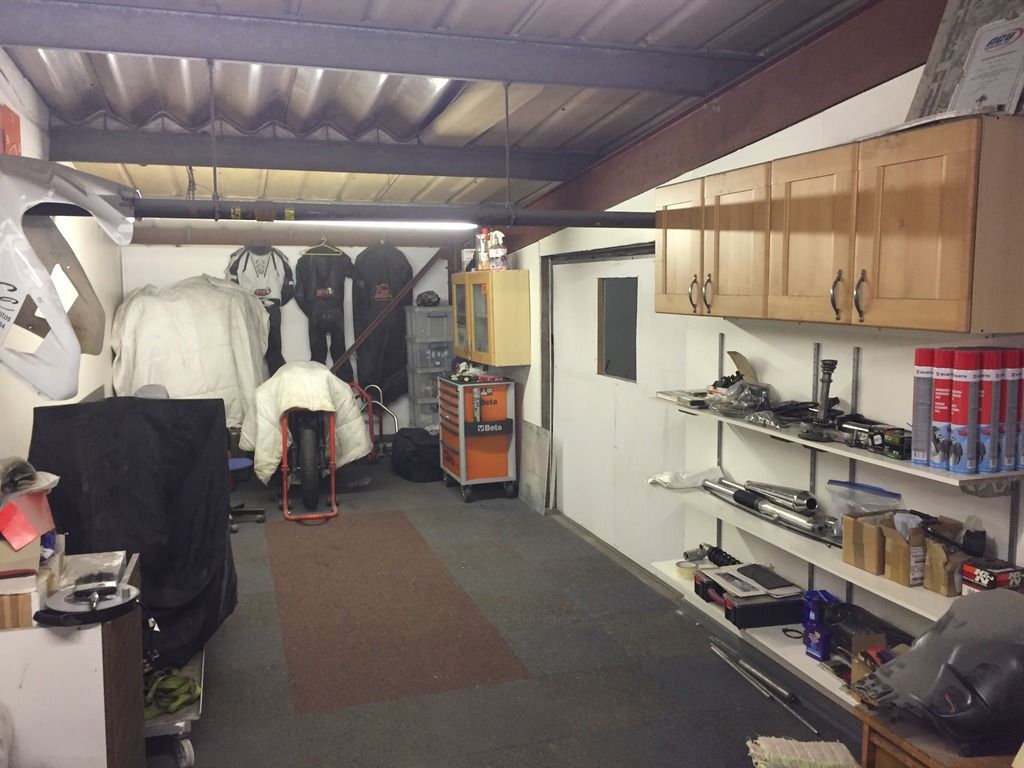

Ive even tidied my workshop up to make it a bit more inviting
