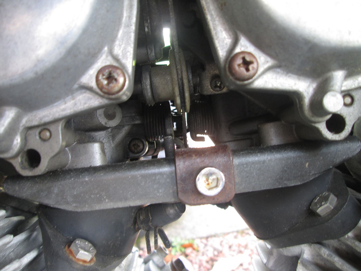

Ah could be Jimmy I was going by what I was told off a mechanic,and read it online too in the MCN road test review. They could be upped in power with free flowing and tuning to get over that though. But as you say the dyno does not lie. Just out of curiosity where are the washers placed to restrict it?? are they on the carb side or the exhaust side?? because I never checked for restrictor kit when I replaced standard exhaust nor when I fitted the carbs.This as you may have guessed could be part of the problem with this bike Cheers Dood !!!! On second thoughts the exhaust side was clear of restriction as I dug out the old seals and replaced with new ones.But I failed to check on the carb side as I simply removed the faulty ones and replaced them with the rebuilt items. Leaving the manifold rubbers in place. You know the more I think about It the more it could be that THAT! is the solution. I'll keep you posted many thanks Jimmy bud.
The mechanic made up his own restrictor kit. It is on the carb at the throttle cable
That looks a bit crude Jim, take it off he'll only use the power he needs, & it'll be saver for overtaking.
Crude but effective Tommy, it got him through his restricted licence. With it being a twin, it has the torque for overtaking. If he asks I'll do it
