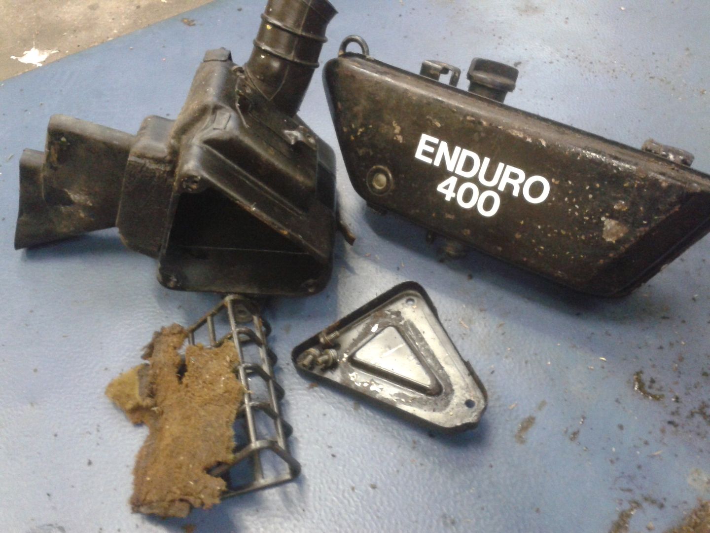

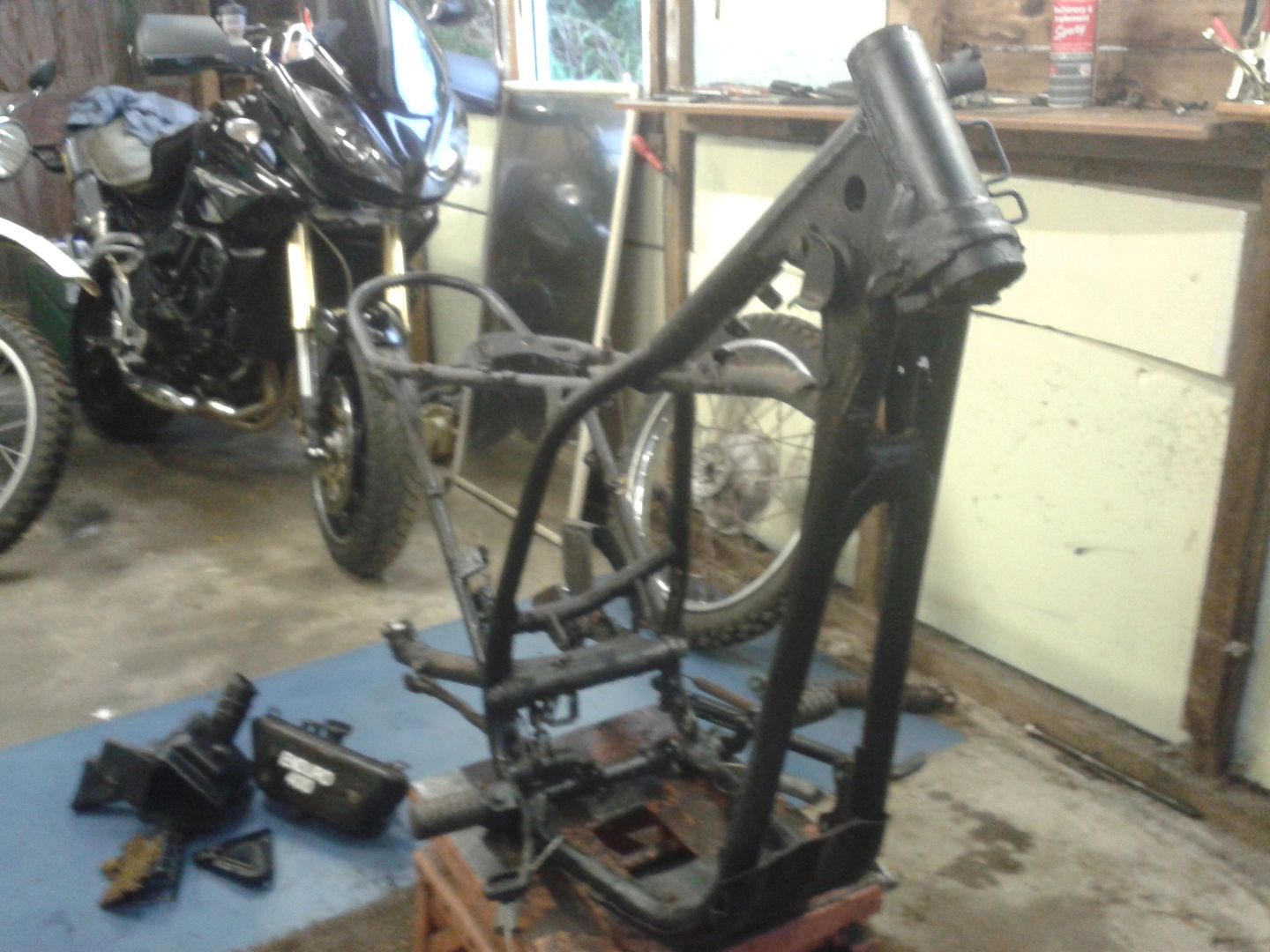

Stripped to the bone,  air filter disintegrated after 39 years,  [  lots of original bolts & rubbers ]  loom complete ,  head bearings were dry paste, but seats are unmarked , [ new balls & grease]  as taper bearings are too tall, and the headlamp shrouds end up loose,]
Gonna paint frame, not a fan of powder coat,
Gonna blast it , then gloss black paint,  . am not a fan of powder coating,,  Stafford show next week ,  be on the hunt,,:yay:

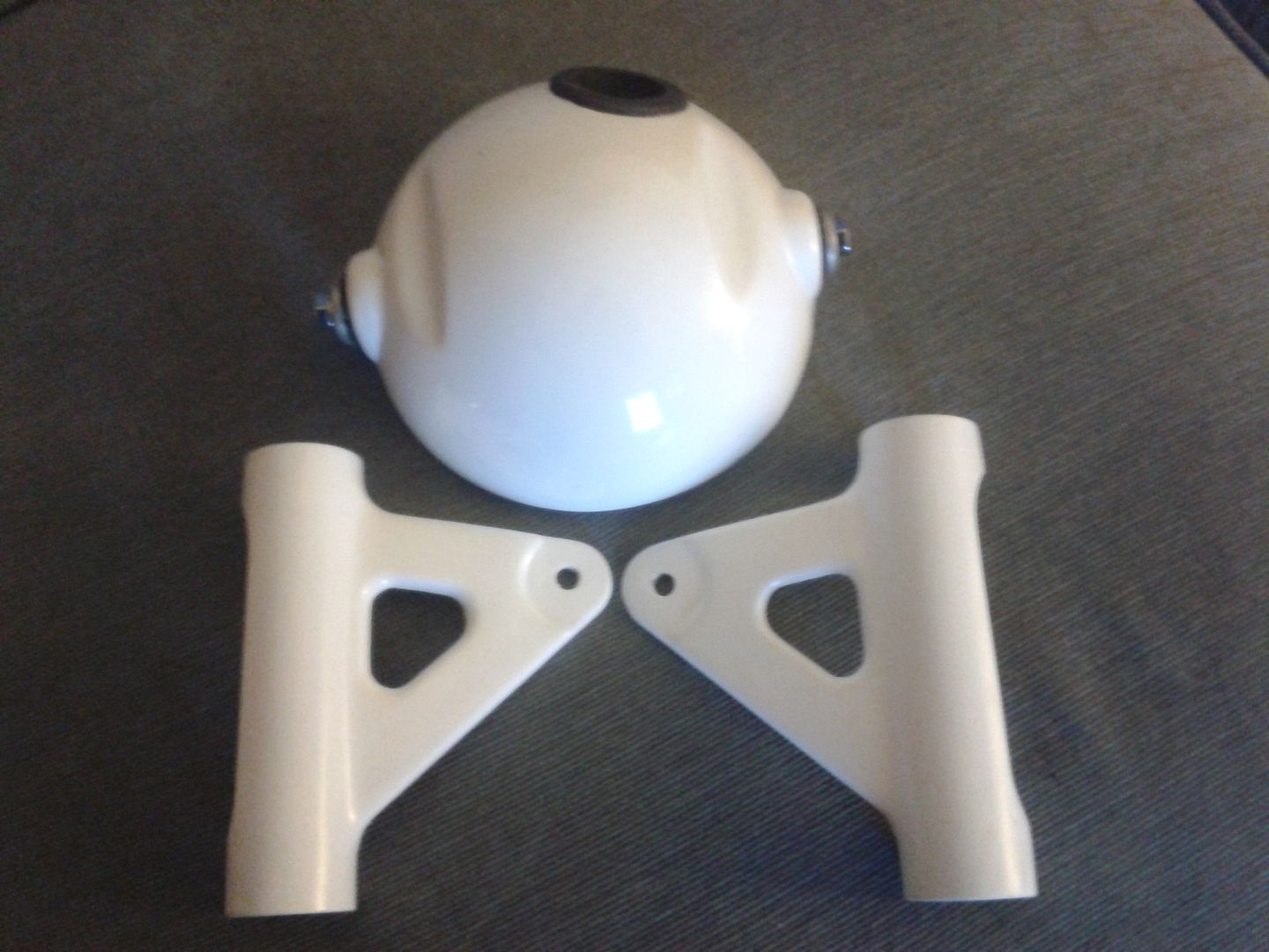

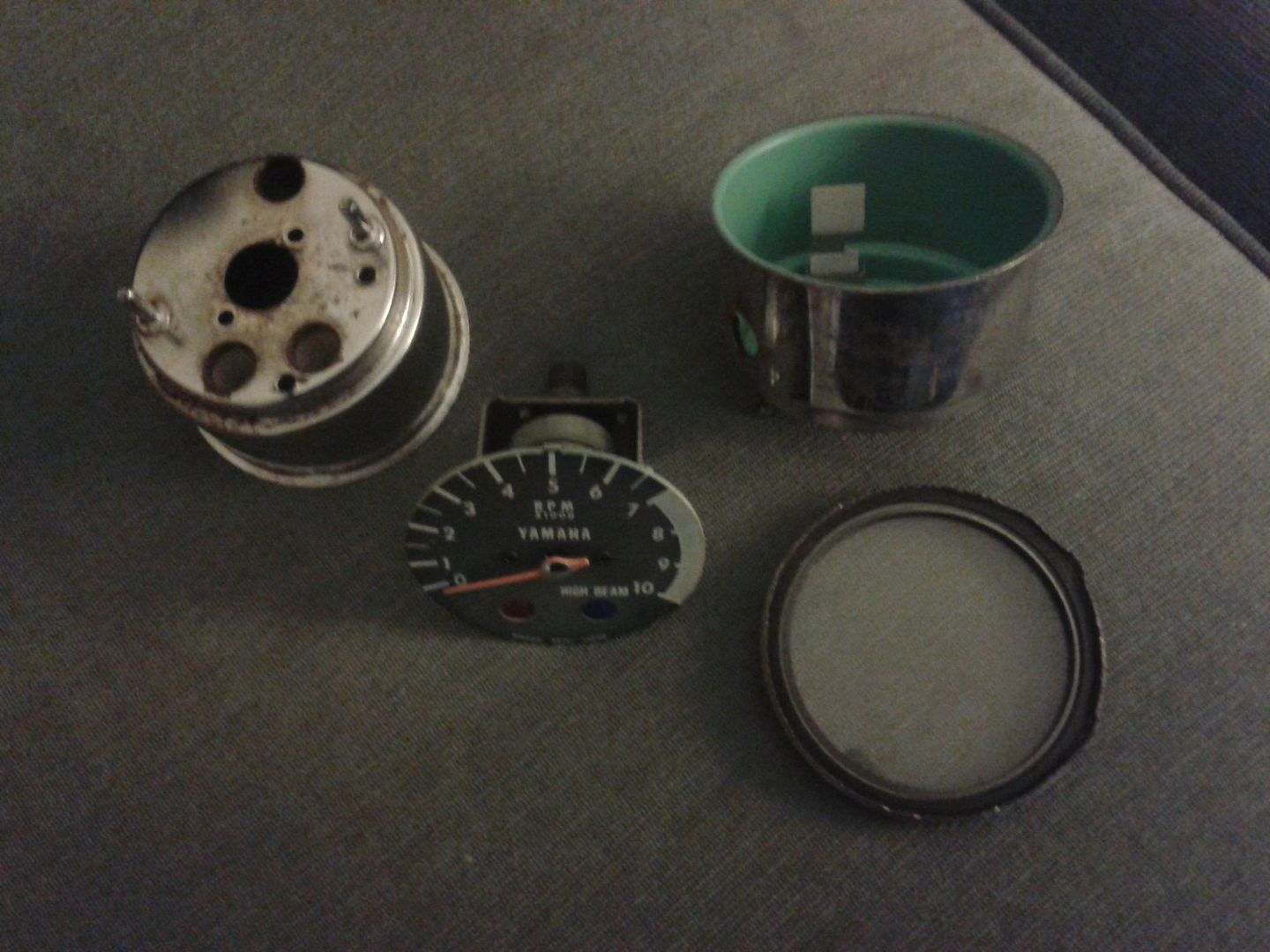

Ok "  here where were at,  Chrome time,   stripped speedo & tach,  slow tedious job,   frames painted ,   ,,

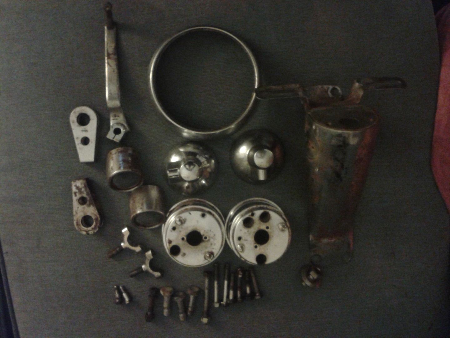

Rebuilt the clocks, and some shiney stuff back , 1 week turnaround, , service for yeh ,Agbrigg -Leeds,
That looks like a nice job, was it expensive?
That lot in picture, " unchromed picky "  [ Thers a gt500 tail,light, too]  and a heap of bolts ,  £150,  postage included, [ both ways, ].
not polished yet jack ,

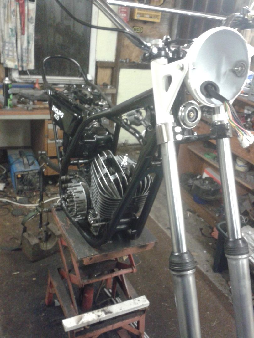

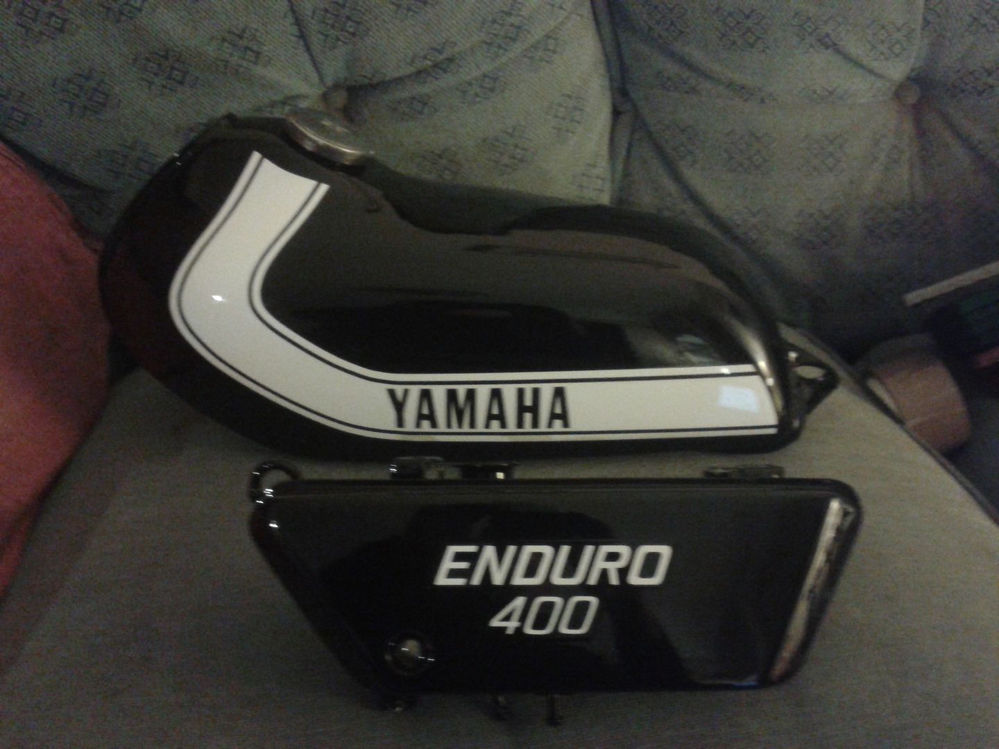

Shed time lots done,   ,, paintwork done -new seat, engine in ,[ alloy fins done to factory spec, .that was a chore, ;:eusa_doh:,]

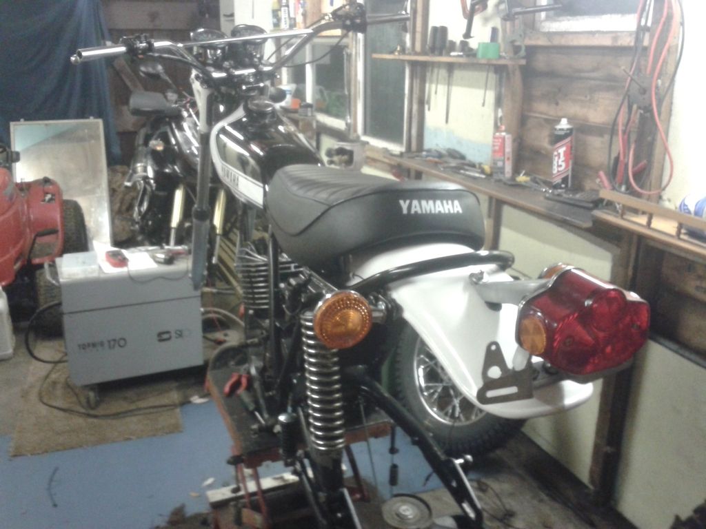

Bit more shed time,.  wiring loom on , Rear fender ,[ that was a task] ,  tried on the fineries to see ,,:rolleyes:
