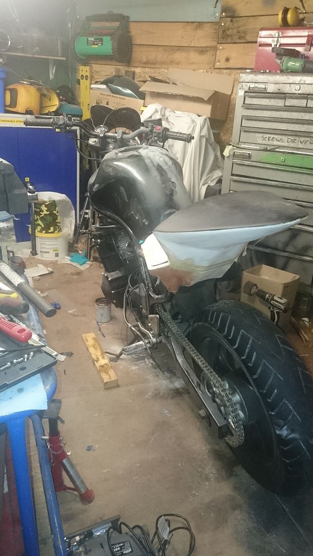

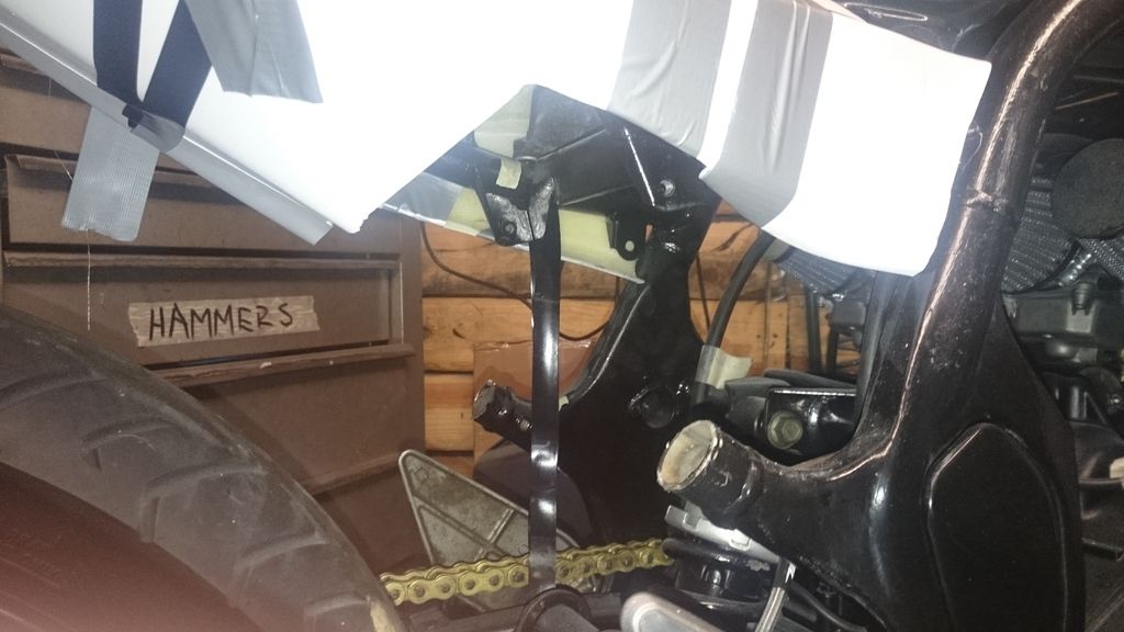

Busy night tonight, so scary taking the angle grinder to the sub frame but needs must and now the seat unit is duck taped in place awaiting the steel tube to arrive to rebuild the frame.
Little update, got new steel bar and tubing to re make the sub frame to secure the seat, I just need to take the bar into work and shape two slugs on the lathe to fix it all together.

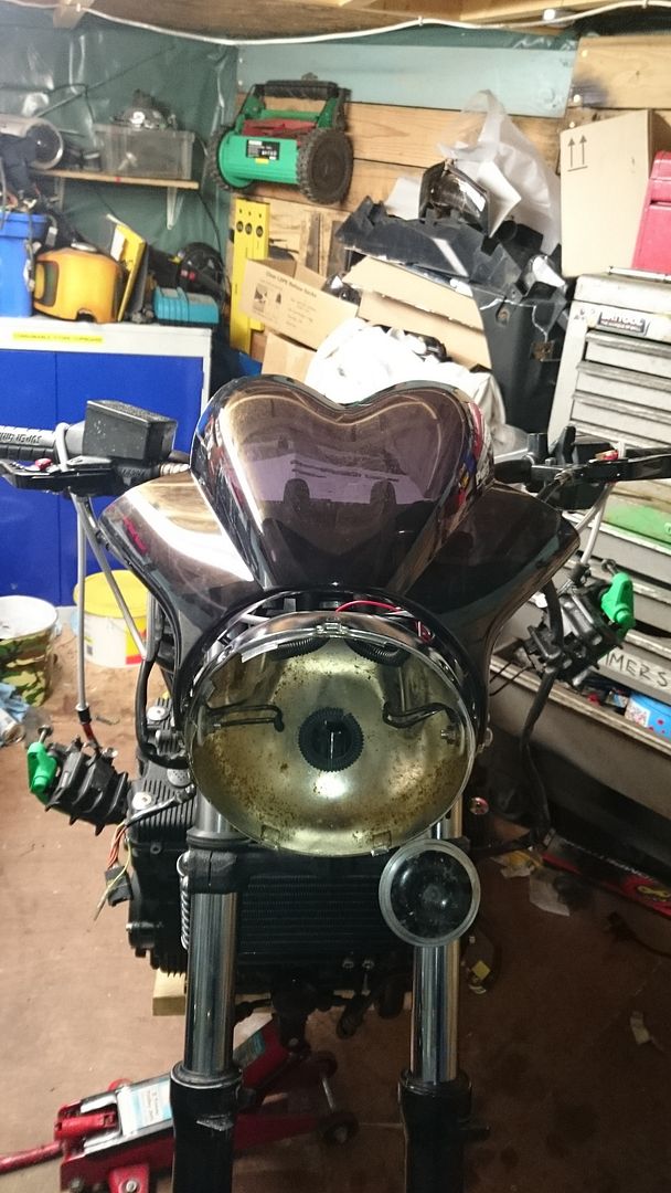

Also had the sexy new headlight screen delivered today and had to fit it as soon as.
All the way from Germany

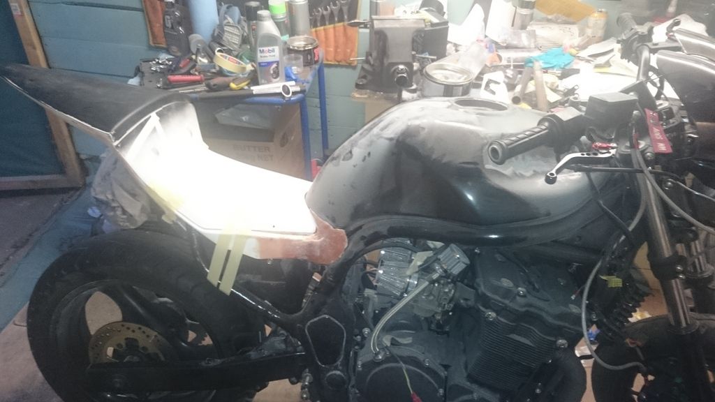

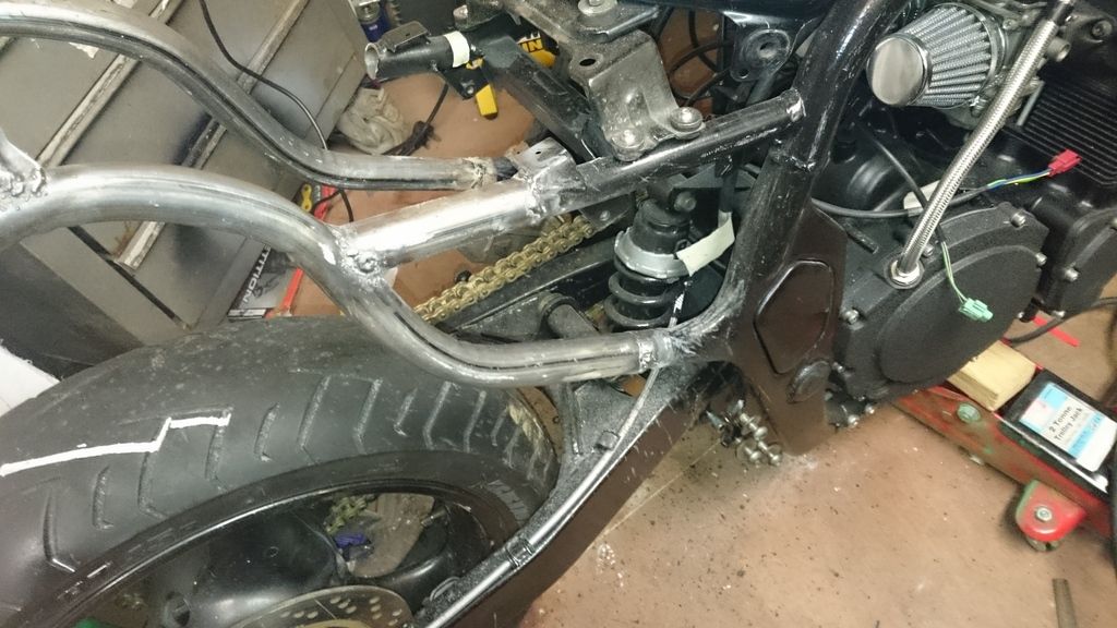

Finally got hold of a pipe bender and tried out the new welder to tack it in place, and I'm pleased to say that the tacks are good enough to take the weight of my fat ass.

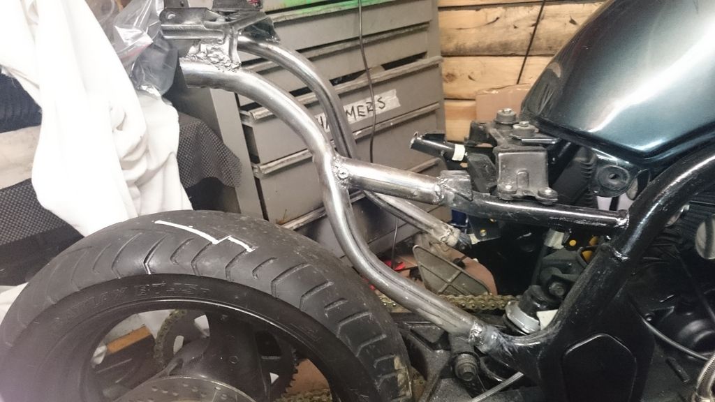

Little more done tonight still getting used to the welder and it's best(ish) set up but atleast I can lift the rear of the bike up without them snapping.
Cross strut in place, one more to go.
When I was an apprentice, we used to call that type of weld a 'snotter'
Did you put slugs in the frame

hopefully hollow ones. really needs holes drilled and weld filled too onto the slugs

Yer i can see why you called them that, not the neatest way to weld im sure, think that when i move house next year and get a bigger cave i will up grade a fair few of the toys. I slugged the frame with 1" bar top and bottom.

I did not know this tho, as i have already fitted the slugs and welded the fram over the top, is it a good idea for me to drill 1/4" into the slug and plug weld the hole up or will this just inadvertantly make the slug/frame weak in that spot?

with the slugs being solid, there will be no "give" in that part of the frame. You may find the frame fracturing where the slug ends inside the tubing.
I would still drill the outer frame over the slugs so you can get some weld onto the slug  there or you will get movement when the frame flexes

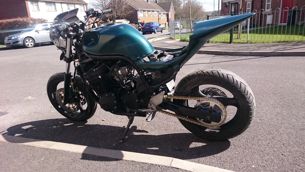

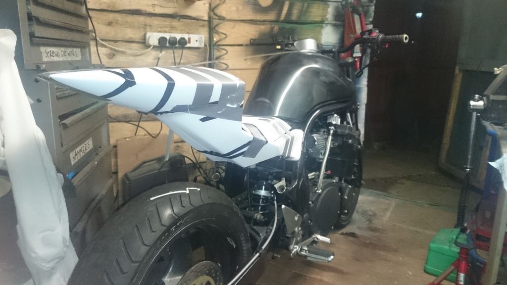

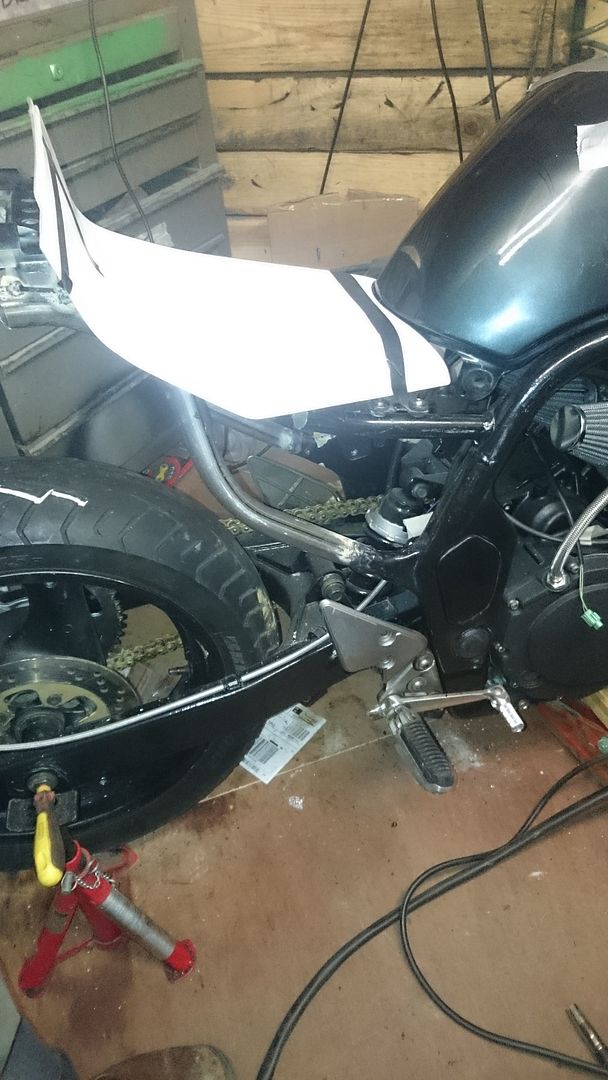

Here be a few piccies for you all.
  • 3 weeks later...

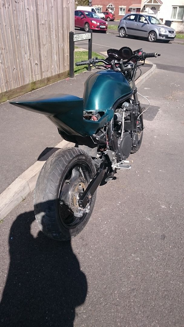

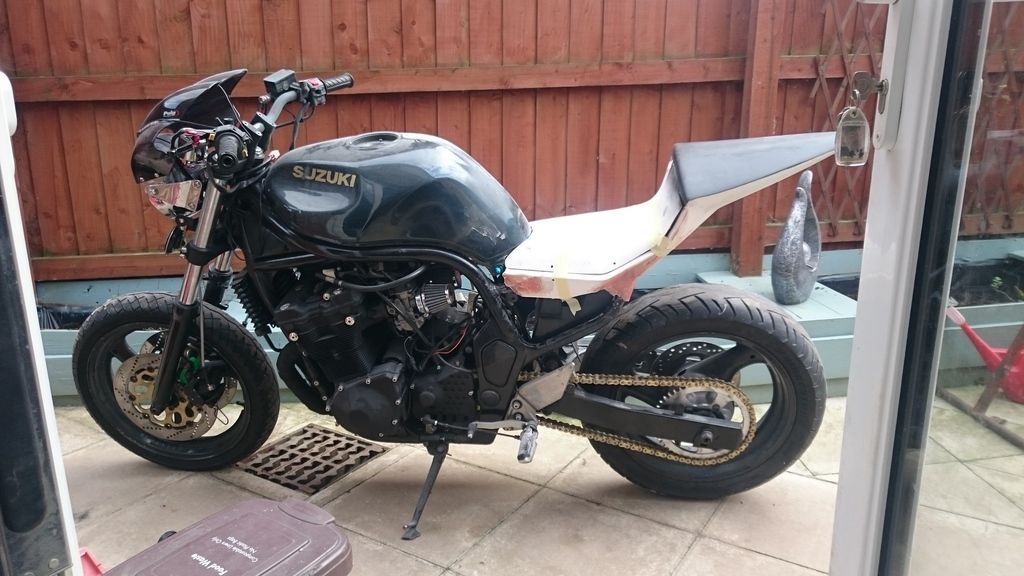

Got some light at the end of the tunnel today. Took her out in the sun for a little wash as she was covered in dust. Just waiting on the seat bracket to dry then do the rear brake and the electrics and hopefully have her started next week.
