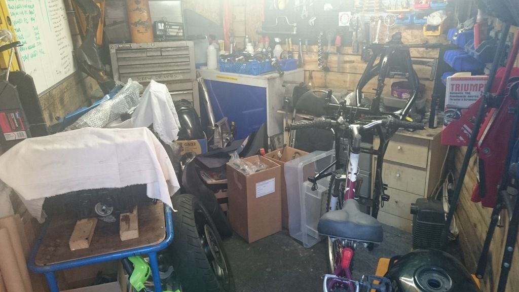

As it sits now in the shed
Gotta go out there during the week and sort through it all.
The motor is perfect, all new stainlesbolts
I have basically just got to buy a few more bits,paint it and assemble her.

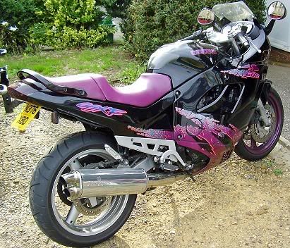

Here are some pics of the old girl, if my back had not gone I would never have sold it......Still miss it TBH. Had plans for more mods but.
See looks near stock, NOT!

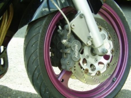

Stopping was an issue till I fitted these :D.
Looking at them chicken strips I was not wasting much of the tyres either. Well matched front and rear.

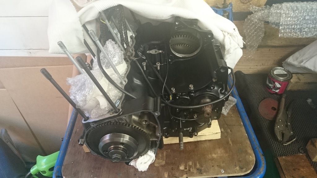

So, the motor is all done and finished and in the frame now (pics will follow tonight) and the frame is nice and black now. still got a fair few bits to sort out before she starts up which are:
