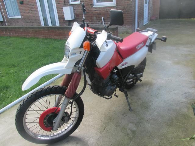

Oops missus went out shopping. Accidentally bought a ebay 91 Xt600e when mrs went out shopping but needs rear pads. What size tools do i need to do pads before 200 mile ride from middlesex to manchester.
Regards Simon
Basic tools simon, av just done my tiger, Allen keys plyers - get a can of brake cleaner , and tin of Copper grease for the back of pads, [ anti squeel] :thumb:

Here you go Simon
Whitch is an easy clean,, give the pins an emry & light grease , they"l be little rubber boots, take care not to tear them,, :smash:
Took the 2 bolts holding caliper out. All very slidy and looks maintained. Inner pad on limit outer to the bone. Missus has cooked me rump steak dinner. So forgiven. Thanks for posting piccie.
