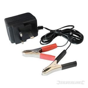

As Preload says the battery is PRE-CHARGED at the factory but it needs to be fully charged before you use it, 2 hours at your mechanics will not be enough to get it up to full power, you need a motorcycle battery charger as well DO NOT use a car battery charger or you will cook the battery. $%28KGrHqJHJFUFDyp0qUHYBQ-WptL9l%21~~60_Something like this if you can get it. It's a trickle charger and only uses about 500millamps.
They are about £8 on ebay.
