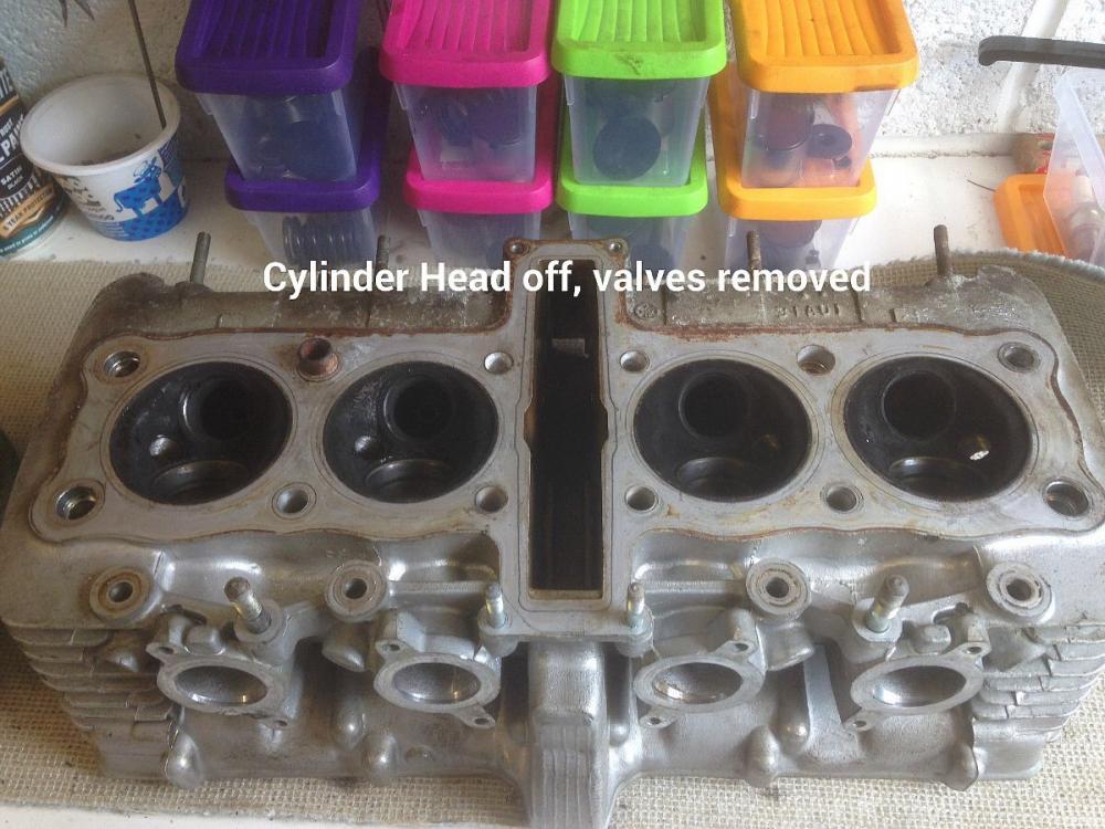

Hi everyone, here's an update of my progress this summer. I know it's slow but I'm also building a dry-stone wall and deep into other DIY stuff.
Anyway, I've now got the swinging arm (new bearings), rear suspension, steering head (new bearings) and both wheels (new oil seals) all fitted and she is standing on her wheels again.
Next jobs on the list are grinding in the valves and rebuilding the rear brake callipers and system.
