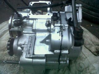

got it out and the threads all in one piece engine came out so easy after that! ive spent hours getting the piston parts out so happy i don't have to split the engine, managed to find and get the bigger parts out then i filled the crank with 2 stroke and the smaller parts raised to the top then i poured it out going to do that a few more times to be on the safe side but it turns over perfect! had chance to clean the engine up it looks so much cleaner now going to order a piston kit and hopefully she starts! :spin2:
