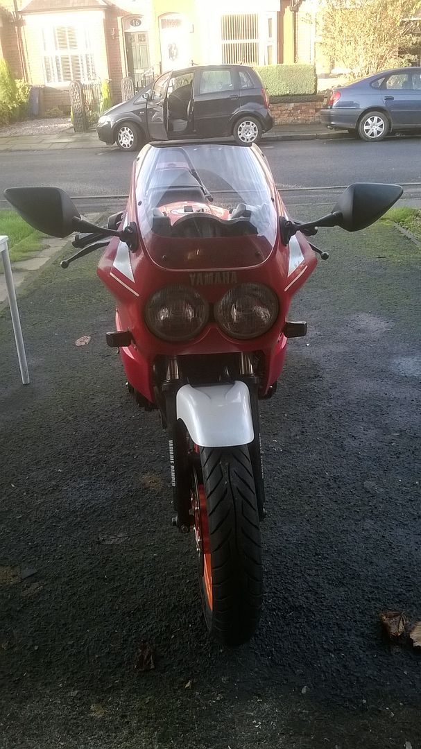

finally ditched the useless rear mirrors and fitted some cbr600 ones.
had to keep the brackets but at least I can see behind me and they look better IMHO
looks good Drew, you'll be able to see me a bit better now, You should get magnified mirrors so i'm not just a little dot!

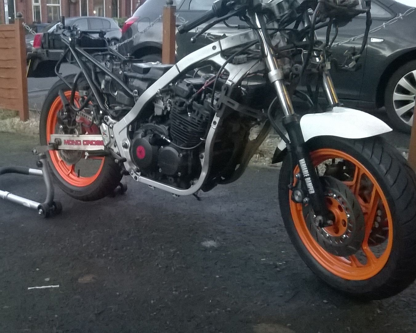

bike partially stripped for frame powder coating.
625ef4e7-7021-443c-b7f4-039bae821074_zps
drained the oil as it was warm, will drop the engine and store.

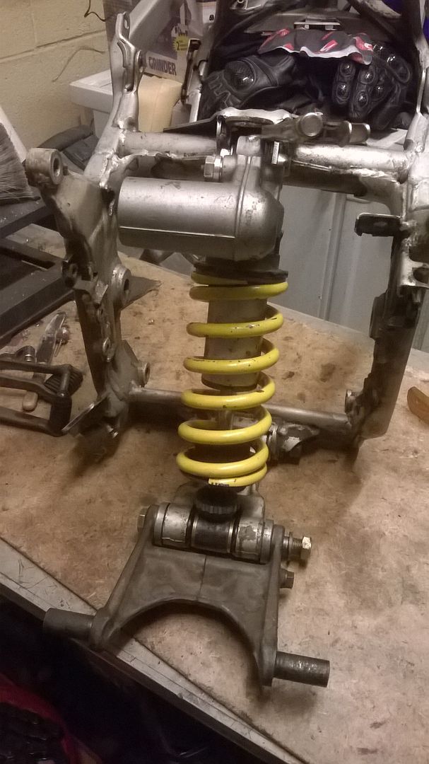

just need to see how I can mod the brand new Hagon shock I got as it was originally for a cbr600. (unless someone wants a swop)

stripped even more of the bike today. just the engine and and little bits to go.
I was mainly messing with the new shock and coming up with a workable length.
Can anyone lend/sell a YPVS dog bone links, i just need them to see what I can achieve with the height. or failing that the actual length of them so i have a starting figure?

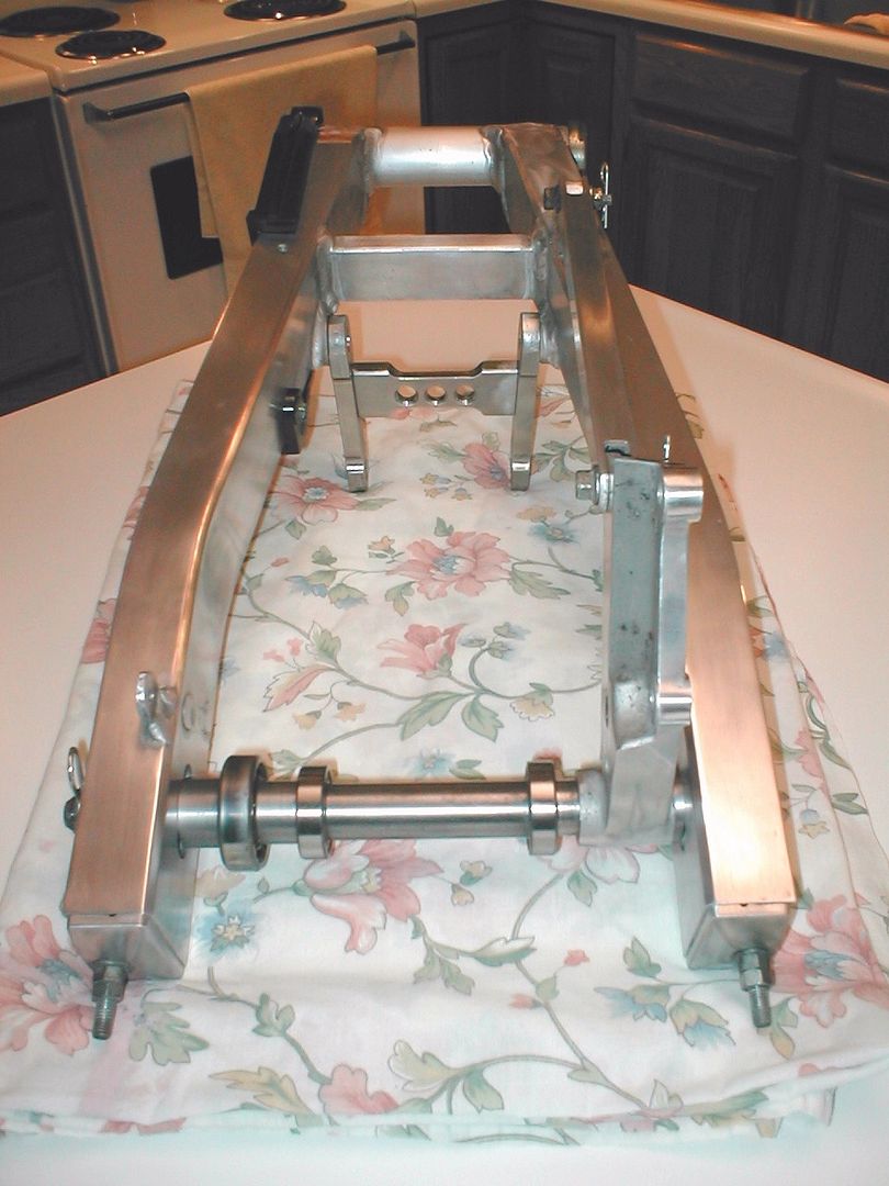

look like these

well I've decided not to go the CBR shock route now, too much hassle. It is going to be cheaper to get the original shock rebuilt!
so I've put it on the market to sell.

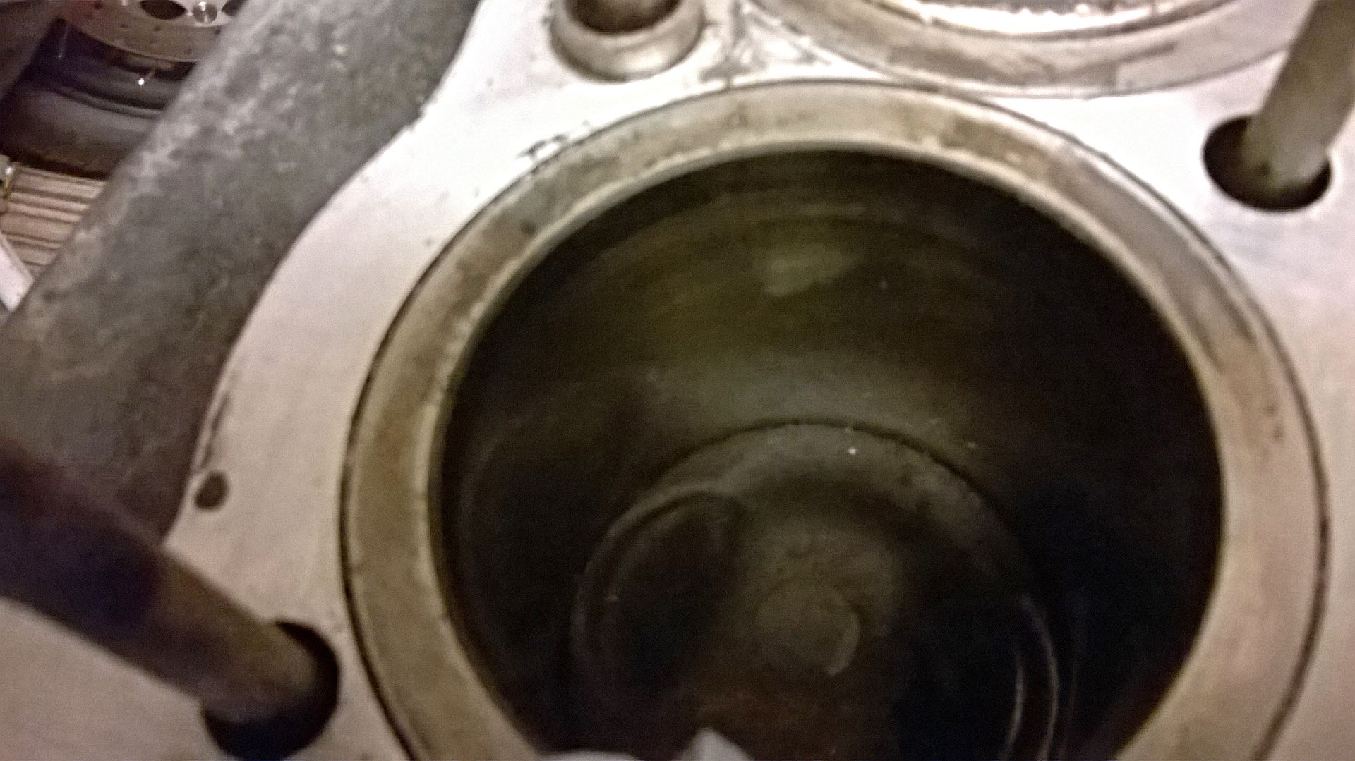

took the head off today and it was fairly coked up. cyl #4 was running slightly weak.
when the head was off this greeted me :(
now I have a spare barrel from the FZ engine, but the bores in this still have their honing present
maybe i can get the liners changed over into the fz barrel
thoughts please?

Bloody ell drewps. a crack" cylinder 4 lean ? was valve burnt ? is that where the weep was,
not it was #1 that was leaking
not super weak by any stretch just a tweek needed on the carbs. I think that the PO crushed the rubber O ring as it was really hard to pull out and was peened over

decided to trial fit the R6 shock I got, def doable. make an adapter for the top of the shock to clear and hopefully I can use the YVPS dogbones as the original hits the rebound adhuster.
can someone please, if you have a YVPS, measure the swing arm bracket length and inner diameter?
someone did a lovely CNC version
