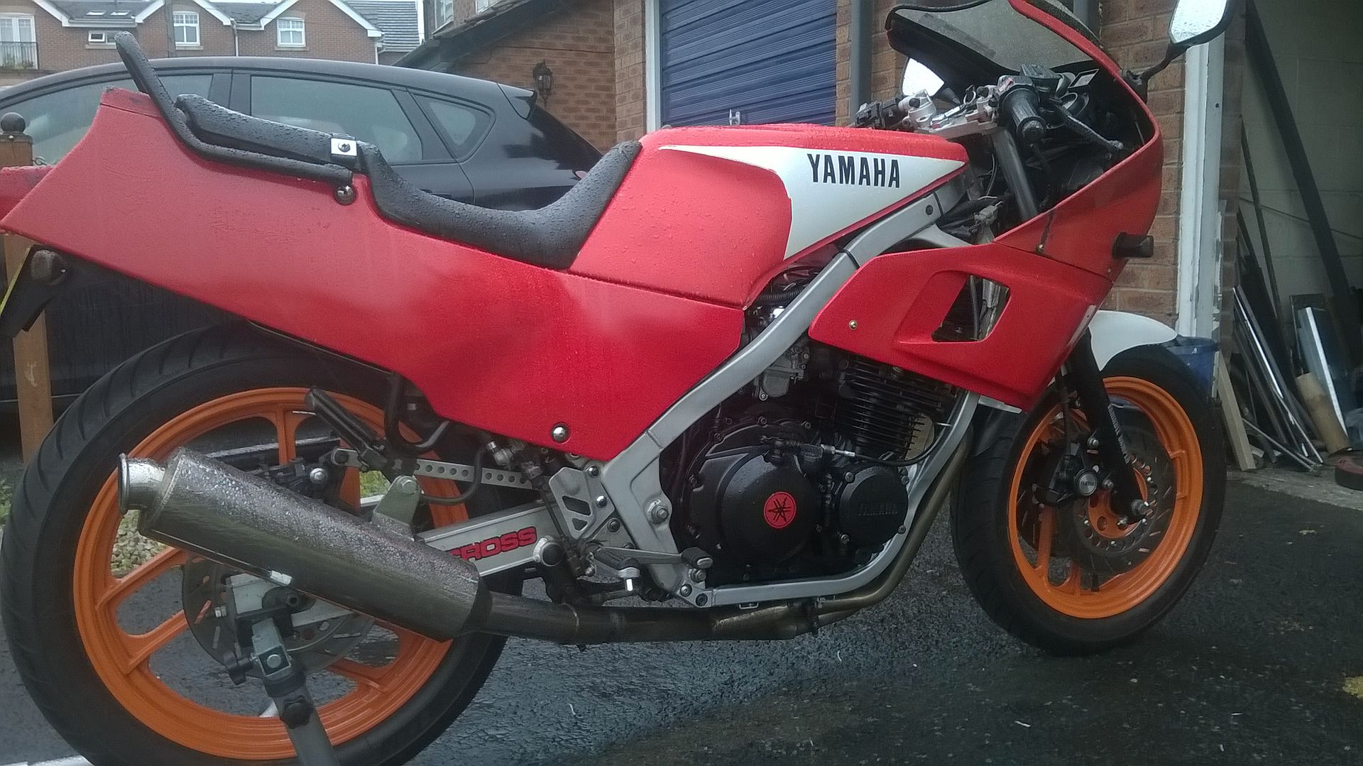

Managed to get some clear on, but still needs flatting and polishing up.
looks a lot better even though I only put it on for Squires. going to strip again and get it properly painted in the Gulf colours when funds allow.
think I like the top/mid fairing, but put a belly pan underneath in alloy
It's in one piece and it runs,you want glam after what happened to little G,,,,it looks ok and you got to beat it now it owe's you for the grief it caused, would have been done by now if it had not.

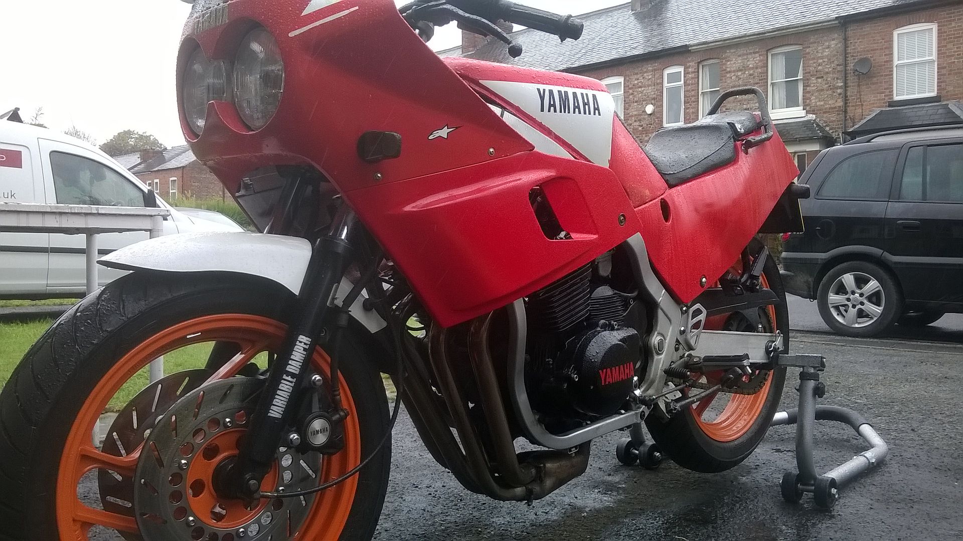

when I got back from the weekend, the right fork was very wet from the fork oil.
so usual thing, I'm just going to totally refurbish the forks and tick another bit off the to do list for later. new bushings top and bottom,new fork seals and dust seals with 20 cwt fork oil (normally 10 cwt)
springs are a bit sett, but ain't got the dough for new yet! (easy to put in later)
Did the misses take the cash from the insurance for the G and go shopping :hah: .
Going up to 20w seems a bit much to me I would think 15 would be better esp. cause it's getting colder.20 might be a bit stiff in the morning or add a few extra mil's of oil.Or same weight oil with a bit of preload via a shim on top of the spring
Brad who does my forks is like a surgeon when it comes to oil amount,he swears 2mm of oil is all it takes to change the feel.as I have said before I just can't duplicate the way he does mine,even if I follow the info sticker he puts on them,but I have a sneaky feeling that he mixes his own oil.But who knows he wont let anyone watch him work his magic.And thats fair he is the guru
talking to the racers at the weekend, they put in 20 wt oil and 120mm air gap.
yep, the missus took my money and went on holiday with the kids. I don't mind as its keeps her sweet and I can carry on with bikes as always. :)
Ha happy wife makes for a happy life LOL.
Ok but what weight are the guys you talked to ,setting up suspension oil level is relavent to rider weight.I dont think they were trying to steer you in the wrong direction but thier is alot more to getting a OK set up or a HOLY DUCK that feels great. Given that the fz didn't come with adjustable pre load or rebound,, oil level and shimming the springs is about all you can do to adjust for rider weight.
A 120lb guy on the same level and oil weight would have different feeling than a 220lb rider. So it's not realy a 1 size fits all thing.If there are no good suspension guys to talk to then trial and error are about all you can do. At least oil is not a expencive or hard thing to change if you don't like it.
Good luck hope it works out
your forgetting that the FZ has an adjustable cartridge emulators in there, the boys also said to shim the spring as much as possible but I'm leaving that one for now.
20 wt was ideal for my xs400
well I did a mix 5 oz of 10w and 6 0z of 20w, runs a dream and nice and taught front end, which now lets down the rear shock :eusa_doh:
Lol funny how that works you don't notice how worn something is till you fix related things sometimes,so guess your now on the hunt for a low mileage shock.
Was it my suggestion of mixing oils or you just hade enough of both left over from other fork rebuilds that you decided to go that route?
