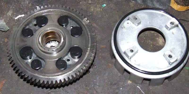

Paul panic ye not this is a cluthc stripped out all that happens is the rubbers wear/shrink over time here is a pic.
I asked Writebike once how much play is too much, his reply was as long as it is not spoiling your enjoyment of the bike there isno problem,it will just get sloppier not go completely

Yes Paul that is an RD one but i hope yours is the same as you say, I stripped that one too see how it went together, it stopped me worrying about 1/2" of slack on my 400, I dont know if the DT has the same rubbers in it but Nigel kimber has replacment rubbers, and you can thread the holes and fit bolts with loctite instead of rivets
Cheers Merv thats made me feel a lot more at ease with it, I will try to get a replacement first in due course and maybe investigate this one later, theres not too much slack certainly not 1/2 inch.

I doubt you will find a secondhand one much better, I reckon under a 1/2" is nowt too worry about, the one i got too replace that one on the 250 seemed free of play til i fitted it, then i got 1/4" too 1/2" of play, when you find a replacement you may not be able too turn it by hand which will be a good sign, but clamp the smaller cog on the back in a vice then try you will find the play that way,
