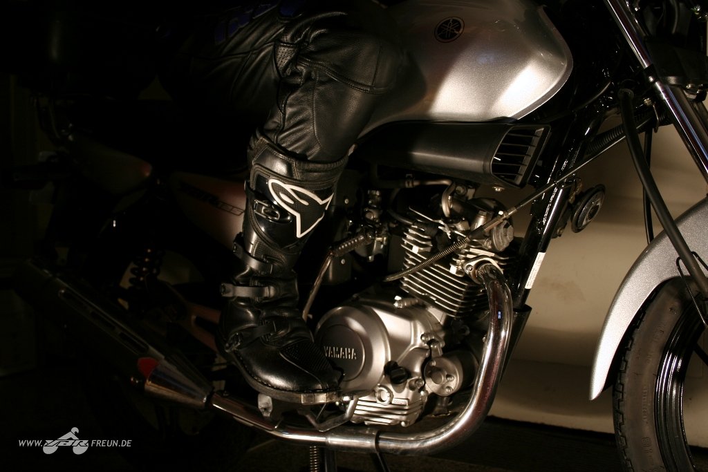

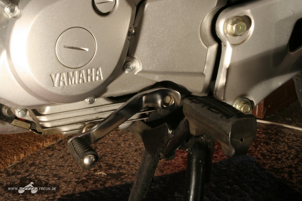

To adjust gear lever Convenient switching without contortions

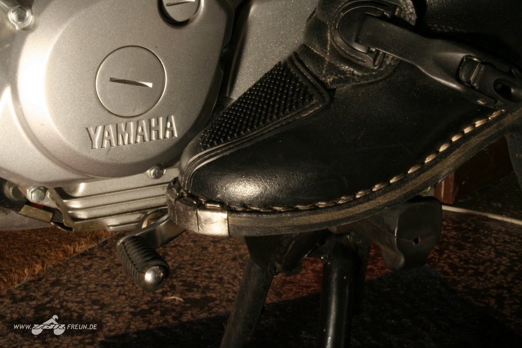

Since the purchase I get annoyed when shifting a little. The shift lever is not actually incorrect: If you were to push the boots to stop the heel to the front, I can easily shift down.
However, the upshift, I have a strong tendency to bottom, the toe of his boot. At slightly bulkier boots (like the Alpinestars on the image), it is actually impossible to turn without contortions reasonable or the toe of lower back enough after the upshift.

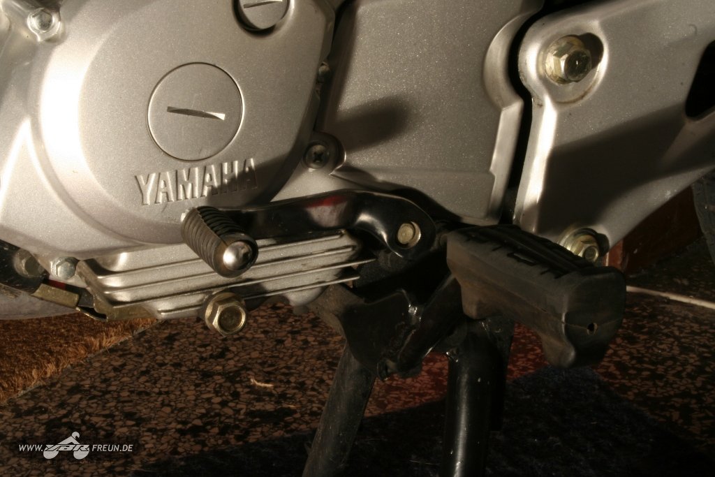

Previous shift lever position my YBR 125
Kinking of the boots cumbersome or impossible
I've looked at the side shots of some YBR 125 on the internet. If it's not just the data published by a learner presumably before the first use advertising shots of driving schools, the shift lever has been placed at least one notch up. The problem seems therefore to have not just me?
Even with my tour boots I had begun to turn to the very end of the tip. That did not turn to any attempt been successful, was the unpleasant side effect. well.gif
In this setting the shift lever is one of the easiest adjustments that are possible on the YBR 125.

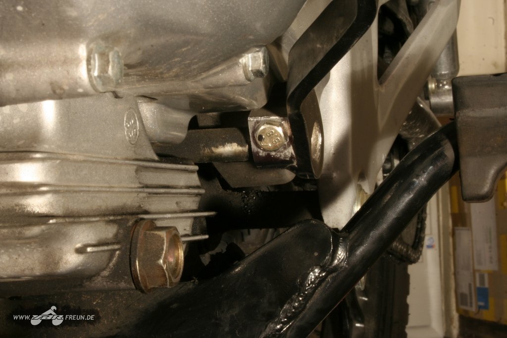

Shift shaft at removed shifter
The teeth in the gear lever
In order to find it for a personal best position of the shift lever to set the machine best on the center stand (if available, the newer models have indeed "only" have the side stand).
In normal sitting posture of the foot or boots should then be advised of the catch, both on the rubber of the shift lever loose and without twisting and putting down the boot.
That's the theory, but I seem in terms of my feet and my shoes do not quite fit for YBR 125. Either I have with shoe size 42 too big or too long feet, or I'm just a little awkward. well.gif

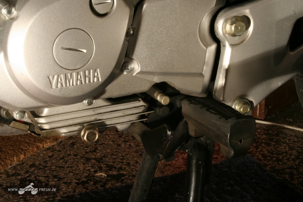

If the distance between the footrest and switching role only about 2 inches longer, I would probably get rid of all worries and problems relative to the engagement. Unfortunately, the YBR offers the only possibility of setting the displacement of the shift lever to. Anyway, I have decided to move the lever once by two teeth up.
Two teeth upwards affect so from
10 Nut and away you go
Should it happen to me then after a long ride too high, I can still go back by one tooth down. In the picture it looks the way still higher than it is in reality, probably throws which the rubber from the shift lever for the shadows.

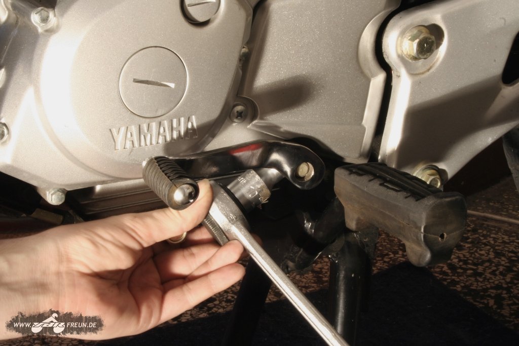

As can be seen on the screen below, the shift lever is held by a bolt on the selector shaft. A change of the position of the shift lever does not really require much more than a little time and a nut 10 together with ratchet or ratchet.
Detail of the screw on the shift lever
