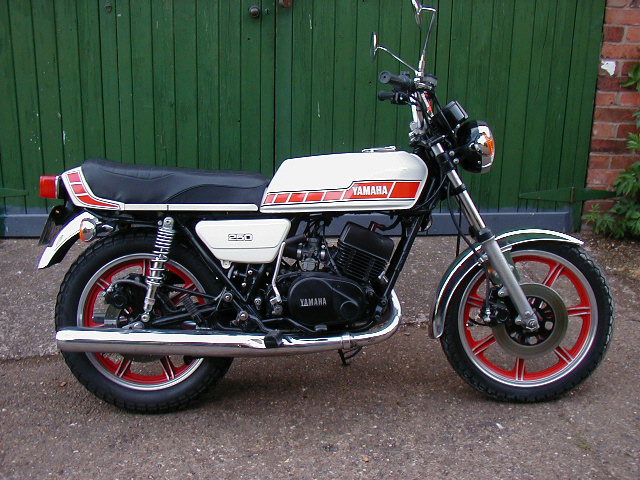

ok Dx is a much used abbreviation for all the twin disc 250,s it never really existed as such you had the Rd 250 then the Rd250 A/B which had rounded tanks then you had the coffin tank C/D/E/F. the C had no tail fairing on the seat, but the D did front footrests were on bar under the engine rears on a pressed steel plate bolted too the frame and these had points ignition, E/F the E front footrests on brackets each side of frame rears on welded on loops, CDi ignition f was only subtle changes from the E the list of differences is far to long to go into here but sign up over at the aircoooledrdclub and go too the hot topics section to see agood guide to the models and also more than you will ever need with the RD, s

this is a c model
this is a D model
this is an E/F model

Sigh dribble dribble......... If only i had a bigger garage. Whats with the front muddie on the gorgeous white one??
that is a cheap nasty instant rust pattern mudguard is what is up with it. got some here, junk. original front muddies still available from yamaha, for about £55/£60
