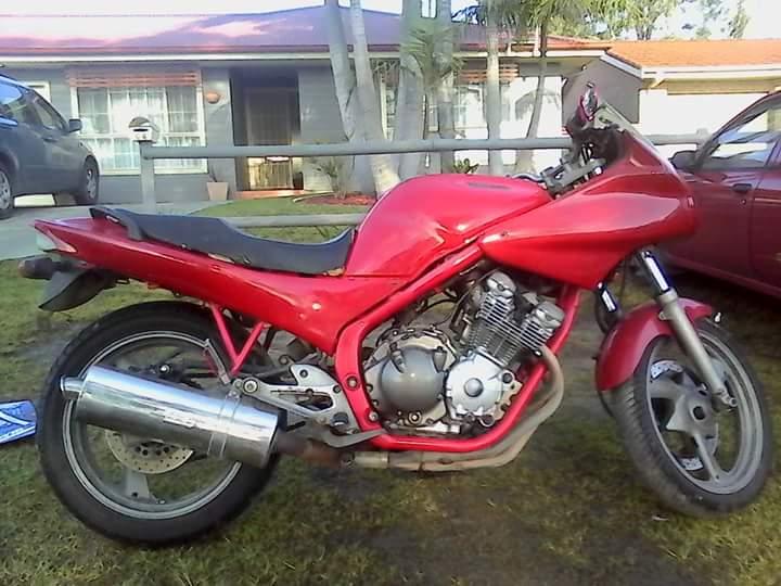

Posted October 5, 20159 yr Hi all.. i am hoping you can help me.. i have just got a 1992 XJ600 Seca II for a project bike (basically to learn on) and need help.. i tried to start it today after i pickup it up and connected the battery and hit the starter button. this resulted in the Starter motor spinning a humming noise (zzzzzzzzzzzzzzz) and never got close to starting the bike, or engaging the flywheel Yes i did buy the bike and have not heard it running as the seller did not have a battery but did say it had a stater issue. Would this be a simple fix like pulling the started and clean then refit, or from experience could there be more. any idea's ?? l would like to get it started before i start throwing money at it.... thanks Andrew... Edited October 5, 20159 yr by andrewed1

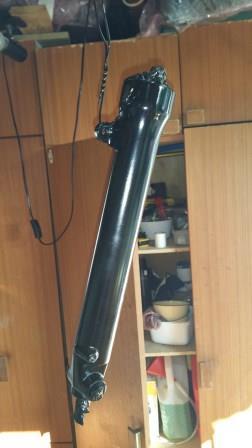

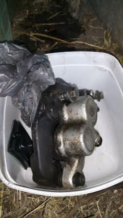

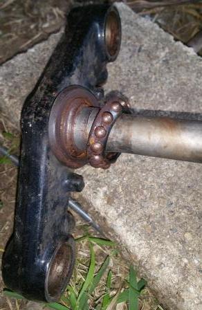

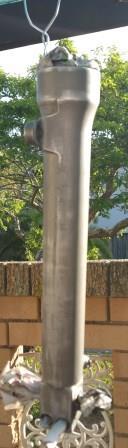

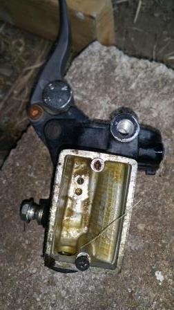

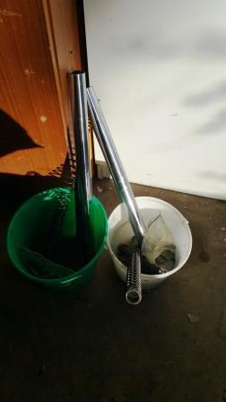

October 25, 20159 yr Author Well The fix up is going slowly, and the more i look at this bike the more i see what is wrong with it. I am glad i never tried to bump start it.    Ah Well..... Anyway back to the good part of the bike "Fixing things". 1) As previous posted pulled the forks of and needed the damper rod tool. I followed the instruction from the Hayes manual. I Purchased a length of 5/8th square tube ($6 aud) and a 24mm hex bolt ($2 aud) and inserted it into the tube and got it welded at a local factory (free).. Worked perfectly... I should by a welder to do this myself... Photos to come of the tool Here are the forks stripped and dripping in separate buckets (1 for each side) Decided to at least give the bottom part a clean so sanded them back ready to paint... Sanded Before painting After painting - (looks a lot better) Now Just to clean the tubes of the pitting spot and wait for the arrival of the new Seal,bushes and dust caps to rebuild them.. 2) Next I striped the head-stock to check it out (since the forked where out) to me they look pretty bad. So order a new kit from pyramid parts Australia. 3) While i was there i pulled out the front caliper and M/C. looked like the calipers needs a complete clean and repair and look at the M/C that is muck in the bottom... The Front Caliper The M/C Just by pulling this bike apart i do not think the PO looked after it and basically took advantage of my lack of knowledge..Once i get this fixed i will be riding by his house.... just to show off!!  On a good note got my bike learners to day to now ready to ride... oops need a bike hahaha. I will most likely have my full licence by the time i finish this bike rebuild. That's it for now.
October 25, 20159 yr Oh FFS that head stock has never been greased, at least not since it was in the factory, it's a wonder it never locked in place. At least the lower forks look better now (well done) if it was mine I would do the brakes anyway as the PO seems a bit of a tit. While you have it apart check that the brake hoses are not stretched or cracked, if they bulge when you apply the brakes they need to be replaced, I bet they were the originals, if you do decide to replace them buy stainless steel wrapped ones, a bit more expensive but give you a much better feeling brake. Nice job so far keep it up.  Something like this Edited October 25, 20159 yr by slice
