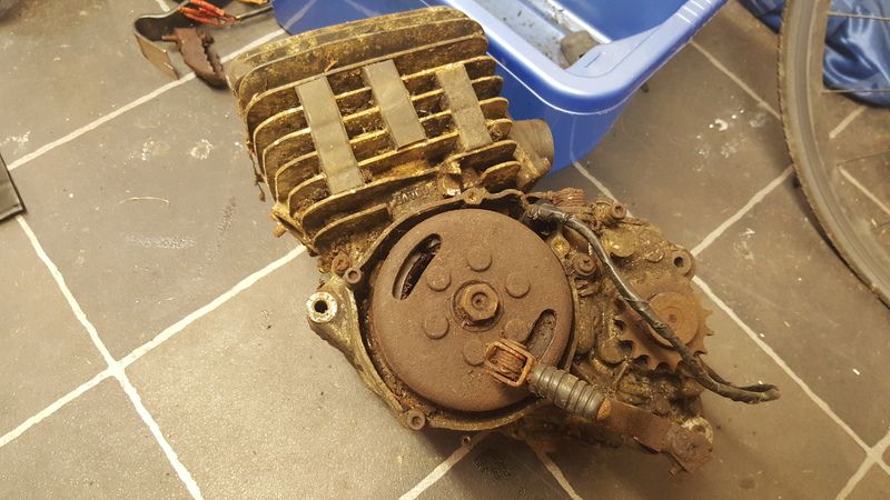

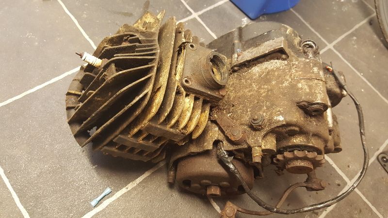

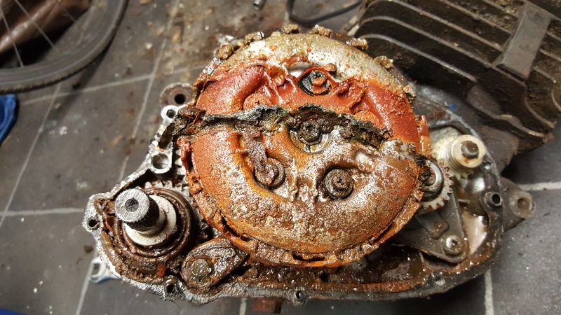

So, i was given this last year
It's a DT175MX 1979 single shock
it had sat in a garden for about 8 years (I reckon longer) on its side, flywheel up (without that side of the casing on) uncovered an unloved
The bloke who gave me it said he bought it with his paper round money an was genuinely gutted to see it go - cant see why
Anyways, as soon as i got it home took the engine out an left it as that

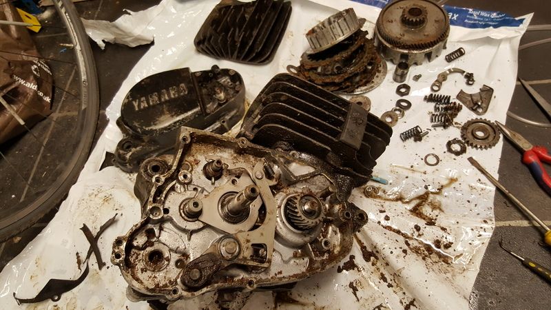

fast forward to tonight an thought I would attack it

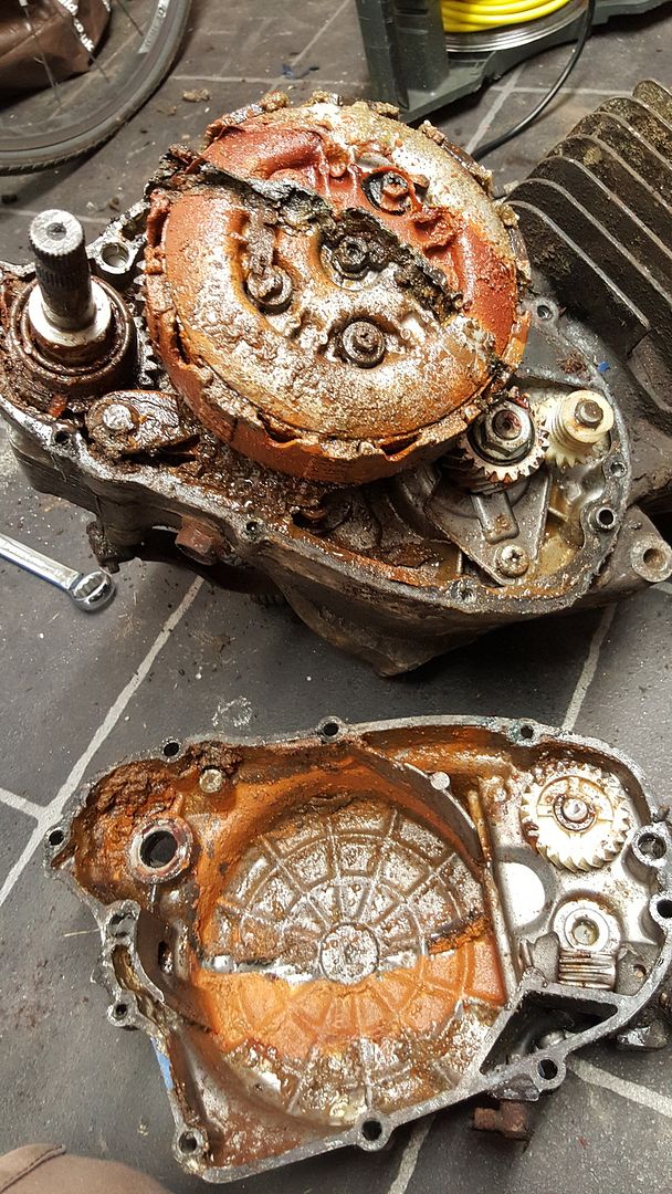

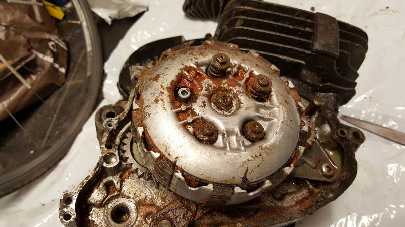

After fighting with rusted rounded off screws, I managed to get the clutch side cover off  8O    :cry:
I reckon it will need new clutch plates......

Yah think! Looks like the 2 Suzis I jut bought, nothing is beyond repair it's just can you be bothered. The thing is these little bikes turn into really smart little bikes when they are fully fettled.
Link to comment
Share on other sites
Ironically that engine will more than likely be fixable, engine rebuild is an engine rebuild.
Stripped cleaned new clutch and rebore, bit of vapour blasting and a crank rebuild and its as good as any other. Frame on the face of it seems ok. Sw arm is scrap but the shock will most likely be good.
Hubs too will likely be ok as well. No I don't think its a write off if your enthusiastic and the bike has sentimental attachment, like mine I have had it getting on 30 years.
But you can buy a working dt with mot for under 500 quid if you just want it running, can you rescue that with that amount of cash, ??

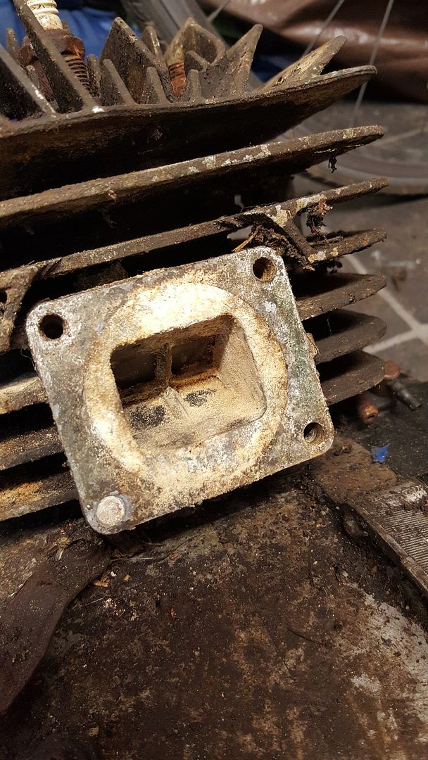

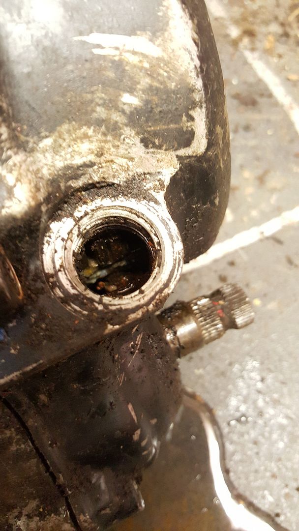

Bit stuck on taking the head off, one of the alloy "slugs/ bolts" is chewed to buggery. any ideas?

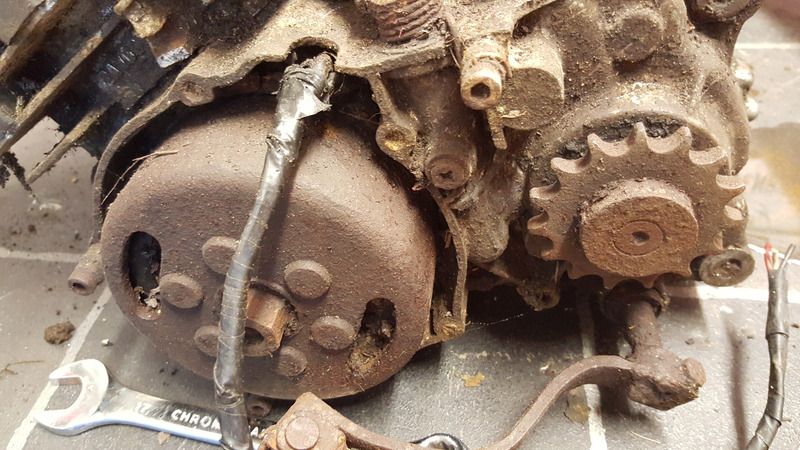

also struggling with the lock nut on the flywheel

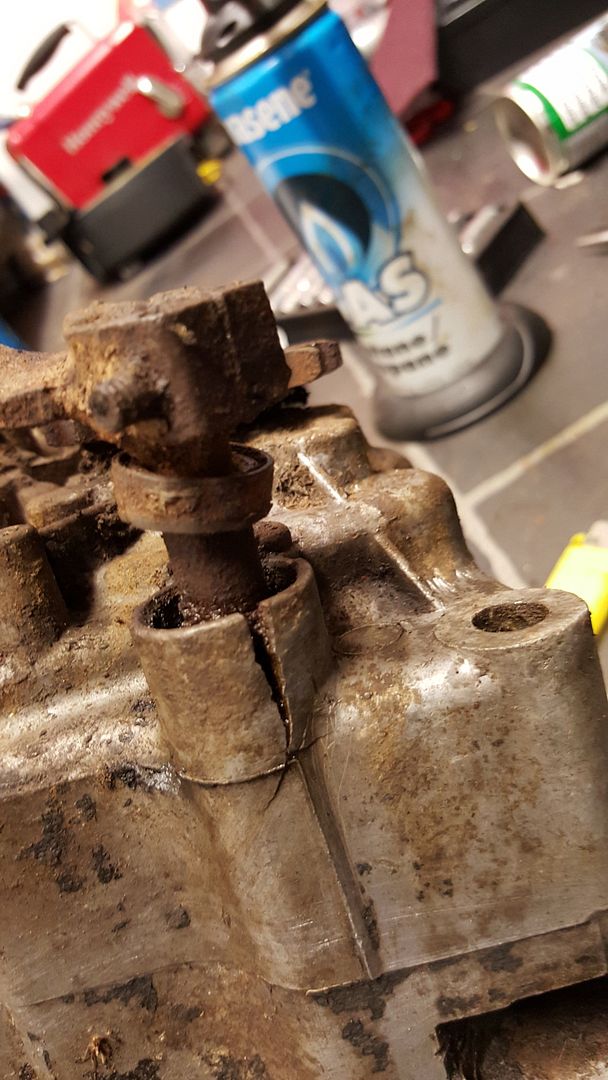

oh found a bit of damage to the case, there is a crack under the selector shaft, hoping thats not terminal......

regarding the cylinder sleeve nut
Always use a 6 point socket on these aluminium nuts, never use a 12 point one
so get the correct sized 6 point one, shove a strip of medium / coarse grit emery cloth into the socket and tap it down onto the nut...blowtorch the side of the nut to get a bit of heat into it and try again

Yeh,  my dt400. had 3 stripped cylinder sleeve nuts, .  I drilled down thru them , [ 6mm/ 8mm/10mm/ 16mm bits]  made a puller and dragged the barrel off,   Heres the puller.
Edited by blackhat250
Link to comment
bit baffled by that john, how can you drill the nuts off and leave the studs intact...?
Link to comment
dDrilled   right thu studs too,  measured the depth with Vernier,  so never touched cases,  left small stubs of studs,  mole grips- and new studs, :thumb:

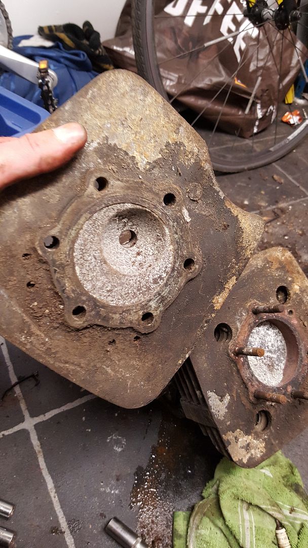

bit of an update, managed to get that pesky aluminium stud out....tried heat etc an still wouldn't budge so ended up smacking a smaller socket on an was able to get a grip on it :)
still havent managed to get the barrel off though, seems stuck solid - any ideas?

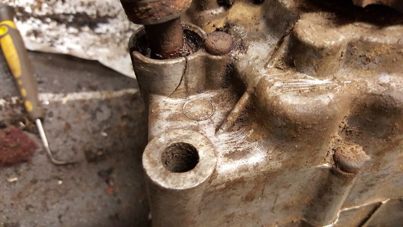

bad news though, the crack i found by the selector shaft looks quite bad.....
thoughts? is it game over?
the engine/ frame are matching numbers so would ideally like to try an keep them together
Link to comment

Pssst, I think the engine number is on the OTHER sidecase.
Just change this one, at a guess I would say that damage is from ice.
  • Like 1

Mine had landed on a rock and cracked case. Shaft was bent too and difficult to get out. Found good shaft and case in USA and kept matching numbers.
Link to comment
I used stuff called " Multi Poxy Aluminium " , a type of two pack epoxy resin containing aluminium particles , to fix a hole in a KLR 250 crankcase . Worked a treat .  A more modern front end with a disc brake would be an easy upgrade if you decide to go ahead with it .  I  hope you do, my first bike was a DT and they're a great little bike .  I'd say most of the essential parts are still available .

Bloody ell " that's the worst  av seen ,,:icon_eek:,
To remove the barrel , make a puller like my pic.   I used the centre"s of old 3 leg pullers, welded to a bar,. ,
IF YOU BELT IT WITH A HAMMER ,  =  broken fins,
