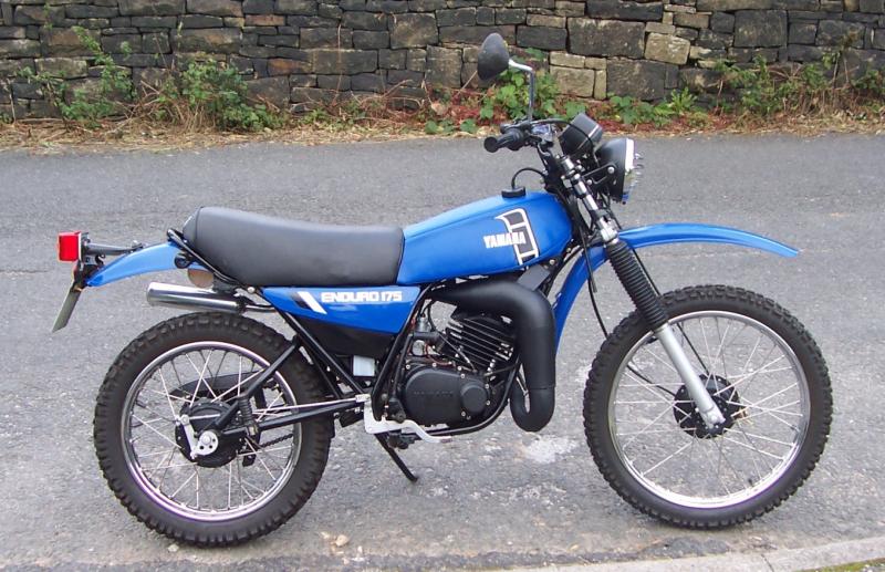

Nice one Jason, Good to see a proper pic of the DT, is it road legal now then?
From the album: My DT's and my Bandit
I've got two DT's mate, dunno owt about XV's though,
