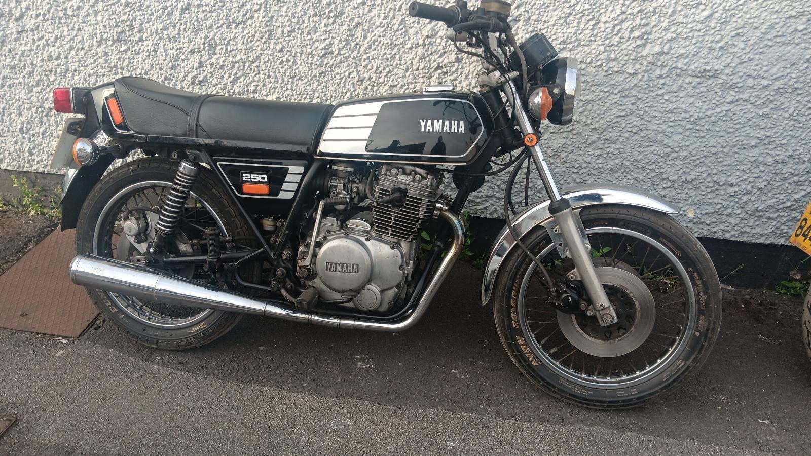

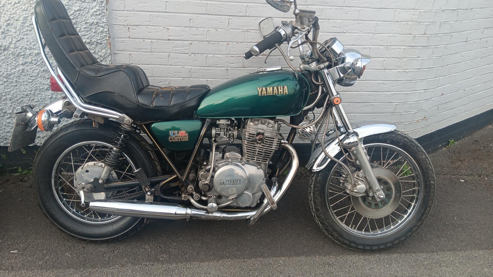

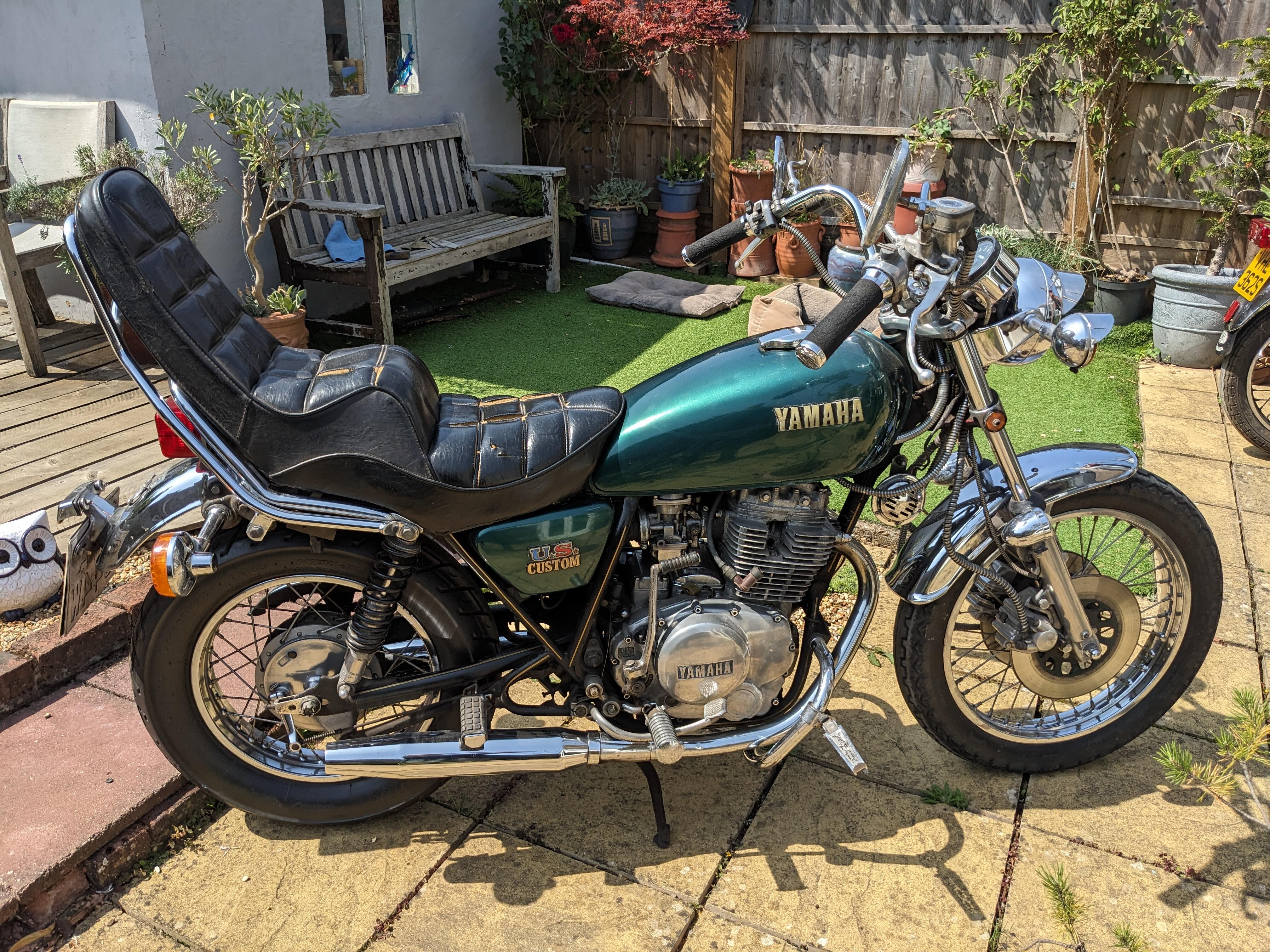

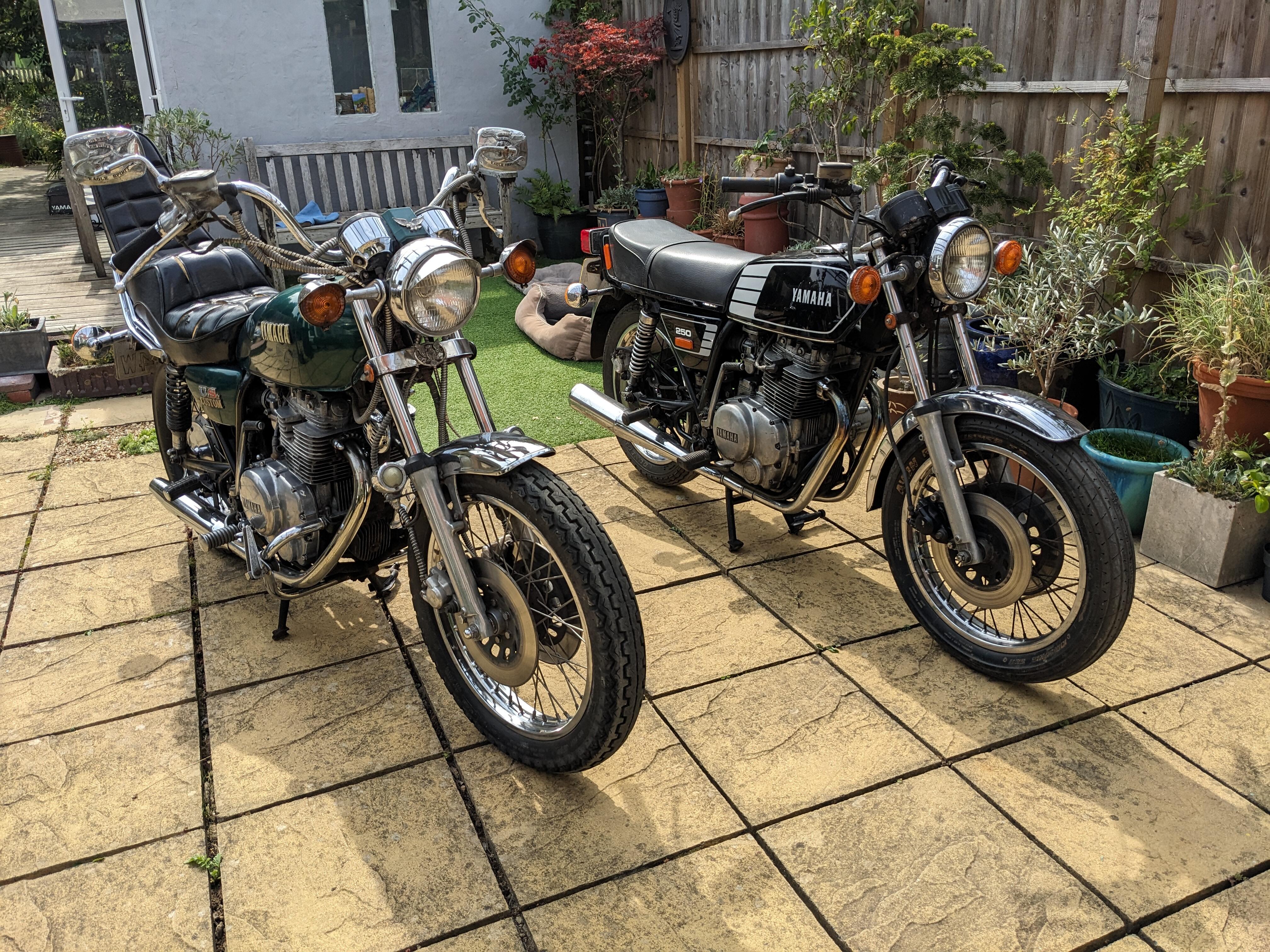

    I got this little heap and since I have the US custom as a stock bike, this one is getting altered a touch. Stripped it all down and just playing with ideas at the moment.

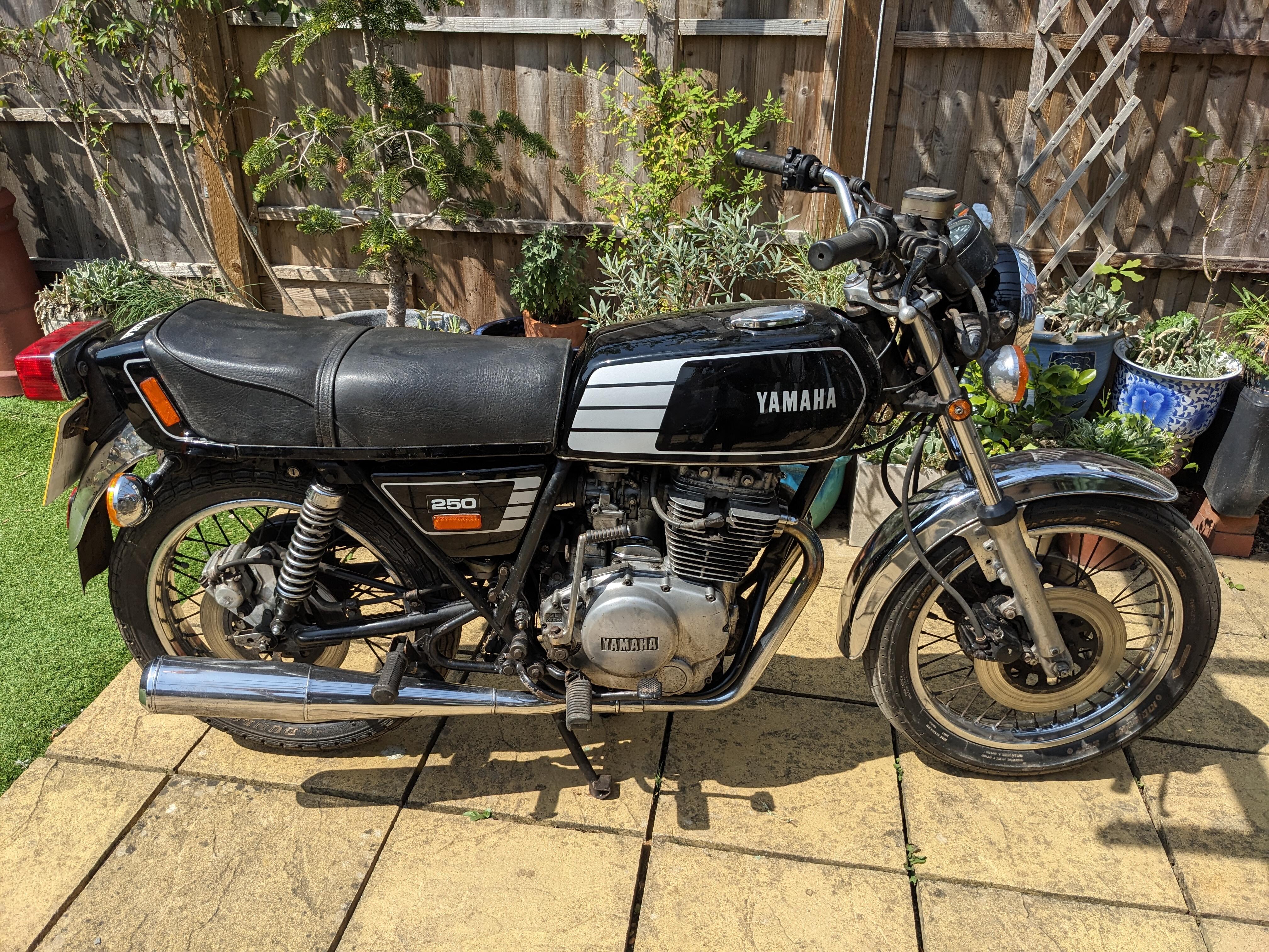

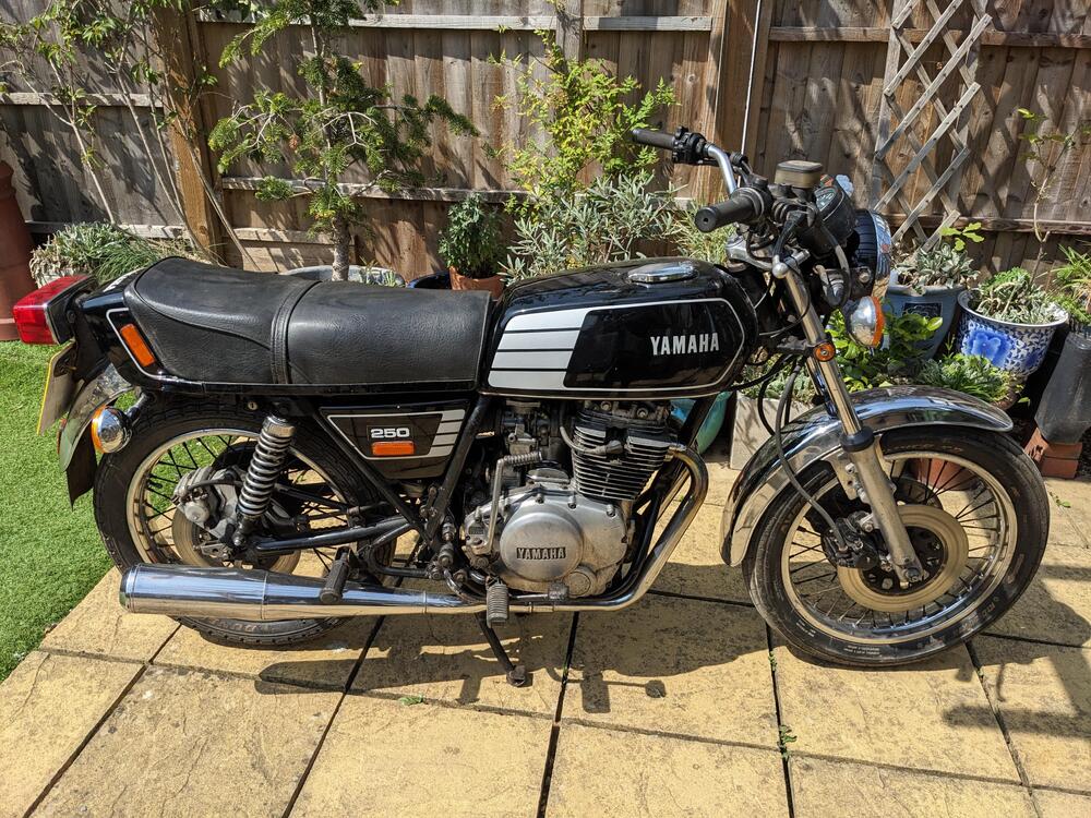

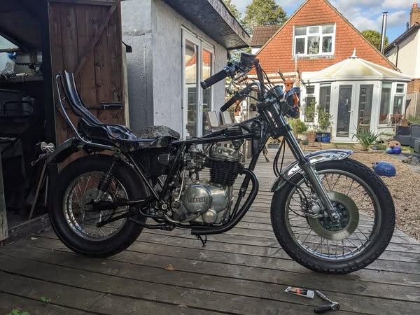

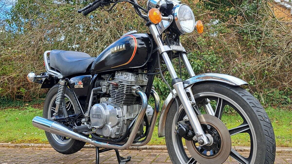

  4. This is what it would have looked like originaly. So the seat,sissy bar, front mudguard and exhausts have been changed.

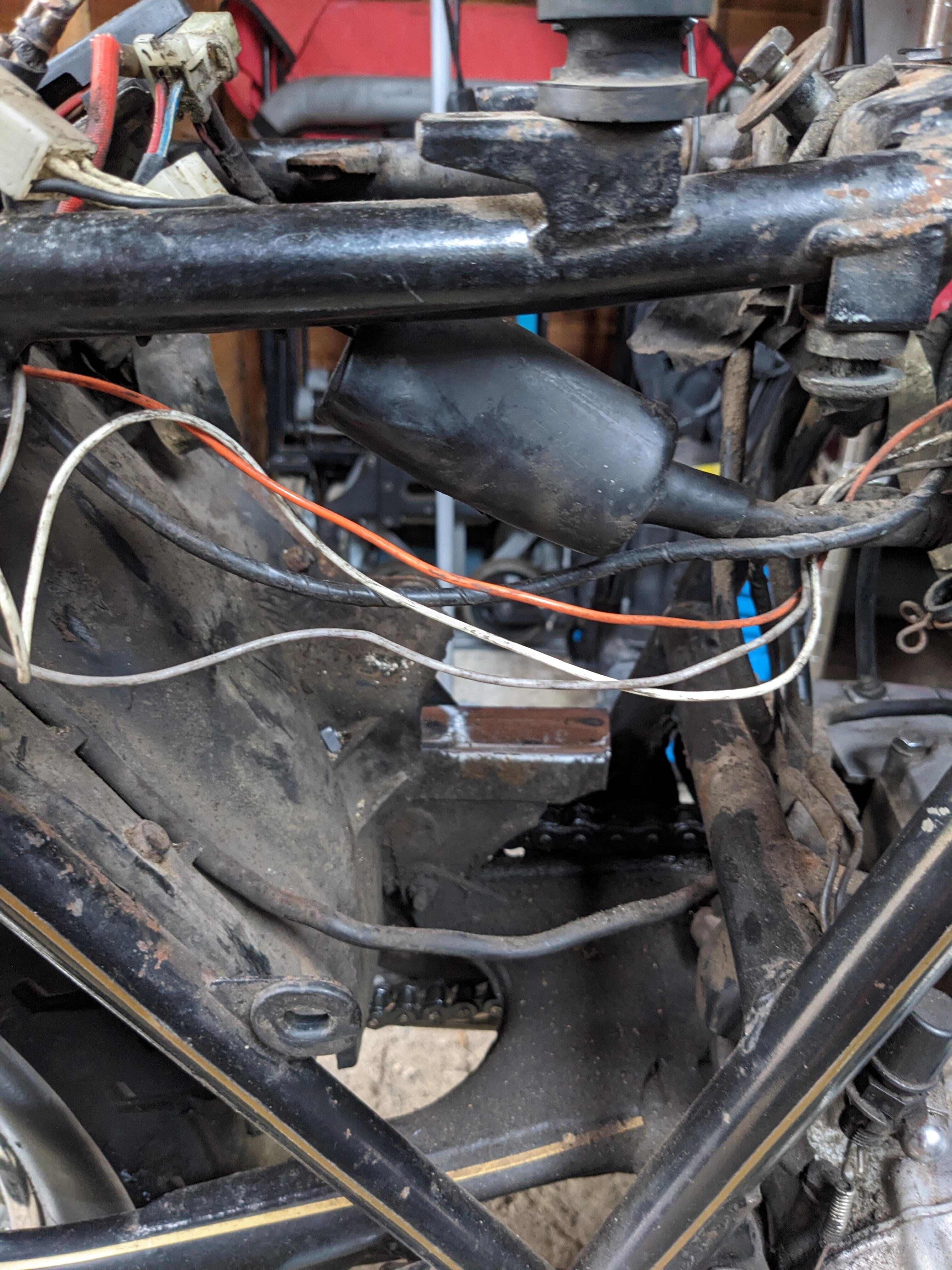

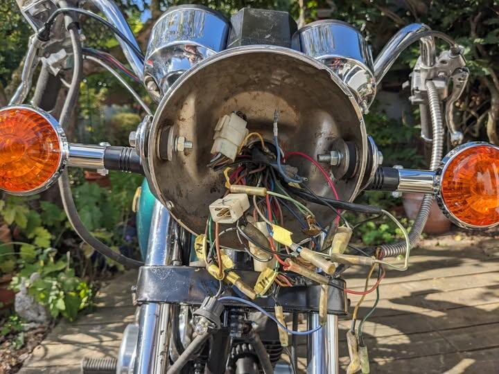

  6. Why is there soooo much wire to squese into the headlamp shell...sheeesh.
  7. Sorted. I had the wiring right, but one bullet conector was not home tight. Re did the join and she fired second kick, BRAAAAAAM!!!!!. bit loud with no silencers...sorry neibhours. ;)

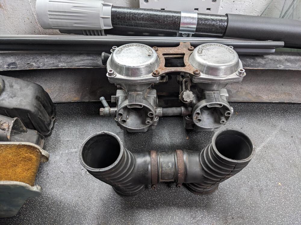

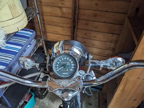

  9. My bigger pictures are too big to upload on here. Anyway. Getting on with the wiring and refurb of the instrument binacle. Air filters fitted and the side panels plopped on...for now. Tank temp fitted, waiting for new silencers and chain and sprockets at the moment.

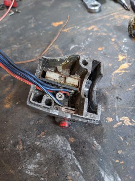

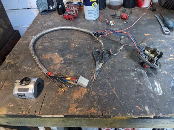

  12. Replaced the front indicators this morning and sorted the speedo. Now tackling the switch gear, kill button was not working and the starter button was missing. Lucky I have loads of spares that came with the bikes. Waiting for front caliper seal kits x two, then I can get the front brakes working. Tony.

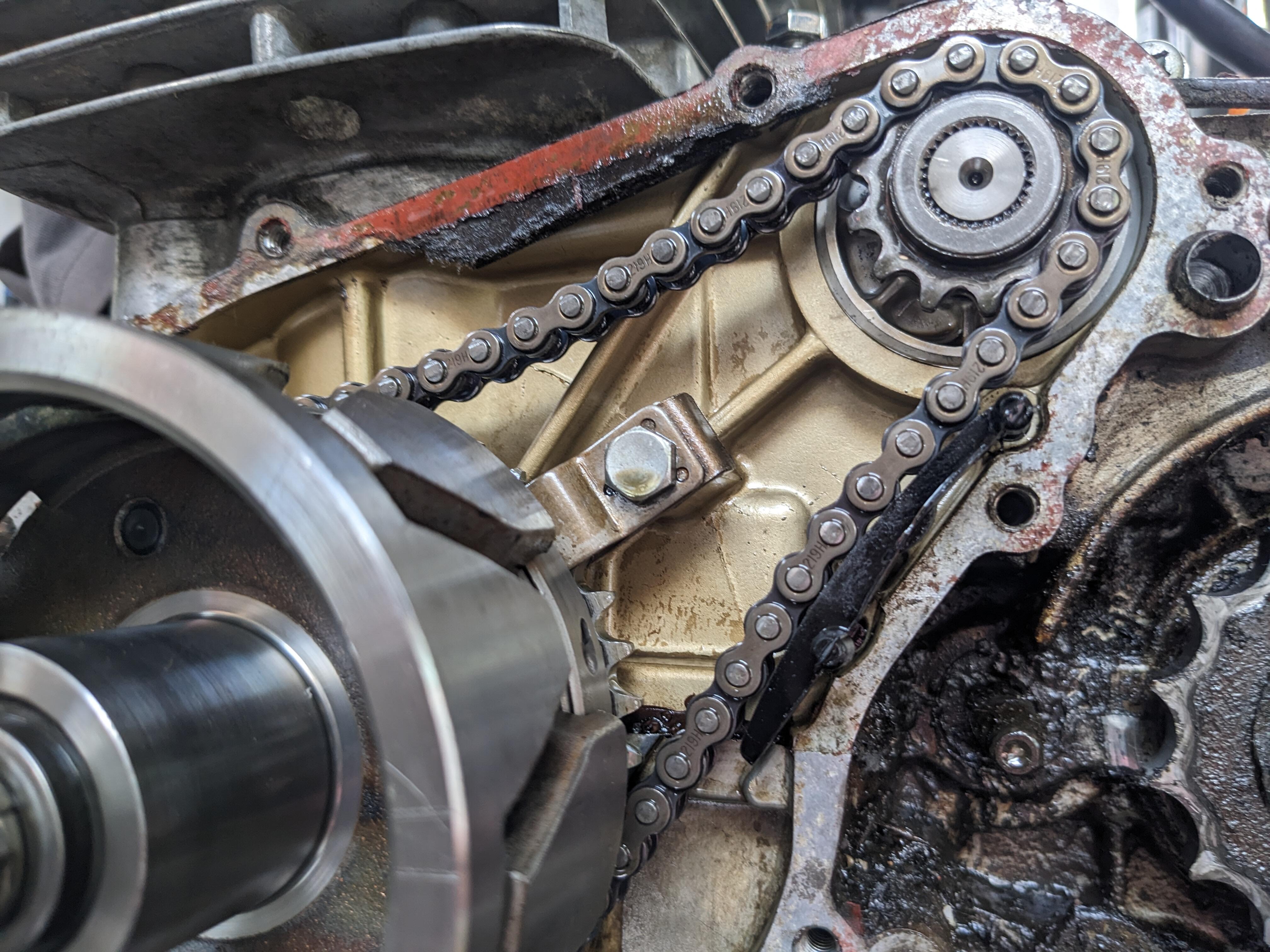

  14. Morning. The starter motor was not engaging properly so I have taken the alternator cover off for a look see. There apears to me mucho slack in the starter chain, is this normal? I have about 15mm of slack? :( Or shall I just do away with the electric starter altogether.

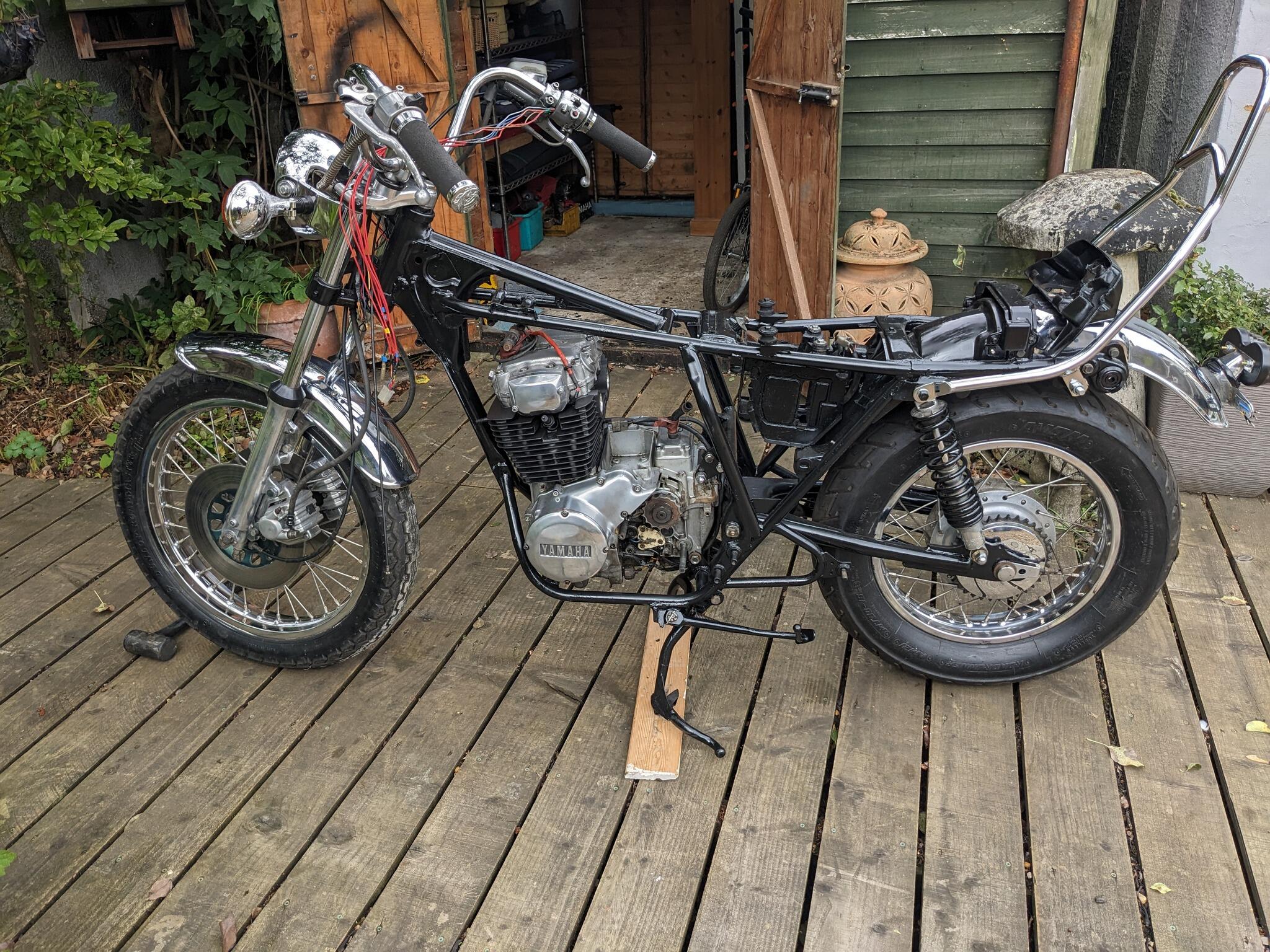

  15. Wheels cleaned and fitted. Center stand does not seem big enough to hold the bike properly, will fudge it for now with a bit of wood. I expect once the bike is done I will just stick with the side stand and take it off.
