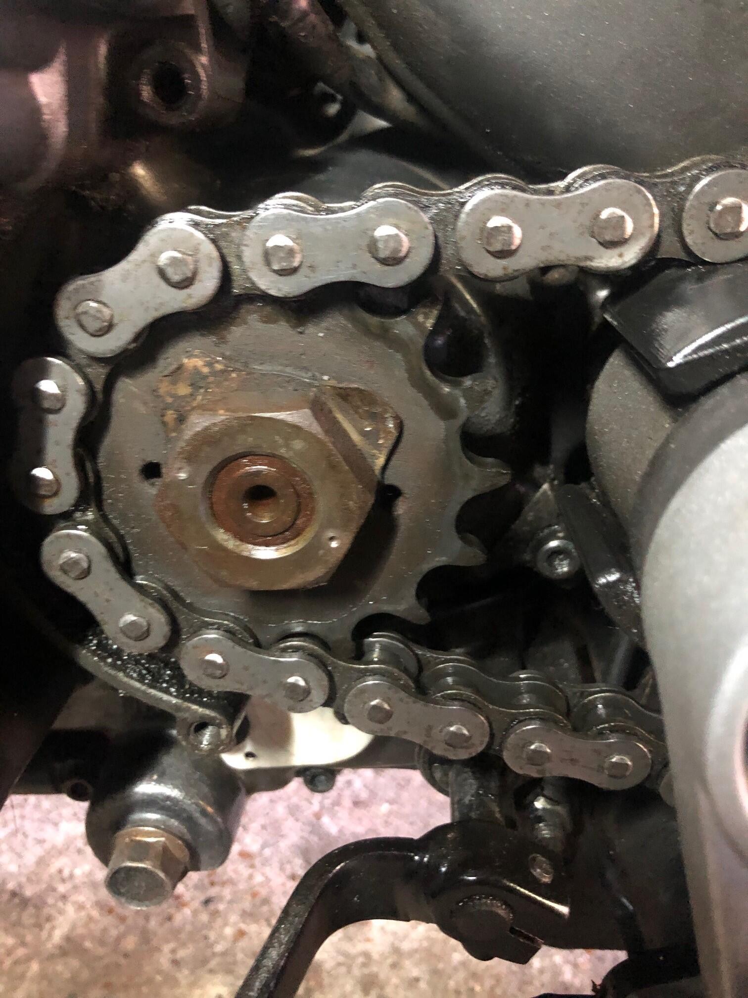

  3. Hello Thanks for your reply. Picture attached. No protruding thread but looking at You Tube videos for other bikes (inc. XT660) they are all right-hand threads, so suspect mine is too, I think now that its just very tight. Asking around a friend has said he had similar when a bike shop fitted his sprocket with a pneumatic impact gun - suggests over-torqueing which is a worry. I didn't own the bike when my sprocket was fitted so can't be sure. May have to talk to my friendly MOT garage and see if they can get it off. It's that or drill the nut and split it 😬
