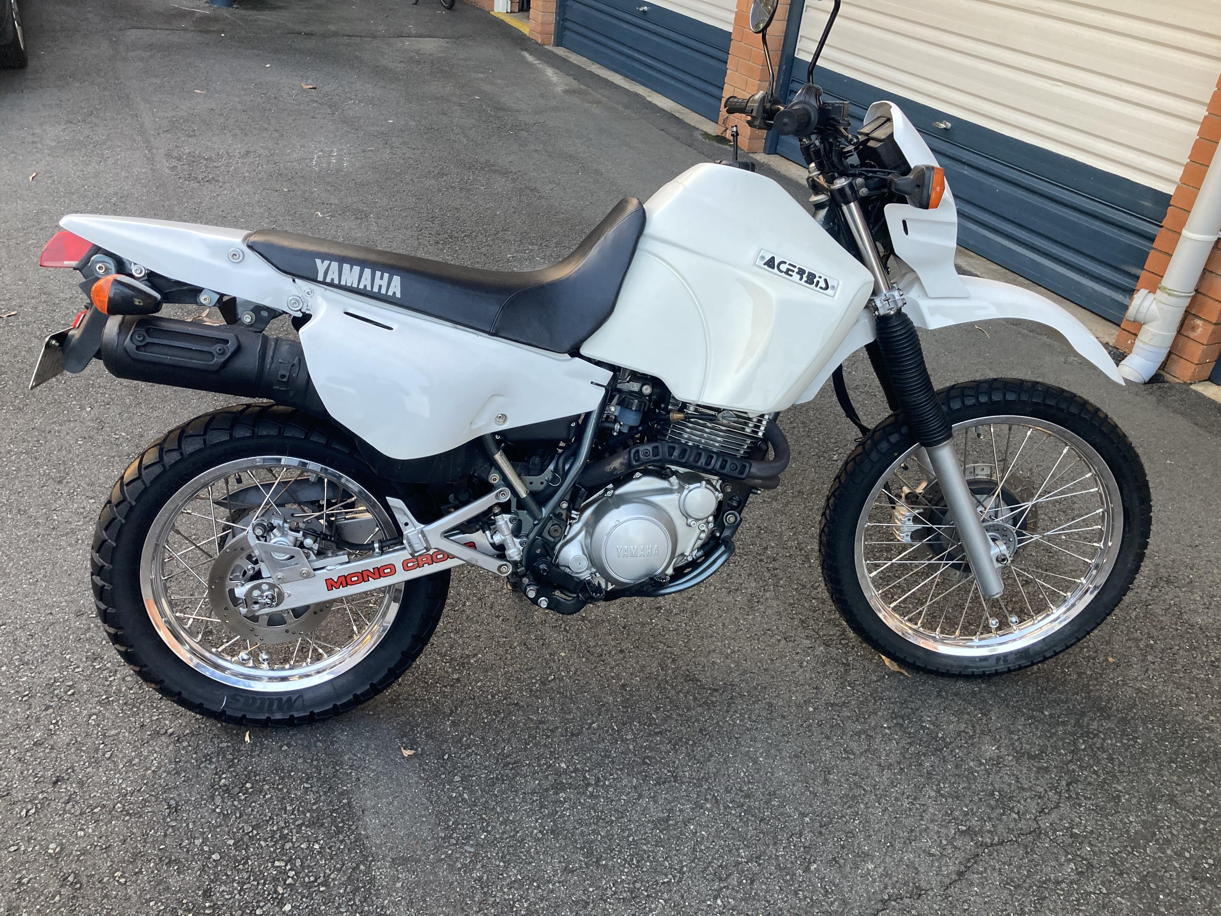

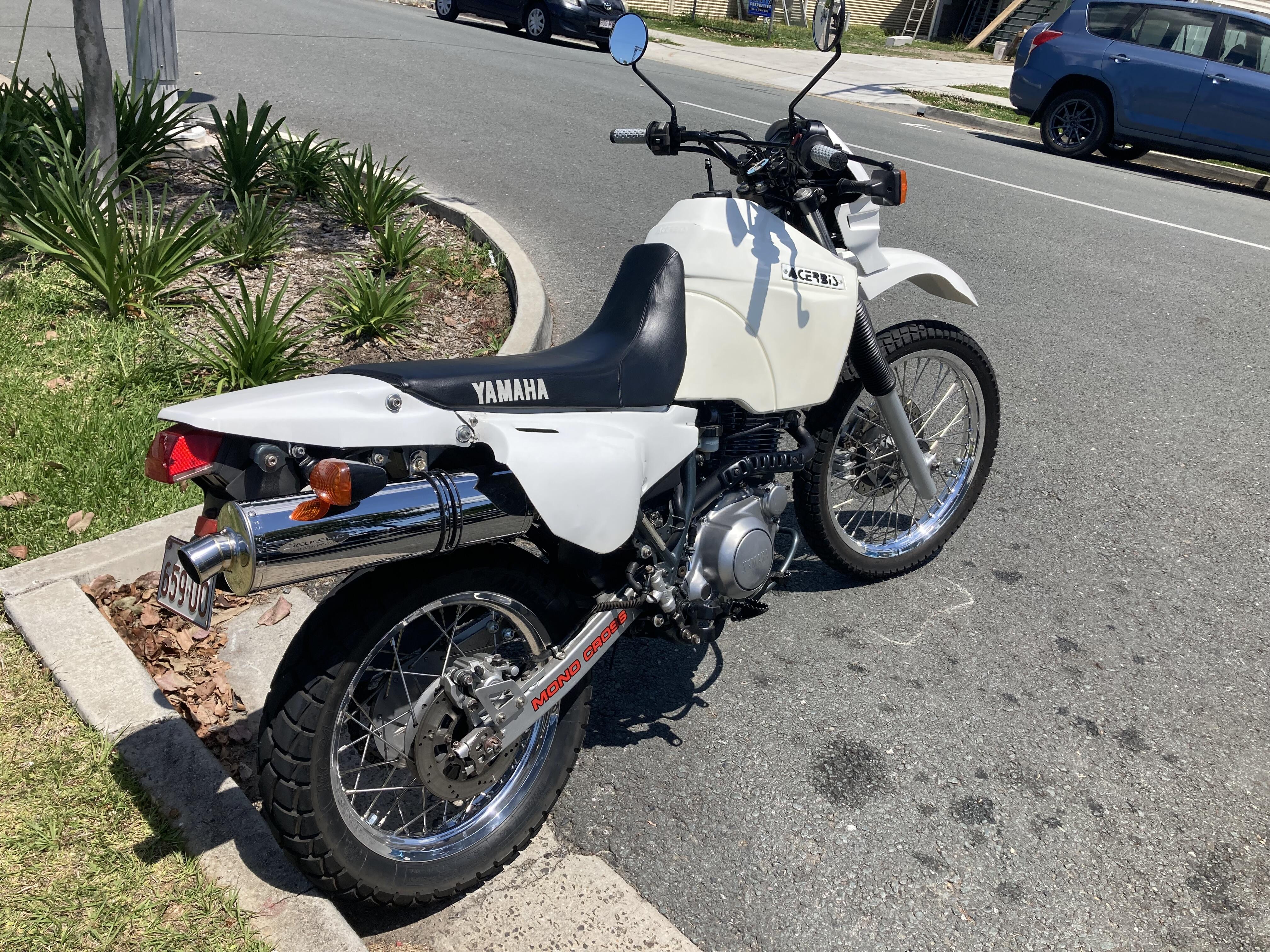

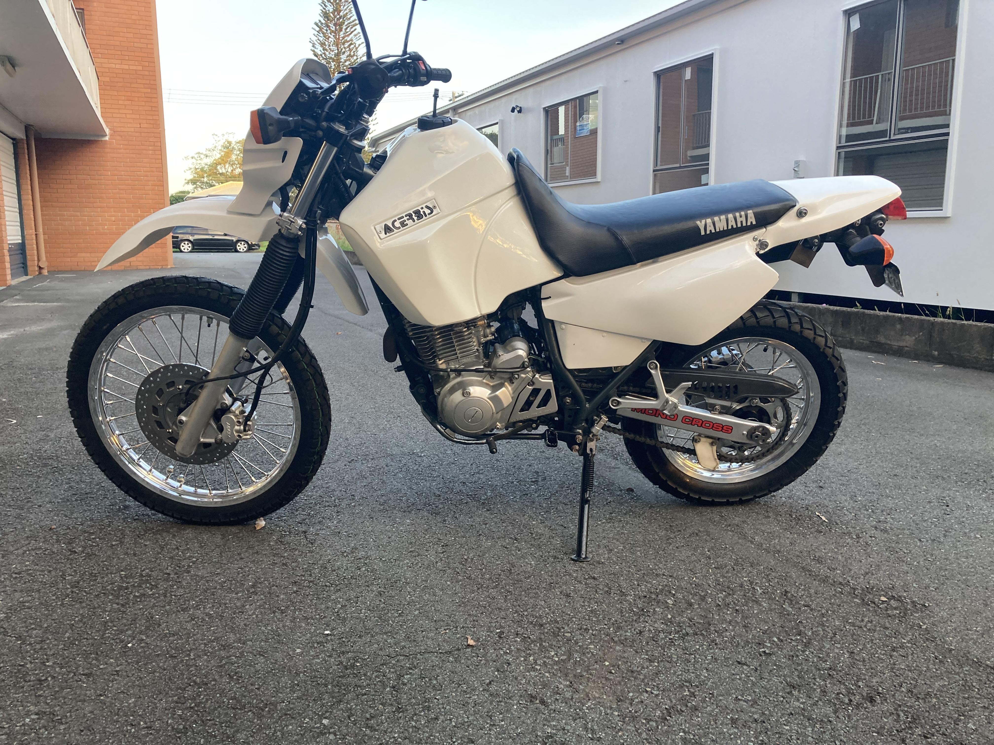

  2. Hey again, just following up as mentioned, bike is now back together and the first run has been had with no issues 😀, ended up having to go with a straight through muffler so it could breathe (and sounds great). Looking forward to many more miles, I must say the power increase is amazing and would highly recommend doing if you have the bike and the time. Some pics....cheers Baz.

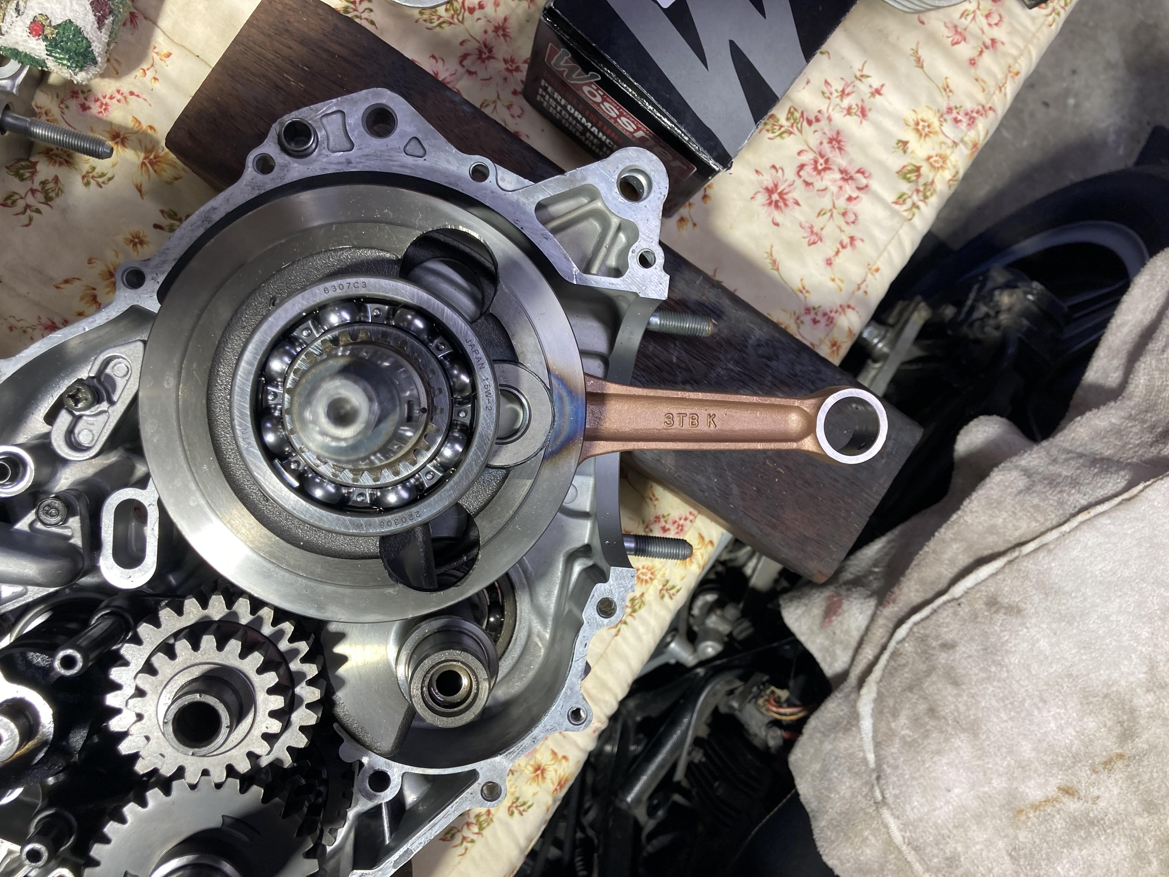

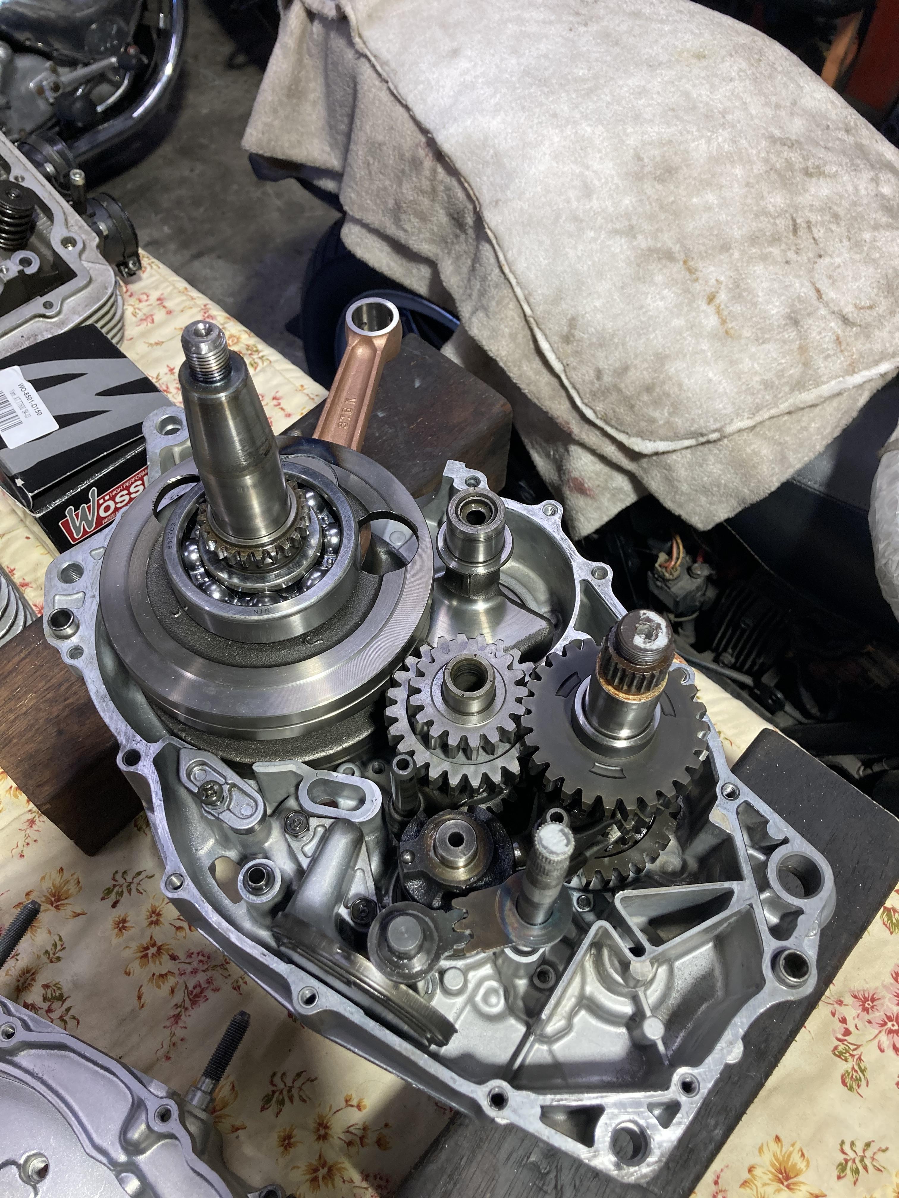

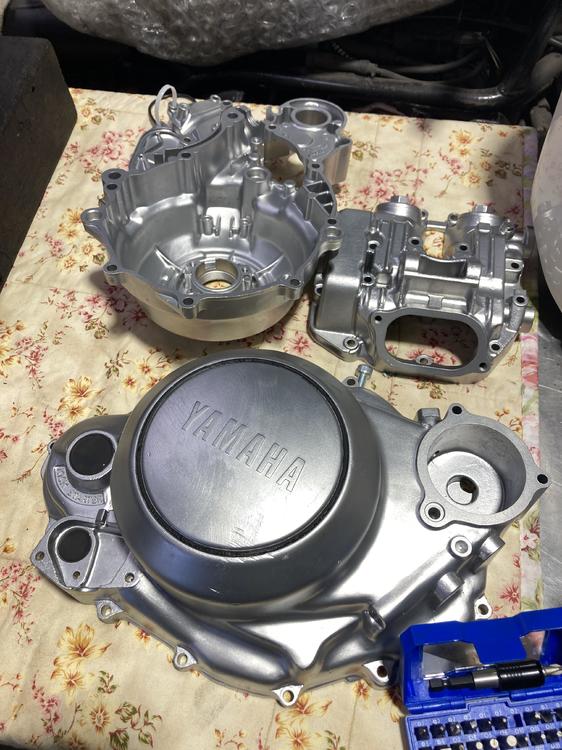

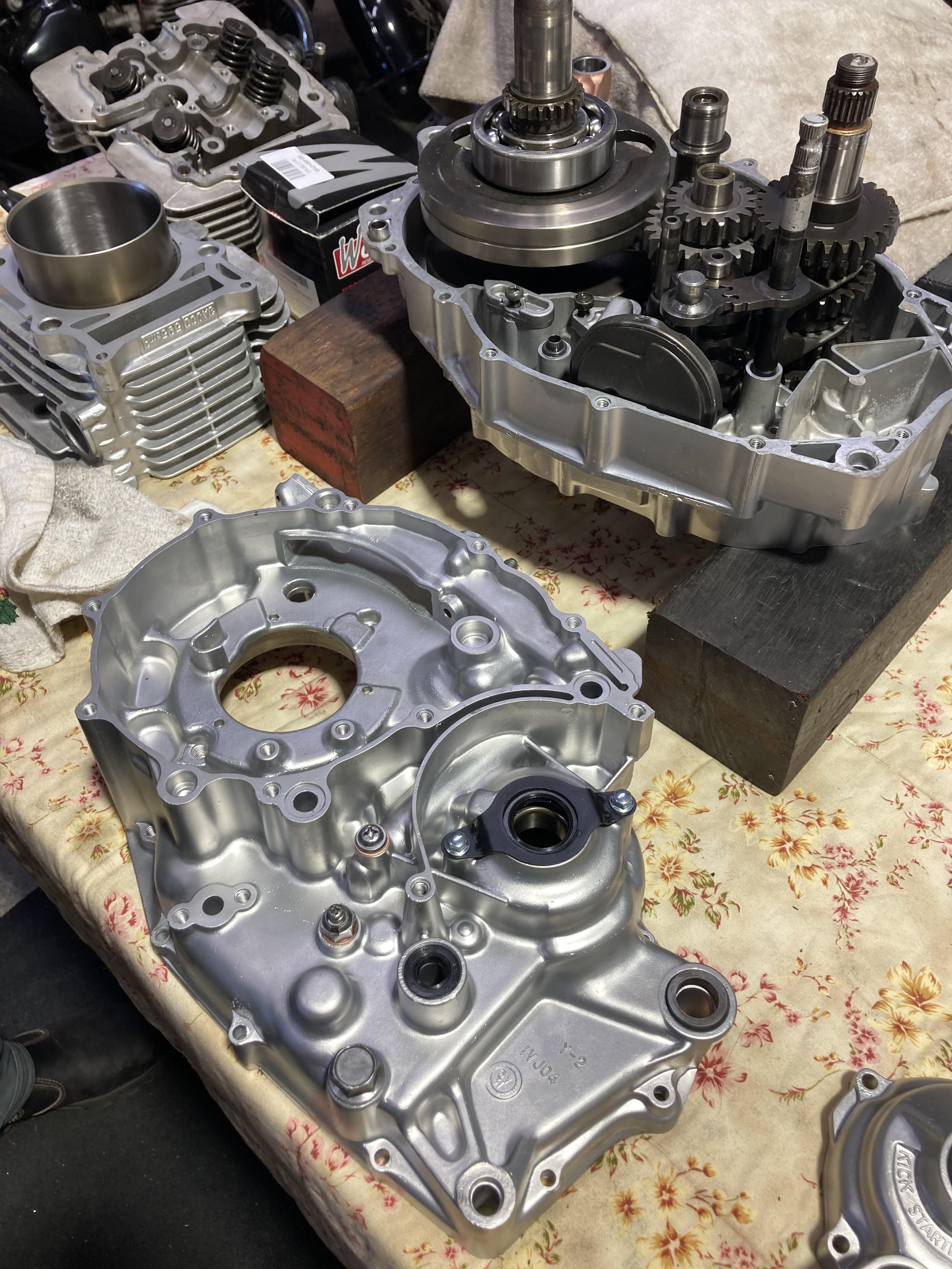

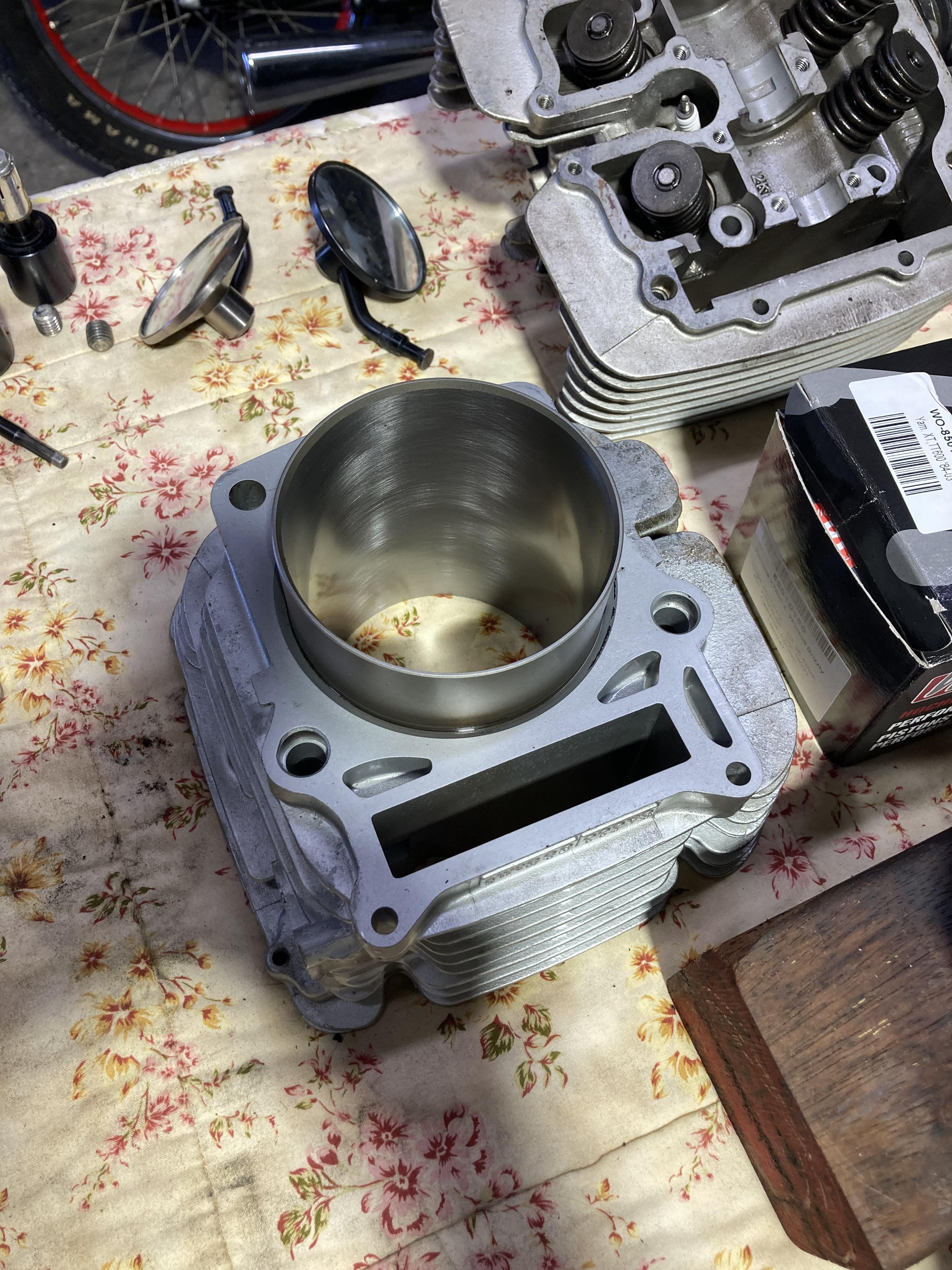

  4. Thanks Drewpy, coming back together slowly 👍
