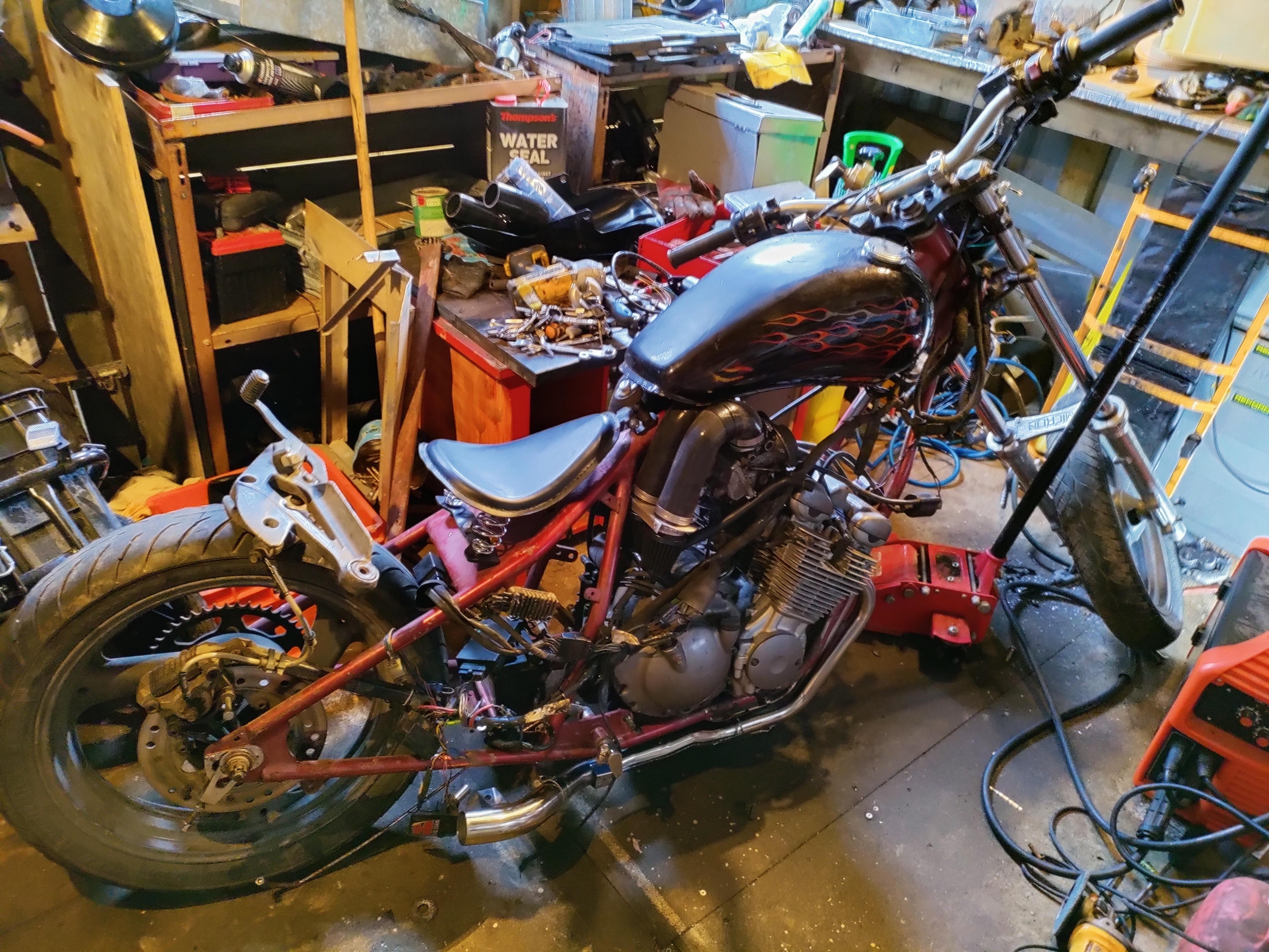

    Hi I'm looking for some help ! i have just bought a project , its a hard tail chop with a 1995 Xj 600 engine sat in it with the loom and that's it . I'Ve got it running and have got a set of 4 into 1 pipes on it now , it starts quite well on choke and will tick mover quite nicely but when you open the throttle it dies /cuts out if you gently open the throttle it will rev sort of but not a clean constant rev ! there are pipes on the carbs which aren't connected to anything I'm guessing these went to the air box ( i don't have the room for that ) nor have i a fuel pump ,im hoping gravity fed from the new tank will suffice any help would be most helpful as its been 30 odd years since i had a bike and im not used to all this new electrikery on them ! cheers Gareth
